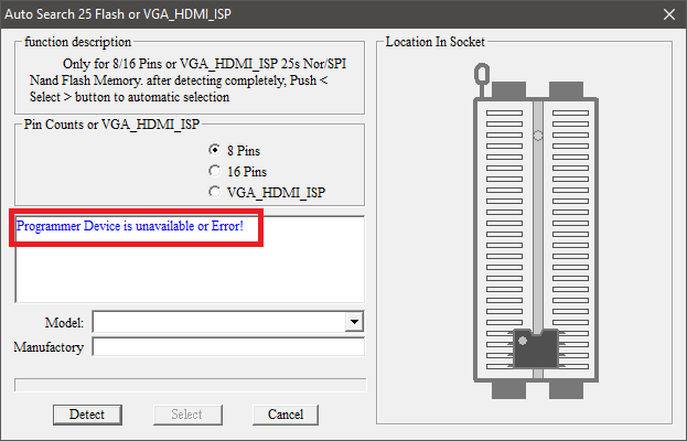

How to add XMC 25RH256CXIQ ?

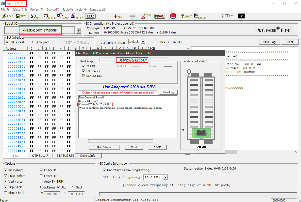

  1. APP Version : 12.45   Model : T56  MFG:2020-10-27
  2. Device : XM25RH256C* @WSON8
  3. Pins Detected Passed!
  4. Check ID Error!
  5. Checked ID is:0x 20 43 19
  6. Wish to continue programming , please cancel [Check device ID] option!
复制代码
Always use the latest update
DjamelGsm 发表于 2023-1-13 17:38
   Hello,             I see now. Some times with so many IC variants, the ID present in the software,
is only from one IC, sometime something is wrong and need to be corrected,
and to work, need removing check ID tag, at bottom of window. Can you, please try it?
For sure, time permits, Admin will help further.
Just trying to help
Rgds
i try to unchek ID . i read dump but its crupted .... there is problem . i try w25r256 work perfect
