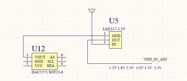

Is it possible to get the schematic from T56?
There are questions about what should be in place u5
Yes, and in principle for future repairs in case of a short circuit

U4 and U5  is a LDO on T56. MODE is AMS11117-1.2V.  Packge is SOT89.
1.U4 Normal voltage about 1.2V always.If it is broken, the programmer maybe not be connected to the computer at the same time.
2.U5 normal voltage is about 3.3V on idle state. If it is broken, self check maybe not passed. and test IO voltage is not correct.
These two components have been replaced for the newly delivered programmer.
U5 1.2v but produces 3.3
And why is adj not installed. Why is it so hard to do.
U5 exactly at 1.2V?
U5 exactly at 1.2V ...
Oleg_Skalskiy 发表于 2022-12-25 18:16
   AMS1117-1.2V LDO is also adjustable, but the minimum voltage is not less than 1.2V .
  T56  adjust the output voltage of VCCIO through DAC5571
VIOout=Vdacout+1.2V

I have two parallel resistors
22kOm + 5.6kOm = 4.464kOm
Can be replaced by another value. And tell me which one?
