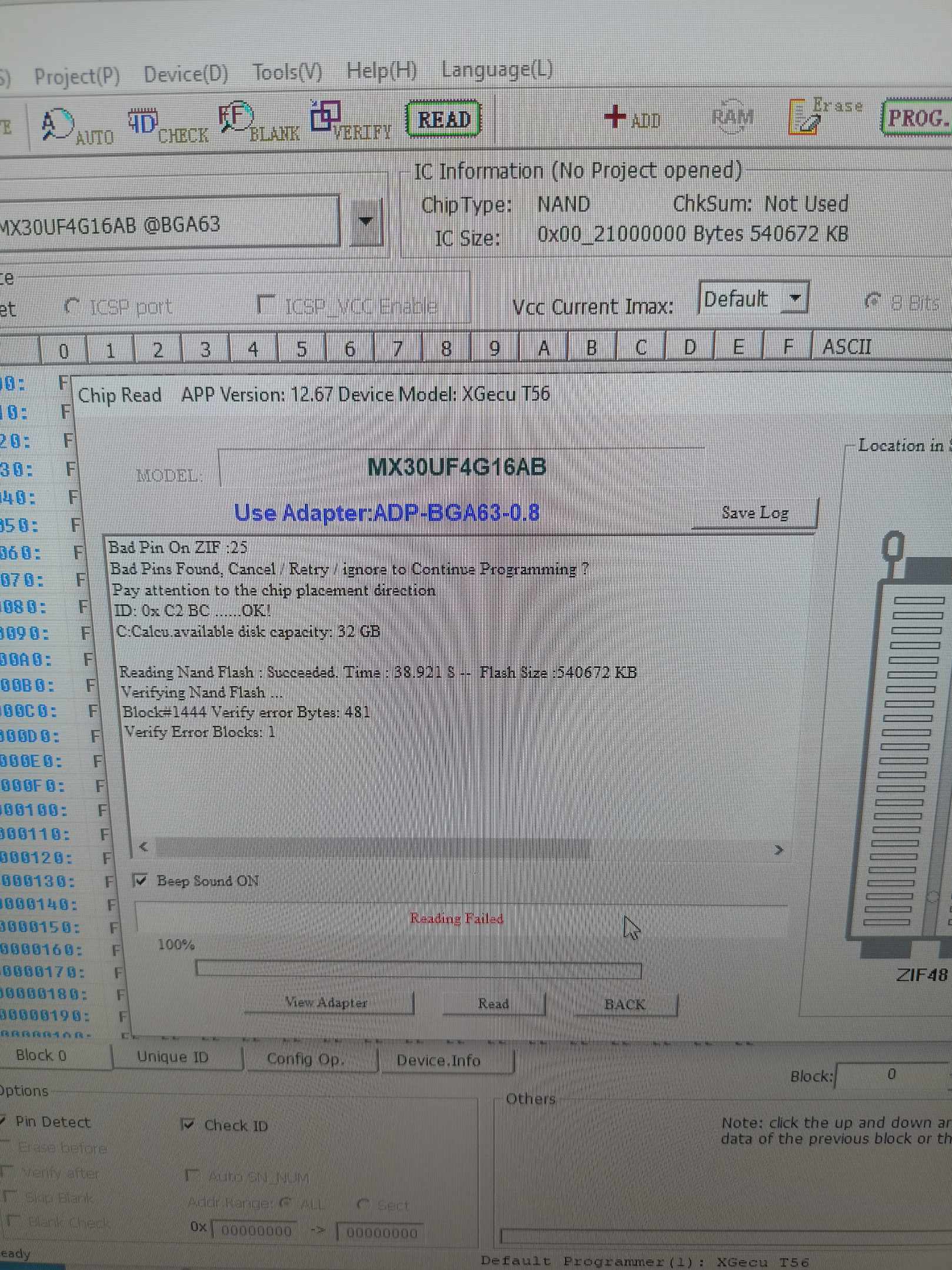

[quote]what to do? All dump FF

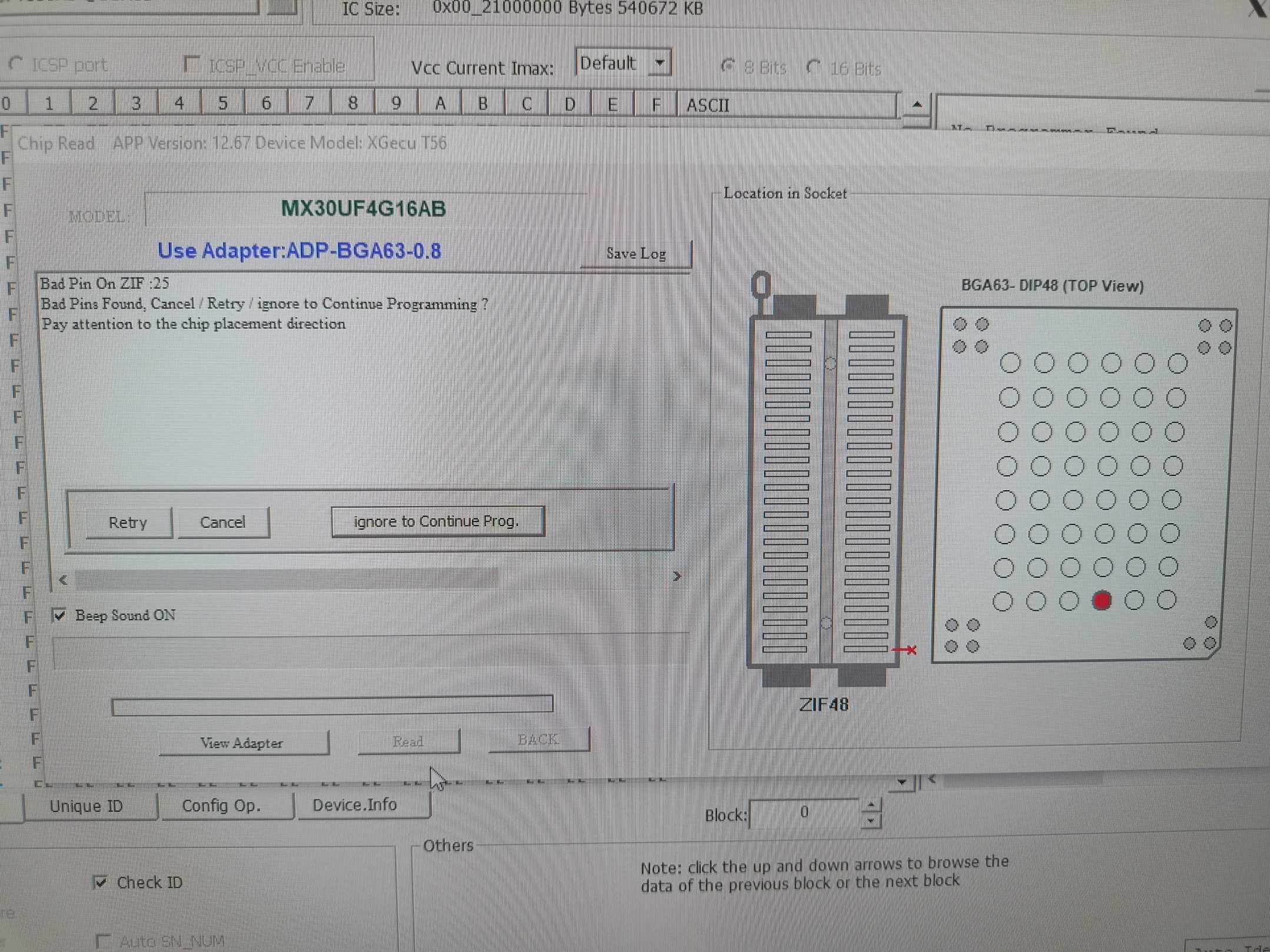

Dear Dmitry,
Try latest known software HTTPS://www.hklrf.com/Downloadfile_59.html ,
with some corrected ICs. Why? You got one error with one address lines, you should got
multiple errors....

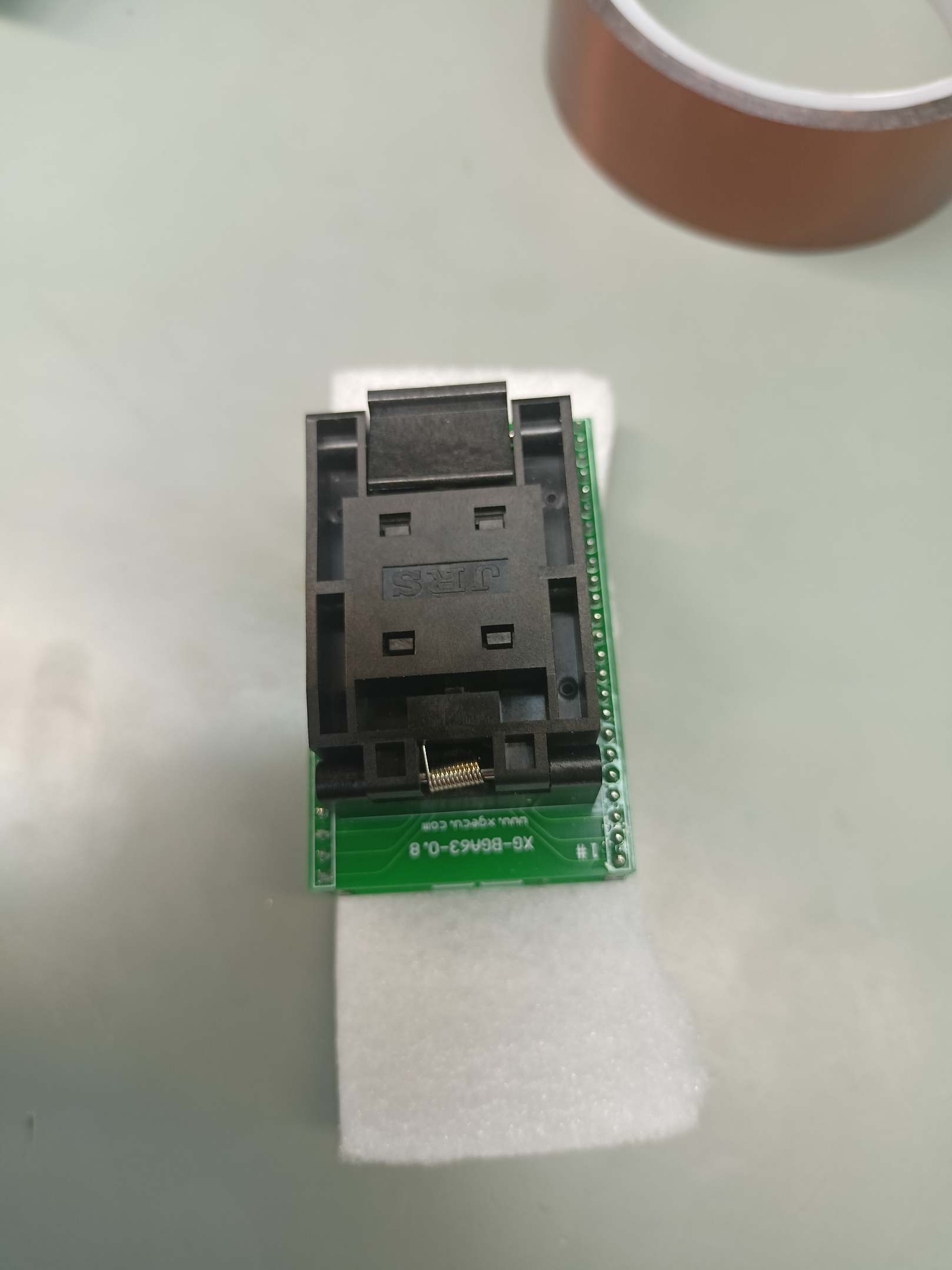

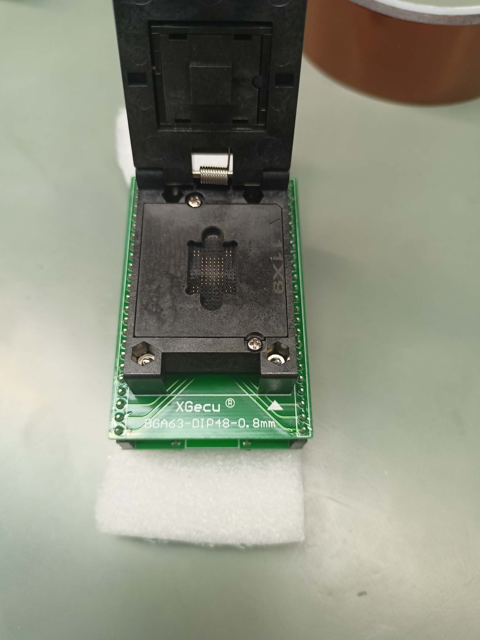

Anyway, if not help, please post your adapter, clean it ( just in case), if adapter socket is removal
capable, clean everything. No Good? Wait as T76 is almost out and a new software will appear.The IC used maybe have bad sector...
Albano hello, I use the latest version of the software, adapter, rang, all contacts are working. This contact on the chip does not ring anywhere, in my opinion this is the ground contact, I forcibly made a jumper to another ground contact, the error in determining the contacts disappeared, but nothing changed, the dump also remains empty (FF). Why there is only one error in the log I do not know, most likely the code for working with this chip is not finished. The chip is working, fully works in the device and does not fail. I do not understand why the programmer support does not respond to problems. I have another programmer, not xgcue, it reads this chip, but with errors, tech support advised me to read the documentation and play with delays.
