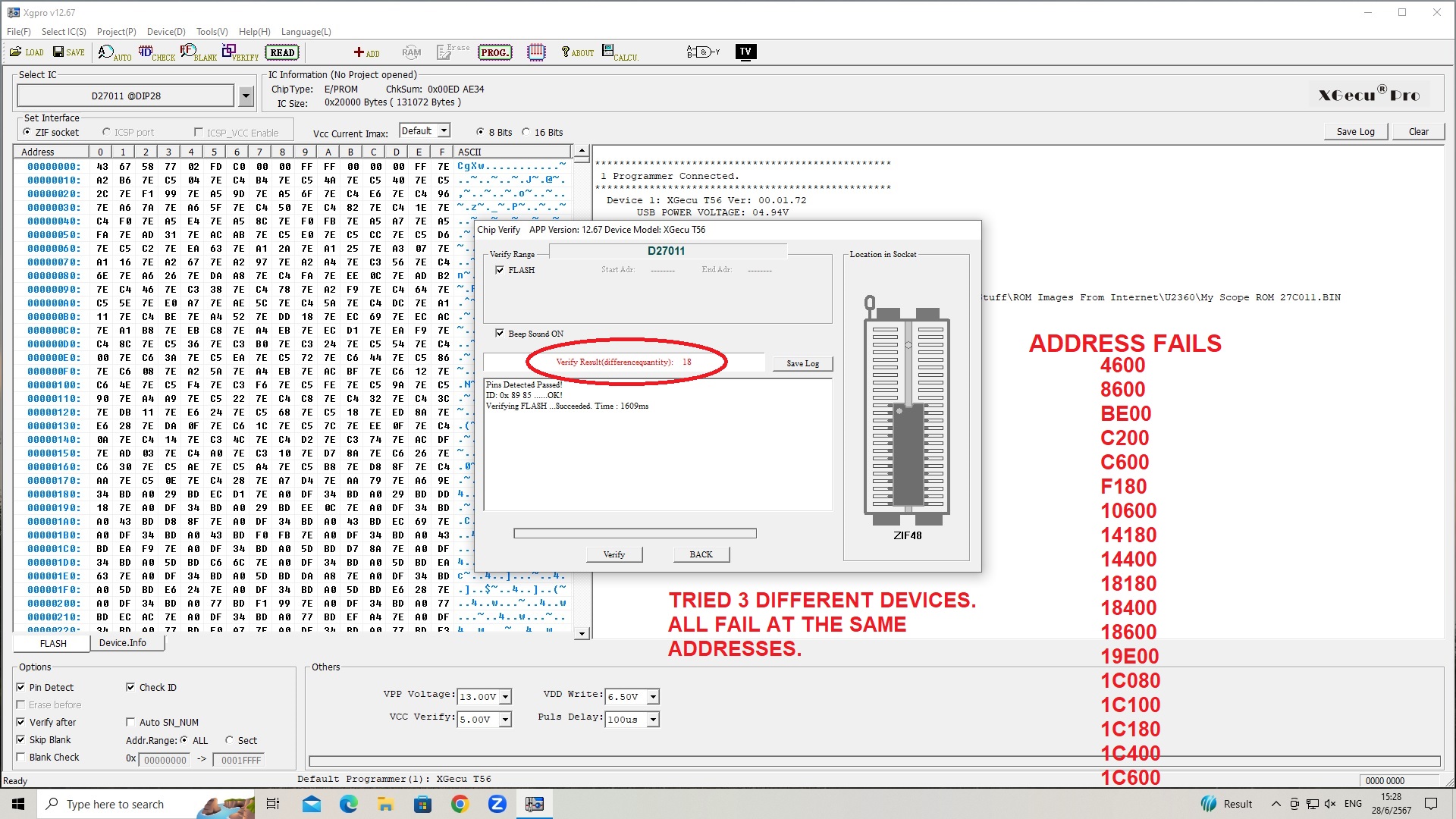

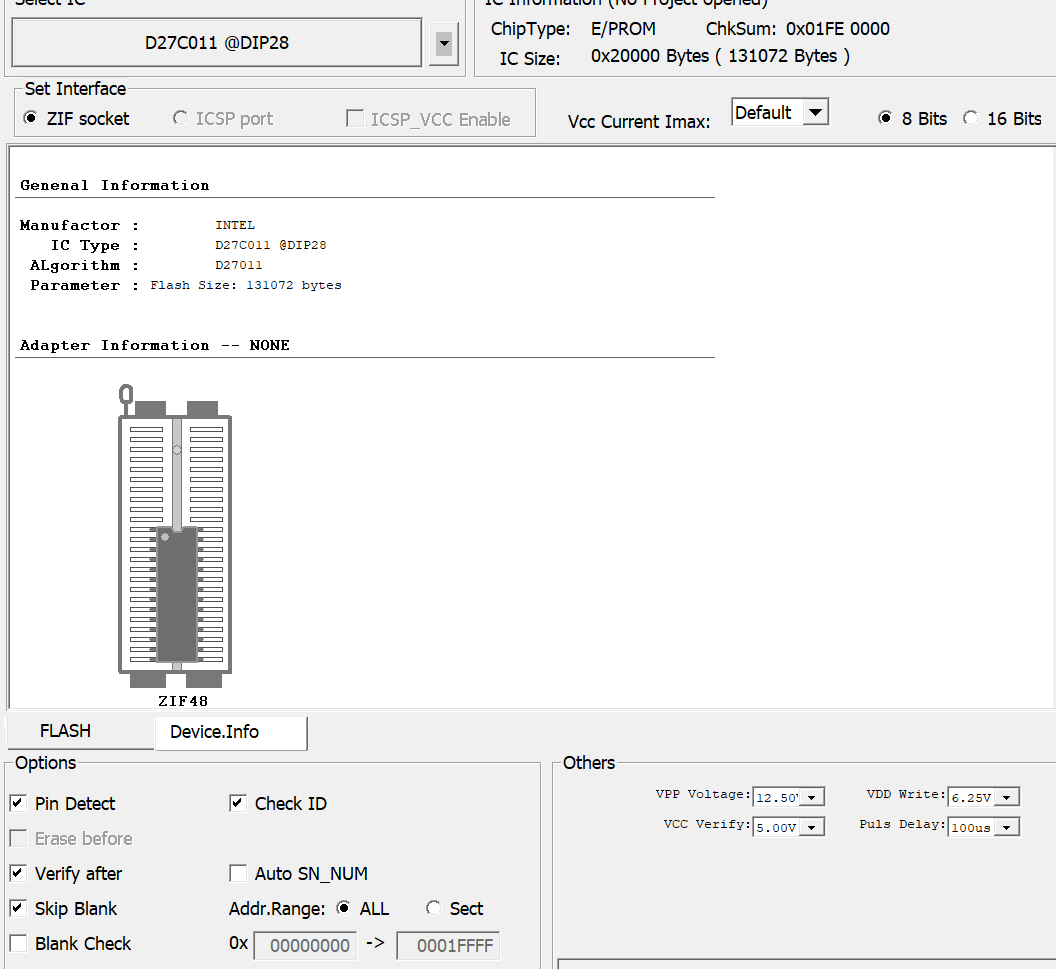

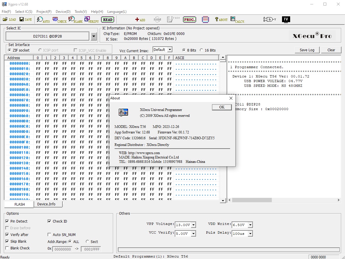

Hello Sir,I cannot program the Eprom completely as there are errors in some pages.
Page 0 is ok but ...
lungchard 发表于 2024-5-15 17:31
Hello Richard, Unfortunatly some app software versions ago, many ICs lost writing capabilities,
Do not know if 27011 was affected. You can see it by reports , at least from T48 and T56 Users.
As I've noticed, the problem appear not to be the firmware updates, as users reported going back
some versions back with the software, solve the writing issues on already present ICs in the database.
Unfortunatly, with time passing, many months so far, even the old software versions did not work at
all due to a 'time bomb' included with the software, then date of computer must have rolled back to
get it to work with old versions, even with new software, and disconnected from network.
I also cannot ensure you anything, because i do not have a sample from 27011 myself to test, yet.
In one of the latest presences of Admin here, he said, that they are waiting for ICs to test....
Maybe they are preparing a complete new software ?
I can see they still somehow active, from hardware page at Ali Express Oficial page XGECU Official Store - Amazing products with exclusive discounts on AliExpress
as new and cheap adapters appear recently, but thats all.
I've tested many old ICs so far with 12.66, all worked writing except 27Cxxx without glass window
already programed ( OTPs units) , and this behaviour is expected and correct.
I can only hope your sucess with older version software, a new version of software with this error
corrected ( in the case it never worked), and of course, good ICs with You :-) |
