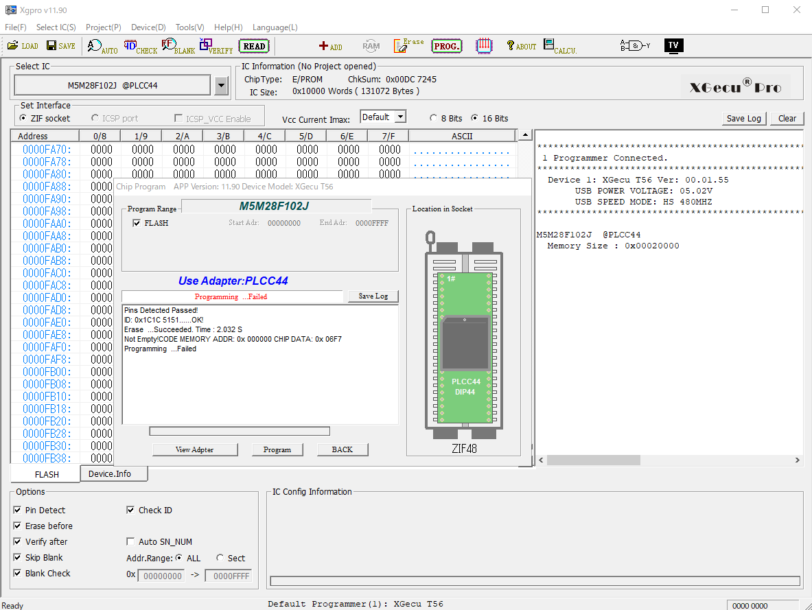

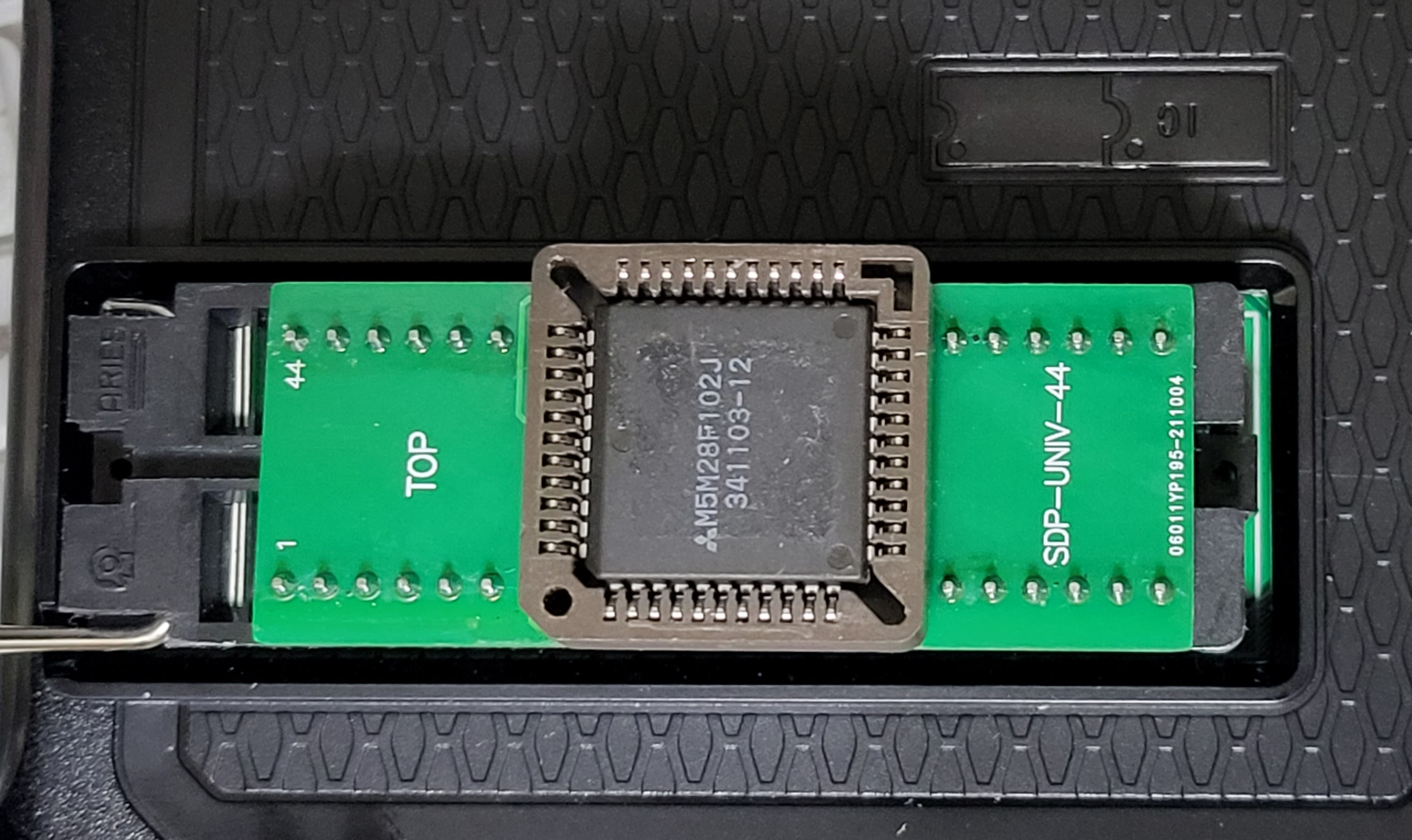

T56 - M5M28F102J erase & program failed
T56 can't ERASE and PROGRAM for MITSUBISHI M5M28F102J .
wrong command data(D0-D15)?
VCC: 5V OUT OK
VPP: 12V OUT OK
Read: Successed
Erase: Failed (data remains)
Program: Failed

Hmm... Access may be too fast.
If you program it many times, it will gradually change to the correct value.
(ex: Write AA55, FFFF -> FEFF -> BEF7 -> AED7 -> AAD5 -> AA55)
I want an option to slow down access.

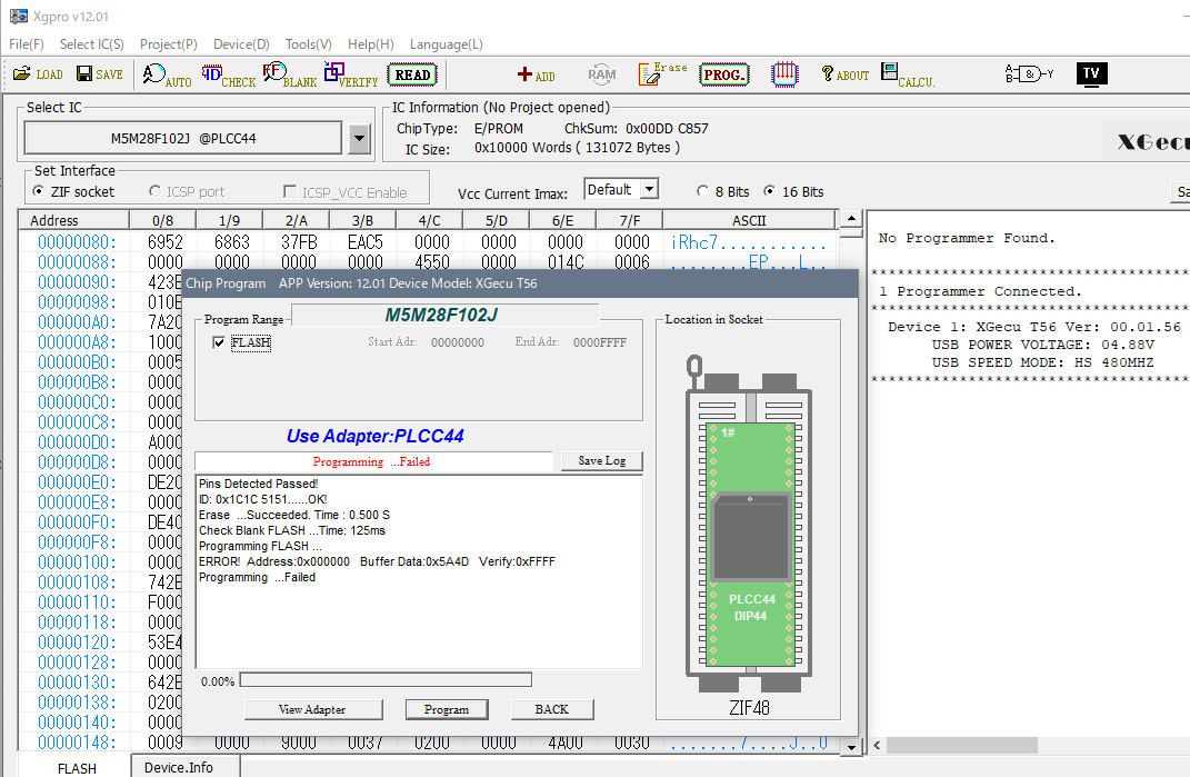

Found :  after erasing,Disable erase before programming , then repeat programming more times. it can write into the first word, but cannot write the second word.
and M5M28F102 SOP40 is Normal.  I can't find the the problem.
I tried new Xgpro v12.01.
But, My M5M28F102J failed program.
READ: Success
ERASE: Success
PROGRAM: Failed

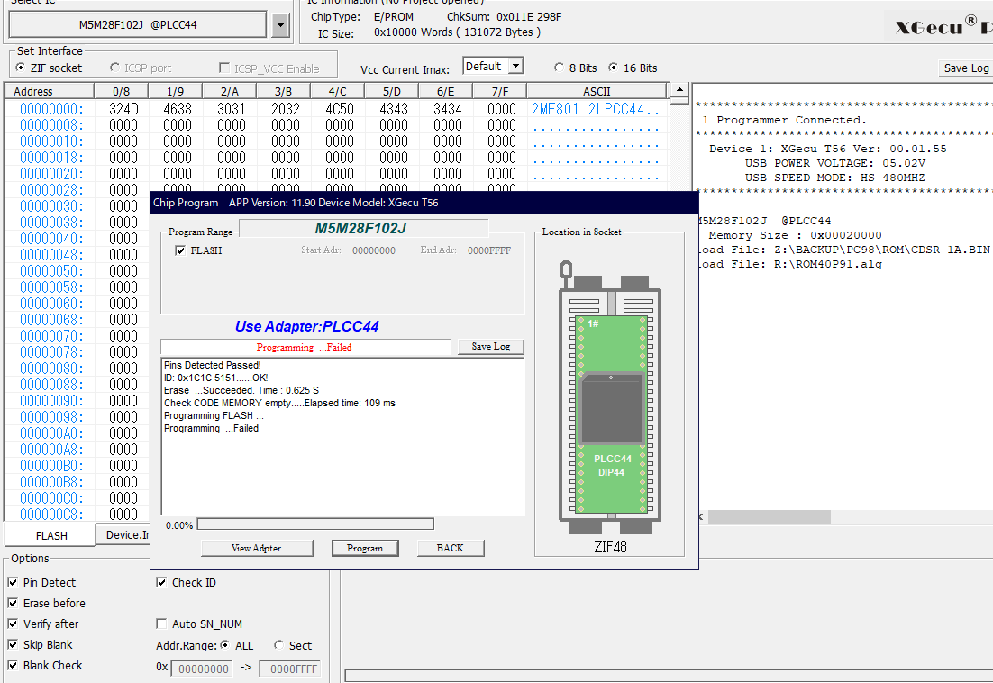

回复 9# admin

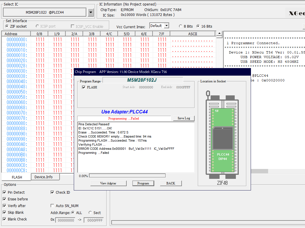

I tried new algorithm file.
READ: Success
ERASE: Success!!
PROGRAM: Failed
Erase Successed. My M5M28F102J was correctly blanked.
But, Program Failed... Only one word is written unstable.
Some modifications are needed.

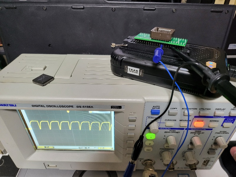

回复 7# admin
I tried using an oscilloscope.
After investigating, it was possible that I was sending the wrong command.
Erase Command required "2020H" and "A0A0H".
But, T56 Sending "0020H" and "00A0H".
It's wrong...

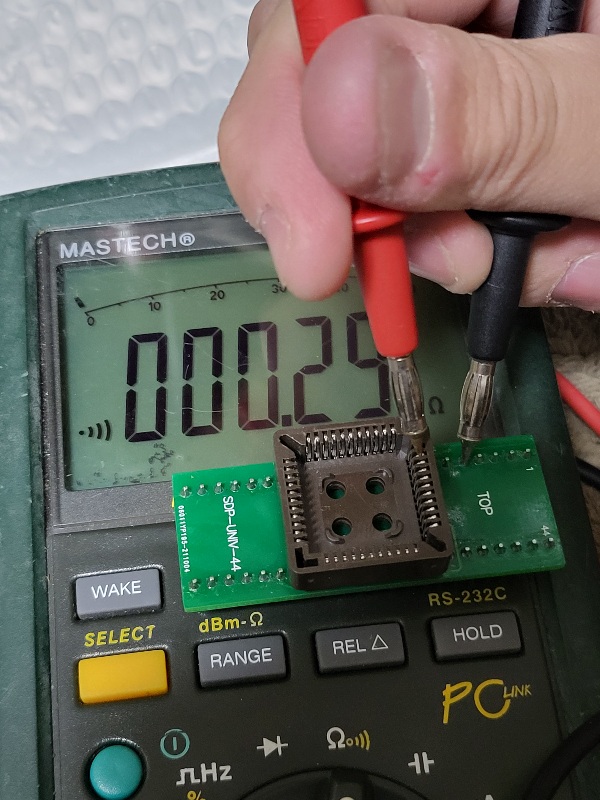

回复  Albano.Matos
I looked it up.
All pins are connected(0Ω), and not shorted near pins.

回复 4# Albano.Matos
I looked it up.
Also, It successed program for HN27C1024(PLCC44) with this adapter.
This PLCC to DIP Adapter is works.

OffGao 发表于 2022-5-3 23:08
    As an user... Just to add diagnostic info, please check ohm from every pin, to dip, and sure pin to pin with no high ohm between?
回复 2# admin
ttps://www.datasheets360.com/pdf/2009148678025692463
I'm checking the datasheet, this chip doesn't seem to suported boot lock feature.
The data read after erasing was the same as the data before erasing.
回复 1# OffGao
   If the IC is Boot Locked . the boot data canot be erased.  Check the data after the boot.  if all is  FF , the chip is boot locked.
