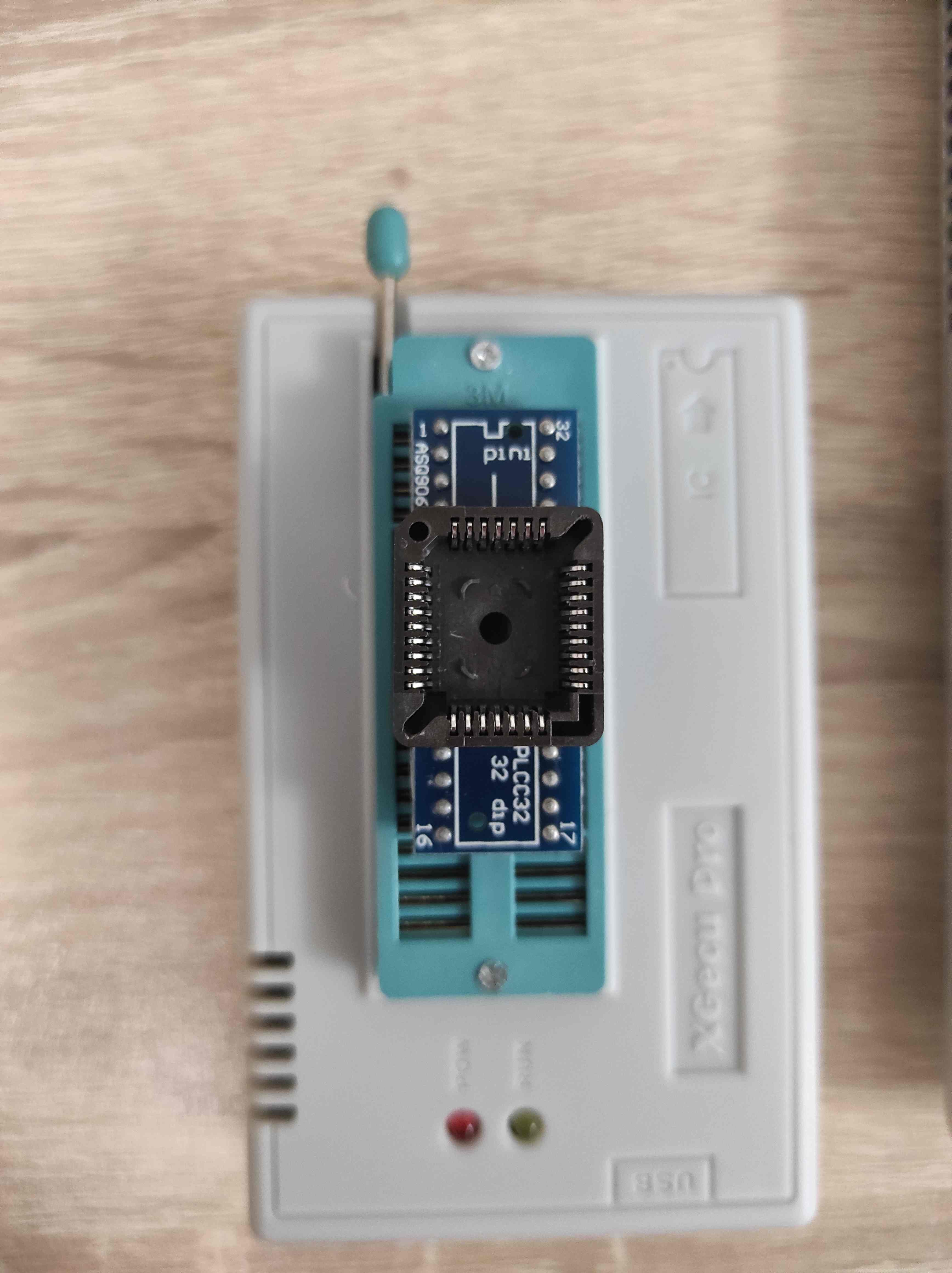

I have ASQ906 - PLCC32   adapter and did try with dip28 version but it did not work.
No jumper on m ...
apofview 发表于 2022-3-8 04:14
    As an User.....  The answer is yes, but it's a 'pain in the neck' not a single pin will remain in place, and the modified adapter may not work because of length of wiring, and the new adapter is less then 6
回复 3# apofview
Use a special adapter:  PLCC32->DIP28
No jumper on my adapter?
Adapter is ASQ906 no jumper, Your is ADP-006.
So I need another adapter, thank You!

Can ASQ906 be modified to ADP-006?

apofview 发表于 2022-3-6 23:26
As an user.... You may have already the adapter needed
Adaptador de adaptador plcc32 dip28, adaptador de soquete ic para tl866a tl866cs tl866ii plus ou outros programadores universais|Calculadoras| - AliExpress

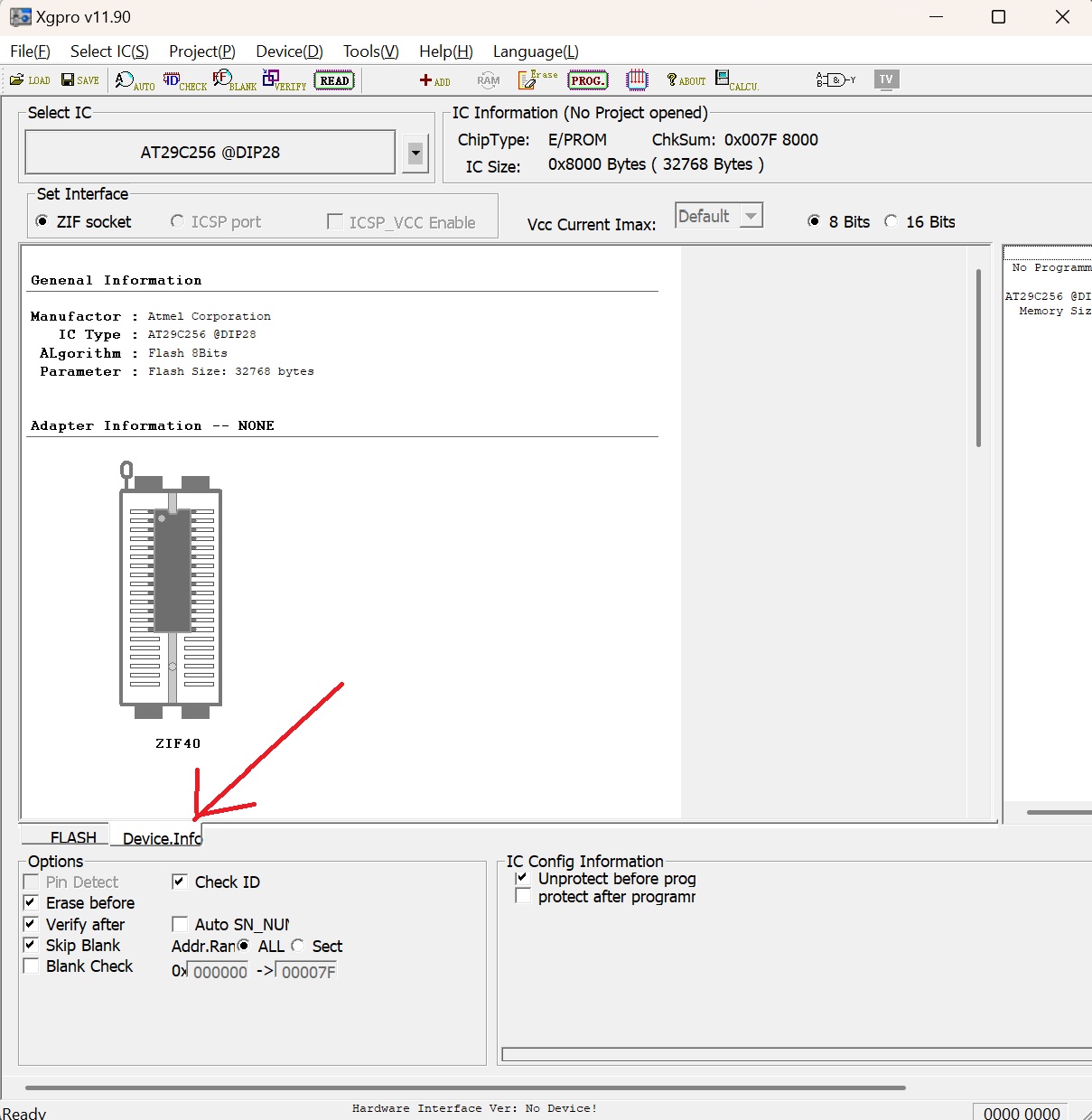

Selecting the DIP28 Version, using this adapter, and in Xgpro APP , select 'device info' , insert pin 1 and 28, on top
AT29C256 datasheet (datasheetspdf.com)
Hope you have the adapter, and this little trick, you now know. The Jumper, as the IC is 5V,
should be there.
Hopefully, it will work for you  :)
