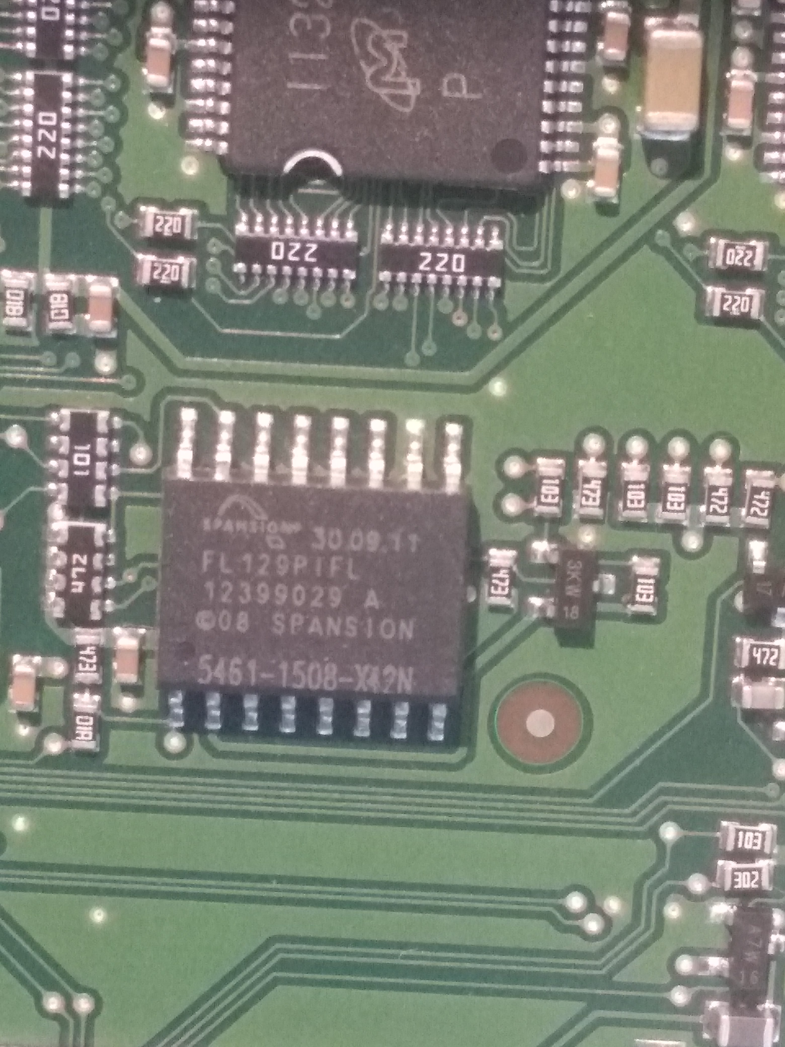

Hi guys
can someone tell me if you can read this is Spansion FL129PIFL with XGecu T56 v.11.60
I can't find him
Thank you

发表于 2022-8-13 20:42
ok works can read and erase thanks

发表于 2022-3-3 19:42
4#
Thank you for helpingThis week I check and tell you
发表于 2022-3-2 08:26
barto44
you have a test.
it should be same as S25FL128P @SOIC16

发表于 2022-3-1 21:27
hello, here you have "Spansion"

发表于 2022-3-1 17:25
barto44
Please provide detailed meomory device model
