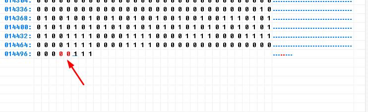

the last row of fuses (14496 to 14504) are all 0 and therefore not defined in the file, but the file seems to be defined for 14504 fuses with "*QF14504" on line 15. They are however all loaded as 0 in Xgpro. If i compile for input pin keeper (V750CPPK) fuse 14501 is set to 1 and has correct effect on the chip after programming (keeping input states), but no improvements on the logic for the flipflops.

your JEDEC file only 14496 fuse .
try : chang 14499 14500  fuse into  0 0   after load jed file. then Programming it.

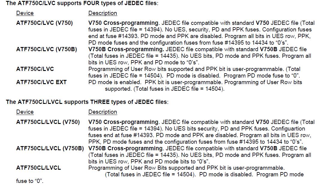

My chips are ATF750C-10PU, I generate JEDEC file for ATF750C (V750C in WinCUPL) (14504 fuses), and select ATF750C in Xgpro. I have tried many variations with generating JEDEC files for V750 and V750B and trying to program with the cross-programming options, but get eighter the same result or no working chip. test case.rar (4.97 KB)

Use the correct JEDEC format file:
