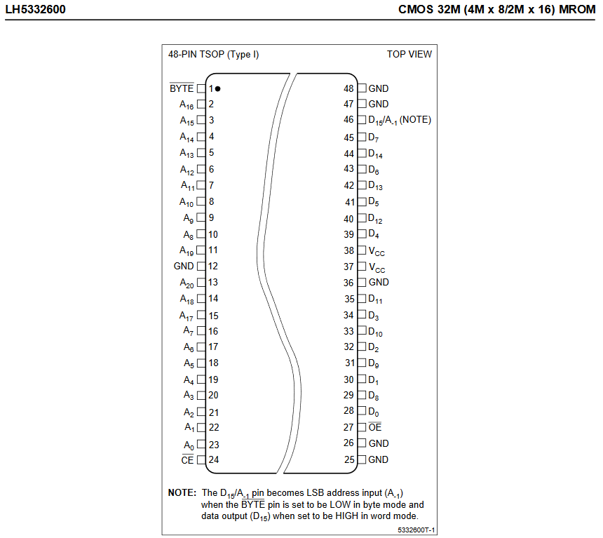

Reading TSOP48 mask ROM
I have a Macronix 5V Mask ROM that I need to read which has a non-standard pinout, which as far as I can tell is very similar to this for the Sharp LH533 MROM series.
Can anyone advise a supported chip that I can select that will allow me to read its data?

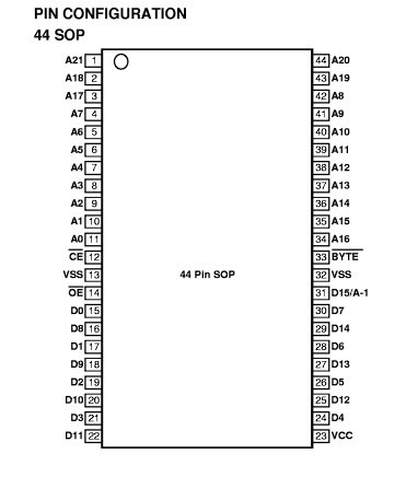

Hi, Please add support for the SOP-44 package for the MX23C6411
OK,we will add MX23C6411
Actually it doesn't work quite right, because the MX23C3211 is only 4MB, and the chips I have are 8MB :'(
I believe I need MX23C6410 support, with the only difference being that pin 12 is A21 instead of VSS.
This chip is same as MX23C3211, choose MX23C3211 to read.
Thanks! That worked :D
