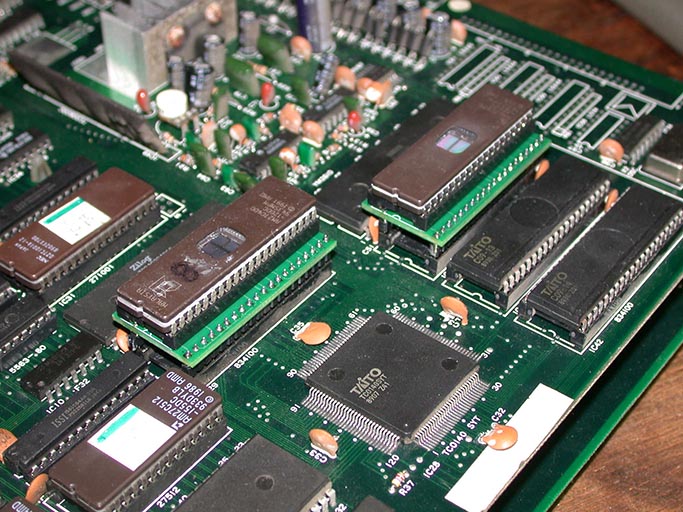

You do not need to program 27011. Those chips are very old and unreliable, and also hellishly non-standard. If you replace it you are only replacing a bad chip with another unreliable chip.
The correct way is to make a small PCB adapter and use a modern EPROM.
For example like the pic I attached which is an adapter I made. These are sent off and produced at places like PCBWay or JLCPCB and you can get 5 for $2. Program a normal EPROM, plug it in and it will last at least 30 years.

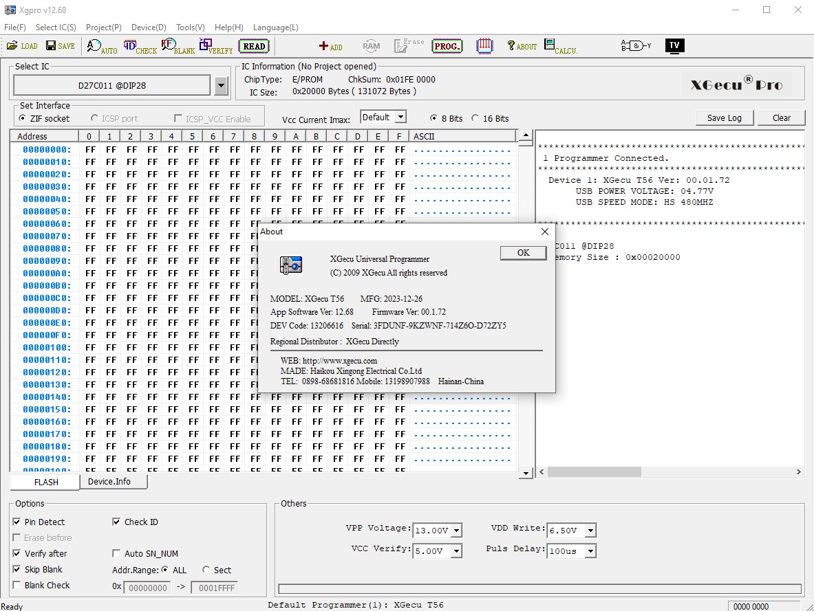

Hello All,
I have received my T56 back from XGecu and I can now programme 27011 and 27C011 eproms.

Hello All,
Not sure what they did to the unit but it now works.
The version of app software is 12.68 and the firmware version is 00.1.72.
Not sure if these are updated versions as I do not recall the version numbers from before I sent it back for repair.
Anyway, the good news is it now works.
XGecu assistance with this problem has restored my faith in their after sales service.

Do not use the defaults, they do not work.
VPP must be 13v and VDD must be 6.5v.
See the device data sheet at the end of page 4-192.
This shows the required voltages for quick pulse programming which I believe is what the T56 is using.
17.75V VPP is not an option on Xgpro so use 13V. The device maximum is 14V so OK to use 13V.
6.25V VCC is also not an option on Xgpro so use 6.5V.
These settings do program the device but with 18 repeatable errors. See my screen shot.

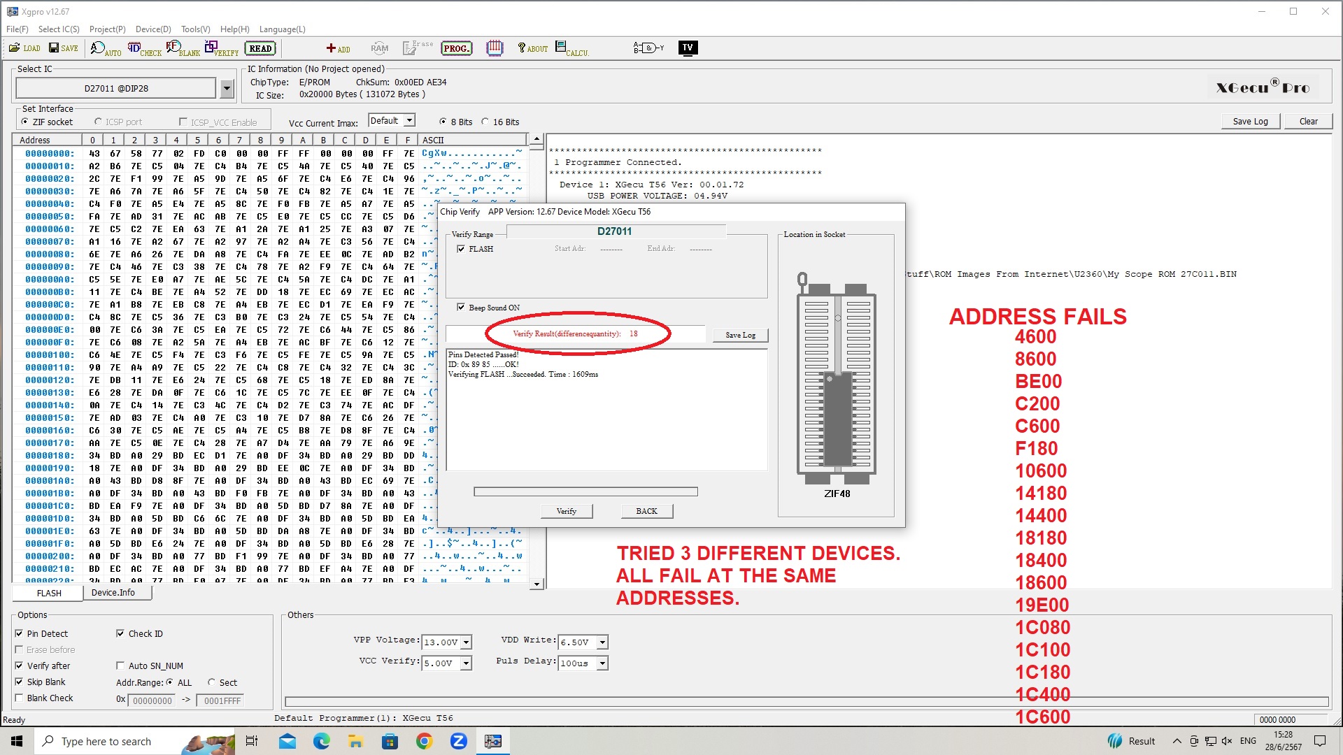

Hello Sir,
I have tried erasing for 10, 15, 20 and 30 minutes with the same result every time.
Address 00 has a value in it that the programmer will not over-write hence it fails.
It fails to write correctly a total of 18 addresses. All other addresses write correct data.

Hello Sir,I cannot program the Eprom completely as there are errors in some pages.
Page 0 is ok but after that there are many errors.
I think there are 2 main issues with this device.
Vpp is not +12.5v and the page switching seems to be unreliable.
I can only hope that XGecu can come up with a fix.

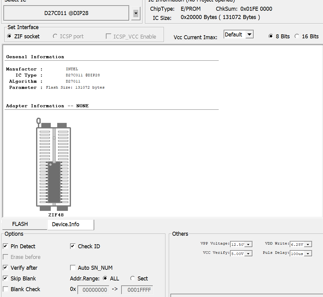

I have purchased a T56 to specifically program Intel 27011 paged eproms.I cannot get it to work.
It ...
lungchard 发表于 2024-5-7 18:08
Hello Richard,
                    If those ICs have a transparent window on top, maybe need to be UV erased first.
Check in the top 'Device' tab, and do a blank check first, if it have the window on top of ic, and fail the blank check,
it doesn't  allow you to program/reprogram the device.
If is the case, do an UV erase cicle, to one or more ICs, recheck if pass blank check, and then reprogram it.At bottom left of app window, you can also set  the blank check to run first before programming.
UV light EPROM Eraser Ultraviolet Light Drawer style to erase EPROM micro-controllers erasable IC, Timer can set erasure time (aliexpress.com)
If not the case, post an image with error or what you see.
Hope it helps, or not :-(
