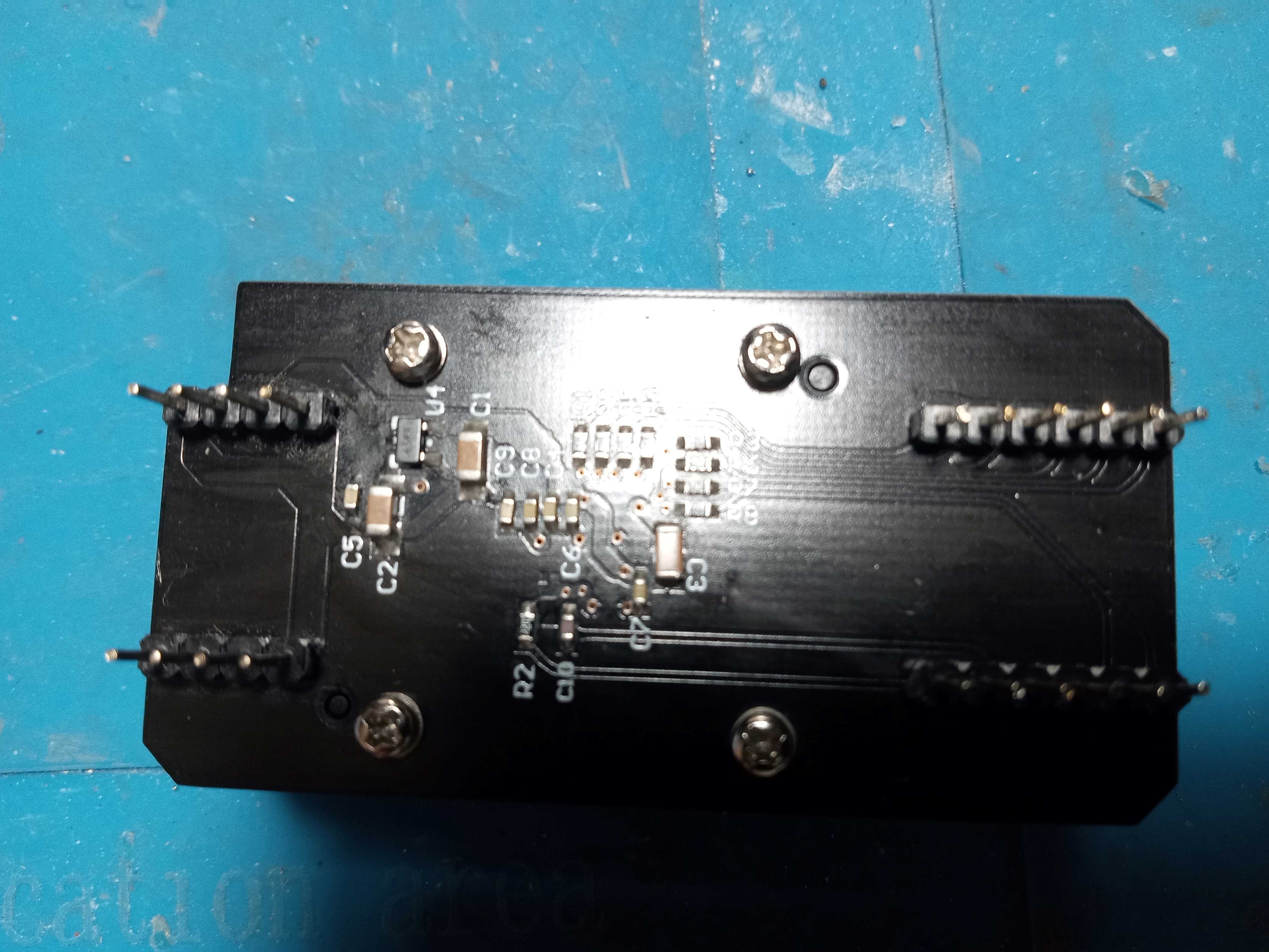

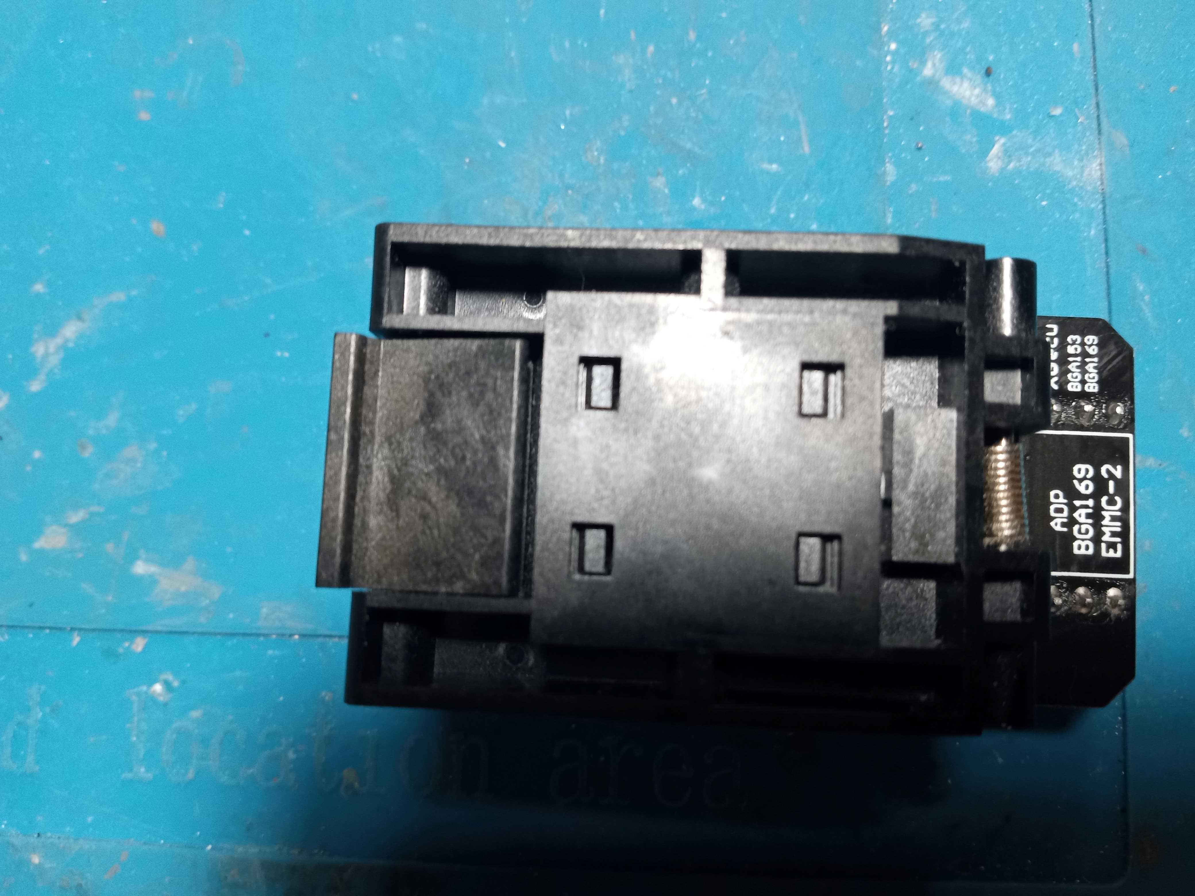

I am using an external 5v power supply, also I tried auto emmc (1 bit, 4bits, 8 bits) with same error, also I put a H26M52103FMR and reads and analyzed OK, so I know the device is OK. Adapter is XGecu BGA153 BGA169 (ADP BGA169 EMMC-2). Have anyone been able to read the H26M62002JPR with the T56?

Great!!! Thanks, Maybe we can use the ISP connection to the BGA adapter socket, if the admin help with how to wire it, the adapter that works for you is sold out, the one I got is the most expensive and I was expecting that works for all BGA 159/169 chips.
I purchased this one on their site and same problem, failed to read the H26M62002JPR, I contacted the store and they answer: I will report this to the manufacturer to see if there is a good solution.
link
My plan is to use the last adapter and rewire to use the ISP connector and see if the T56 can read the chip, they do not provide the schematic of the adapter, so it will take me a few hours to do it. Thanks
