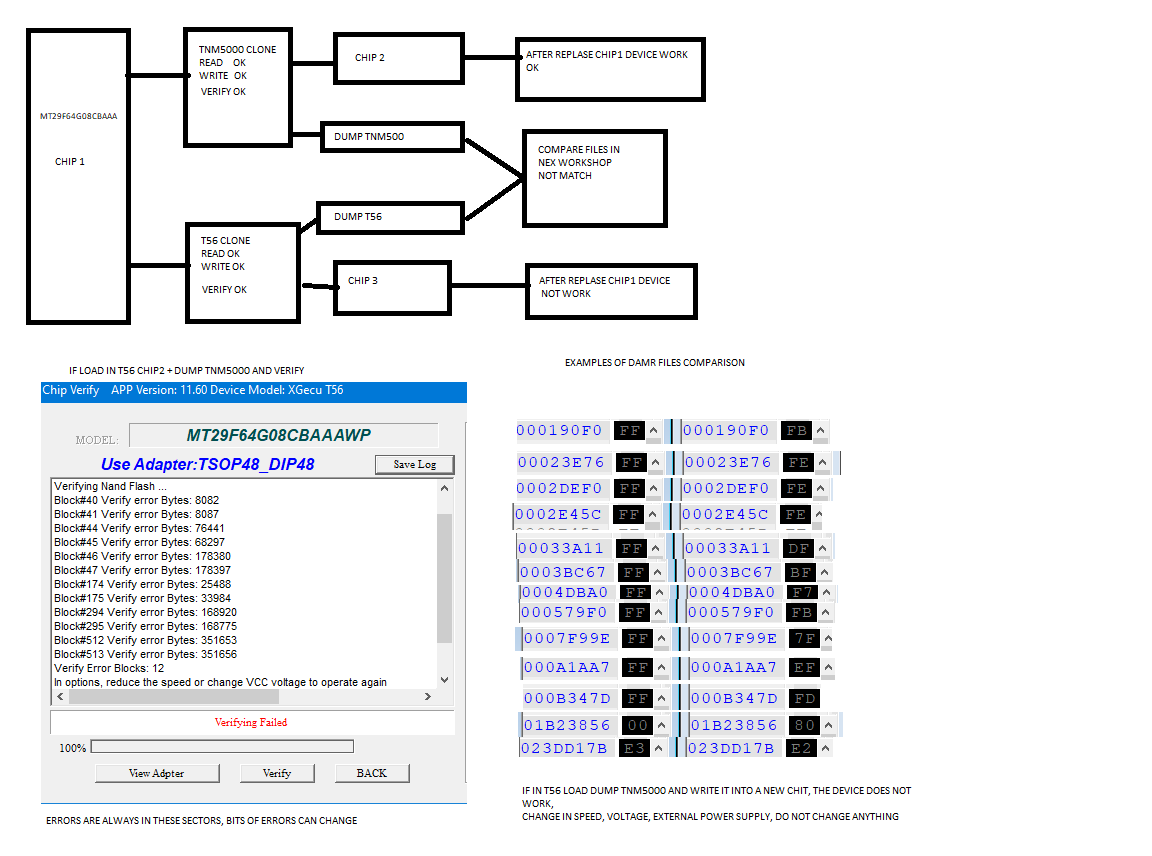

HI!!HELP ME)))Hi, I can't copy this microcircuit. the chips are in good working order, there are several of them and the result is the same with any of them. I took a TNM5000 from a friend to find out what was the matter,
maybe you can tell me something useful, with other microcircuits the programmer works fine

I will try to explain from the other side:
I take a working chip from a working device
clearing pins
insert and press ONFI
1-read & verify-ok, save dumpfile1.bin
2-read & verify-ok, save dumpfile2.bin
3-read & verify-ok, save dumpfile3.bin
between these actions, the chip and the programmer DO NOT TOUCH
when comparing, all files are different and all are verified on the programmer again

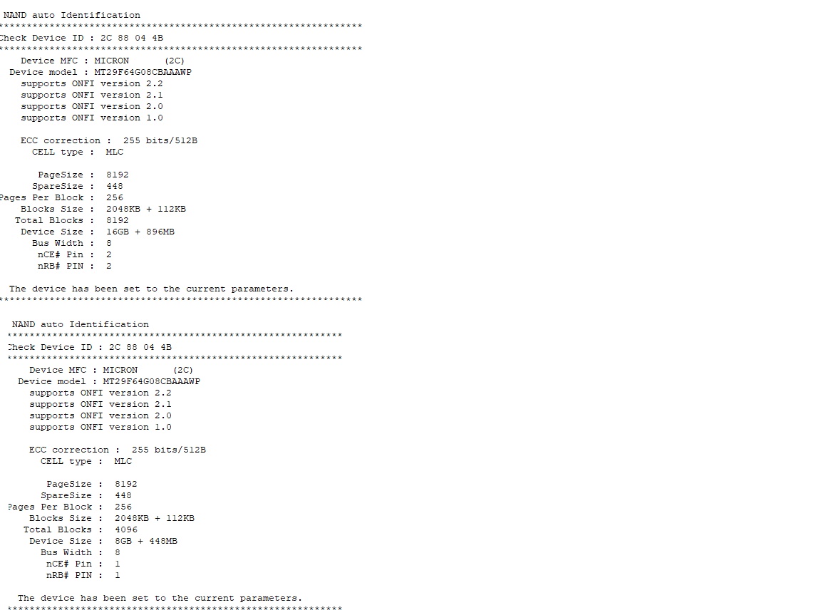

in my settings it was 24/1024, from help I realized that this parameter can be ignored if ECC disable
will change to 8/512 affect read or write results?
ECC disable \ enable?
Hey! I tried to write a dump made by TNM5000 with different bit flip permission settings, the result is the same, the device does not work
it also happens that ONFI gives out incorrect data 16 instead of 8Gb
and ECC 255/512
Hey! I want to return to the discussion of the problem with MT29F64G08CBAAA
I bought another TSOP48 adapter. for soldering
I also bought a ssd with 16 chips MT29F64G08CBAAA, which works perfectly
I take the chip from the ssd, solder it to the adapter and check for badblock and get 3473
after which I try to read the chip and verification after reading does not pass,
bit flip permission will change the number of errors during verification, but in any of the modes they are
if you erase the chip and write something there, verification after writing is ok and the amount of badblock becomes 2,
and these 2 badblocks on all my chips 90 and 91,
and they are from different parties and different sources
I want to remind you why it all started:
i can't copy MT29F64G08CBAAA from a device that is 100% working and working on a different chip
and another programmer does it
tell me what else to do?
