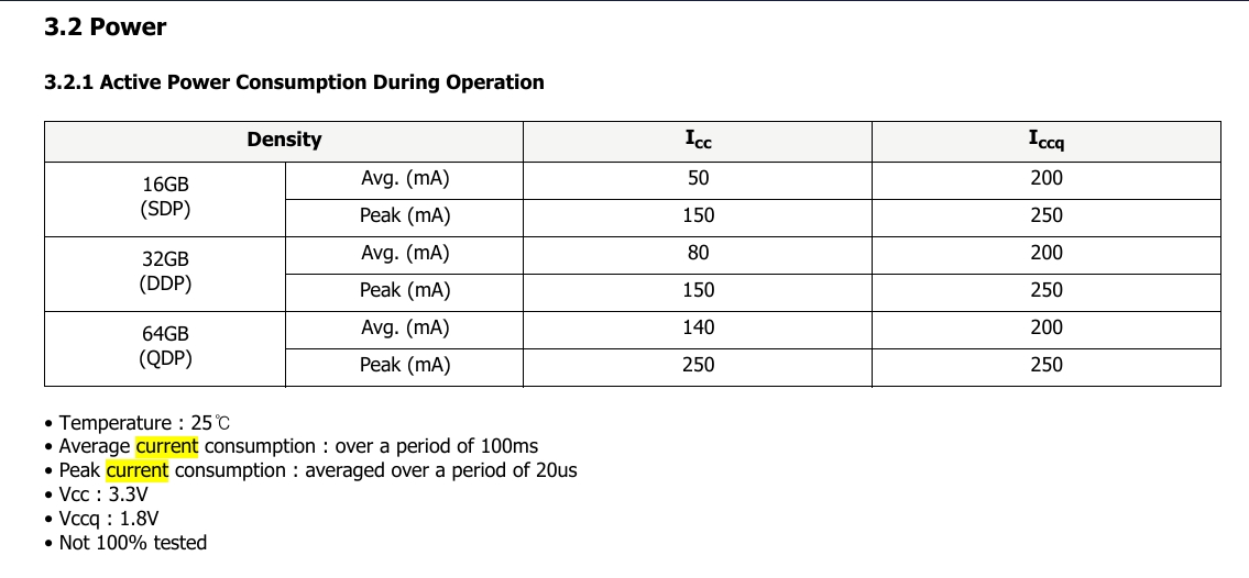

             Trying to see in datasheet https://datasheet.lcsc.com/lcsc/2204261415_SK-HYNIX-H26M62002JPR_C3002776.pdf  if any helpful info is there, but so far do not yet  find a reason. Hopefully it can be fixed for you, or if bad ICs, or any software limitation that prevent read, but that shouldn't occur in new, but never used Ic.
In the mean time, found this info that can be relevant, that may indicate that the IC draw a bit more current then default and need an adjustment of 'vcc current imax' ...
I tried again, Same error with current at 350ma. Also I tried with another computer, same error, to  ...

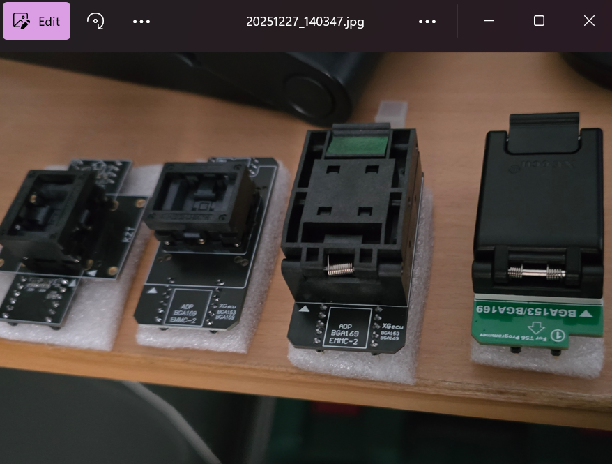

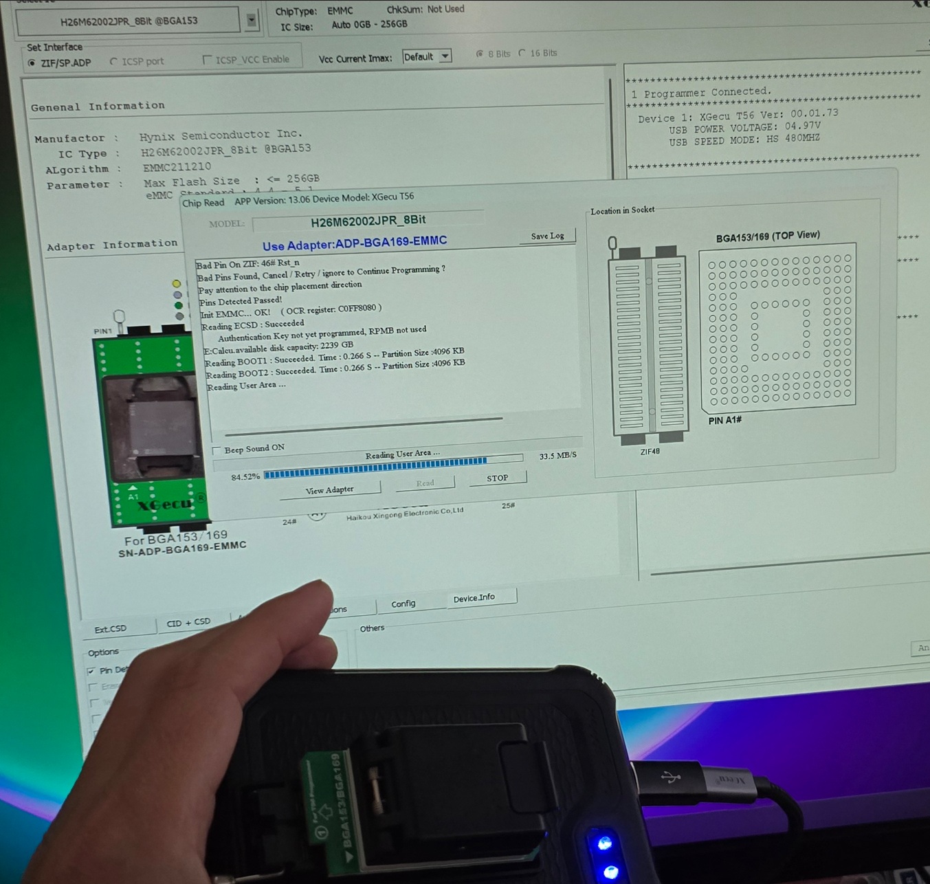

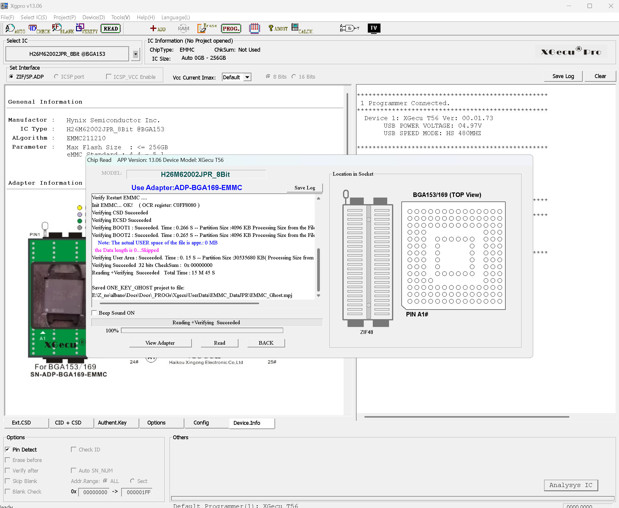

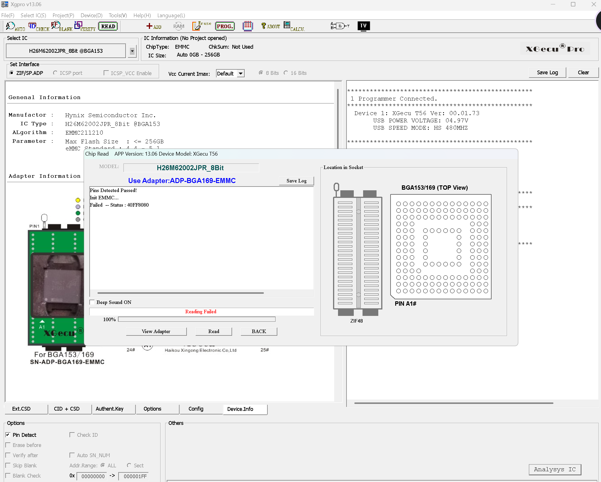

Using my adapter, same as yours, got same inititialisation error return code,
but, as i've told you, T56 have several adapters to read BGA153, and have it here and tested both and it works with latest one
https://xgecu.myshopify.com/products/emmc-bga153-bga169-adapter-ic-socket-for-xgecu-t56-programmer-with-du
Maybe this help ADMIN to fix issue,  give a tip, or an answer that isn't expected at all....

Albano.Matos 发表于 2025-12-16 03:39
    Hello again,
                      I've asked Ali XGECU store to help. The first answer i receive was i was the only one complaining :'(...
and accept to test the very latest two BGA153/169 adapters, cheaper ones with only one format, not 3 or five with different
size adapters provided as previous.
And all those adapters fail the simple read test with H26M62002JPR, except adapter number 4, that is, currently, discontinued.
Hoppefully, or they update the software, and or firmware, a new hardware adapter, discontinued for T56 is needed to read this IC. Lets wait to see the development. I've sent them all picture tests from failure and sucess.

luzmina 发表于 2026-1-15 03:58
   At least they can't say 'you are the only one with the problem' as they already have at least 2 complains, as you bought adapter number 2, from picture in the post before, and also failed, and they know that. Even the problem may be at shielding level, is so severe, that the software trottling down in frequency, you already shown in the log, down to the bare minimum  , 8MHZ, isn't capable to initialize the IC. I stop all 'guessing' till they update the software to support all adapters, if they do not do it , as the software is the very same for T48, not big deal, restart selling the discontinued  adapter, as other faster ICs, for sure will (may) also fail, i will try to build a faraday cage that connect to signal gnd.As a work in progress, please, post here any new versions you may know, even not tested yet, of IC new versions used in the boards of that Tvs, i'll try to test here a.s.a.p.

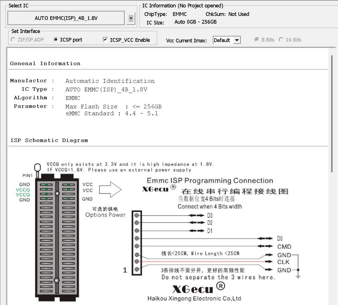

luzmina 发表于 2026-1-17 05:25
Using ISP.... till 4 bit only, slower, and select auto  xxxxxxx, see picture
