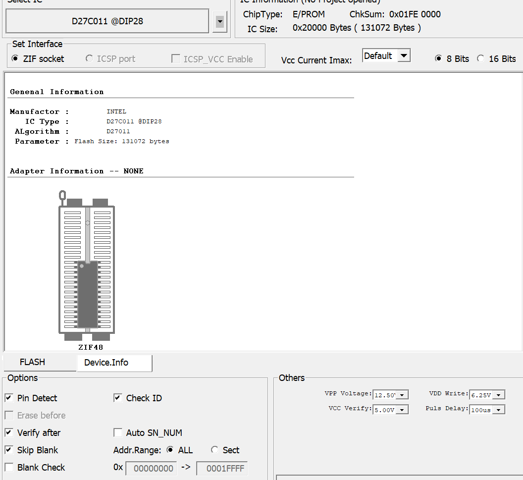

I have purchased a T56 to specifically program Intel 27011 paged eproms.I cannot get it to work.
It ...

    Dear Richard,                         As you say that new version did not work, can you, please tell us,
as you have a patch to get it to work, as they have included new a D27C011, that use same algoritm
as D27011, which values are shown in the 'others' section at bottom of app window?
for me it shows... the voltages show the same as defaluts on both ICs, normal and 'C' versions.
Yesterday cleaned the label from more then 50 ICs, but still no luck with a 27011 to test :'(

Hello All,
I have received my T56 back from XGecu and I can now programme 27011 and 27C011 eproms.
