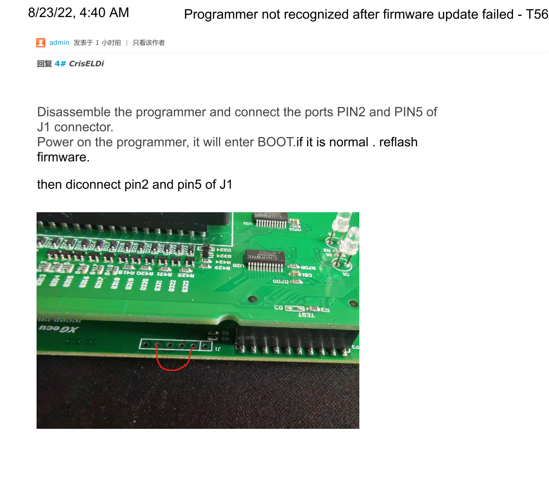

Hello dears!
Dear friends, the programmer stopped working after the latest update (v12.66).
When ...

   Hello,            Reinstall software 12.63, it happen the same to me. The problem
appear to be the application not the device. After that reinstall 12.66 and if like me
it asks to flash firmware again to 1.72, it remain 1.71, ok! Done a self test ok!
Hope it help you, or not!
Rgds
Thanks buddy but it didn't help me. The computer does not see the device at all. I also hav ...

   You can use the procedure to recover, first jumper it and if it appear ok, reflash it,and if sucessful do a self test.Do it if you want at your own risk :(
Does not help.
The programmer behaves like a brick. When a jumper is made, the LED blinks  ...

It looks an hardware error. Sometimes Admin post a tip, hopefully. :(

Alas, nothing helps.
I connected the PIC prog ...

   Hello, sorry i dont have parts for it, or any dump.
As a last tip, have you tried to run it with external power connected ( 5 to 5.5v 500ma ),
normal not needed or recomendad? Any Change?
If you need parts you may try to ask in the place of purchase.
Hope it helps , or not :(
