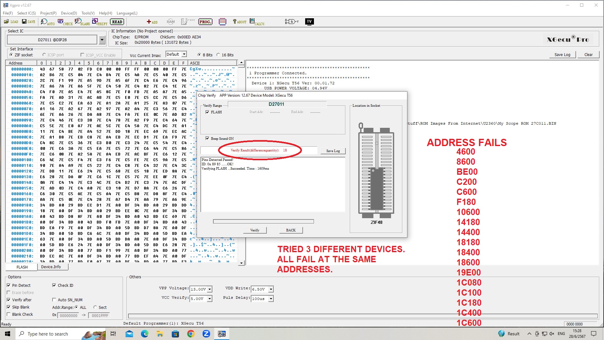

Hello Sir,
I have tried erasing for 10, 15, 20 and 30 minutes with the same result every time.
Address 00 has a value in it that the programmer will not over-write hence it fails.
It fails to write correctly a total of 18 addresses. All other addresses write correct data.

I see from your post you are using different voltages than what I used.
Do not use the defaults, they do not work.
VPP must be 13v and VDD must be 6.5v.
See the device data sheet at the end of page 4-192.
This shows the required voltages for quick pulse programming which I believe is what the T56 is using.
17.75V VPP is not an option on Xgpro so use 13V. The device maximum is 14V so OK to use 13V.
6.25V VCC is also not an option on Xgpro so use 6.5V.
These settings do program the device but with 18 repeatable errors. See my screen shot.

Hello Sir,
Typo in first reply.
VPP is not 17.5V on the data sheet, it is 12.75V.
6.25V for VDD write is selectable but I used 6.5V. Device maximum is 7V on data sheet.
Also my screen shot was not attached. I will try to attach it again.
Hope this update includes picture, it is important information.

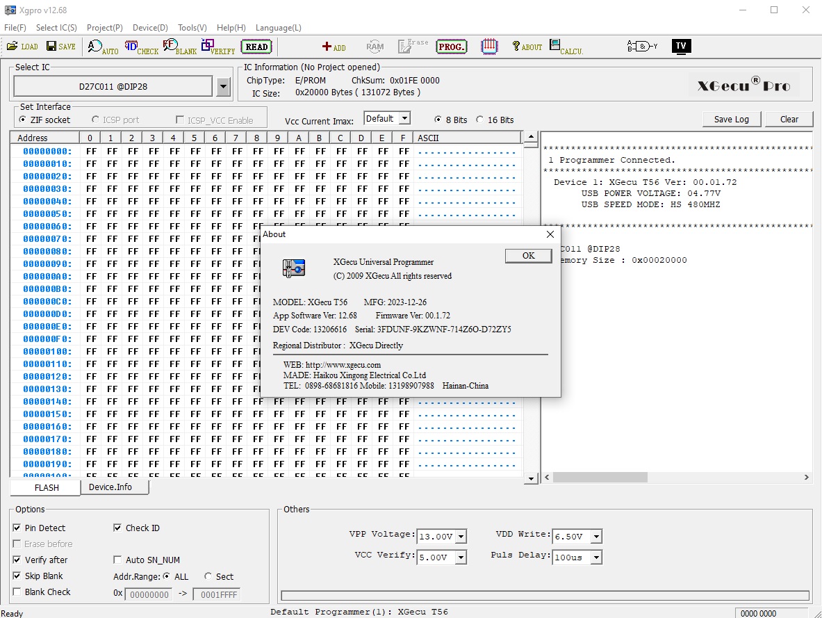

Hello All,
I have received my T56 back from XGecu and I can now programme 27011 and 27C011 eproms.
Not sure what they did to the unit but it now works.
The version of app software is 12.68 and the firmware version is 00.1.72.
Not sure if these are updated versions as I do not recall the version numbers from before I sent it back for repair.
Anyway, the good news is it now works.
XGecu assistance with this problem has restored my faith in their after sales service.
Best wishes
Richard,
Thailand.
The software versions I have are shown in the attached screen shot. T56 Version Numbers.jpg
