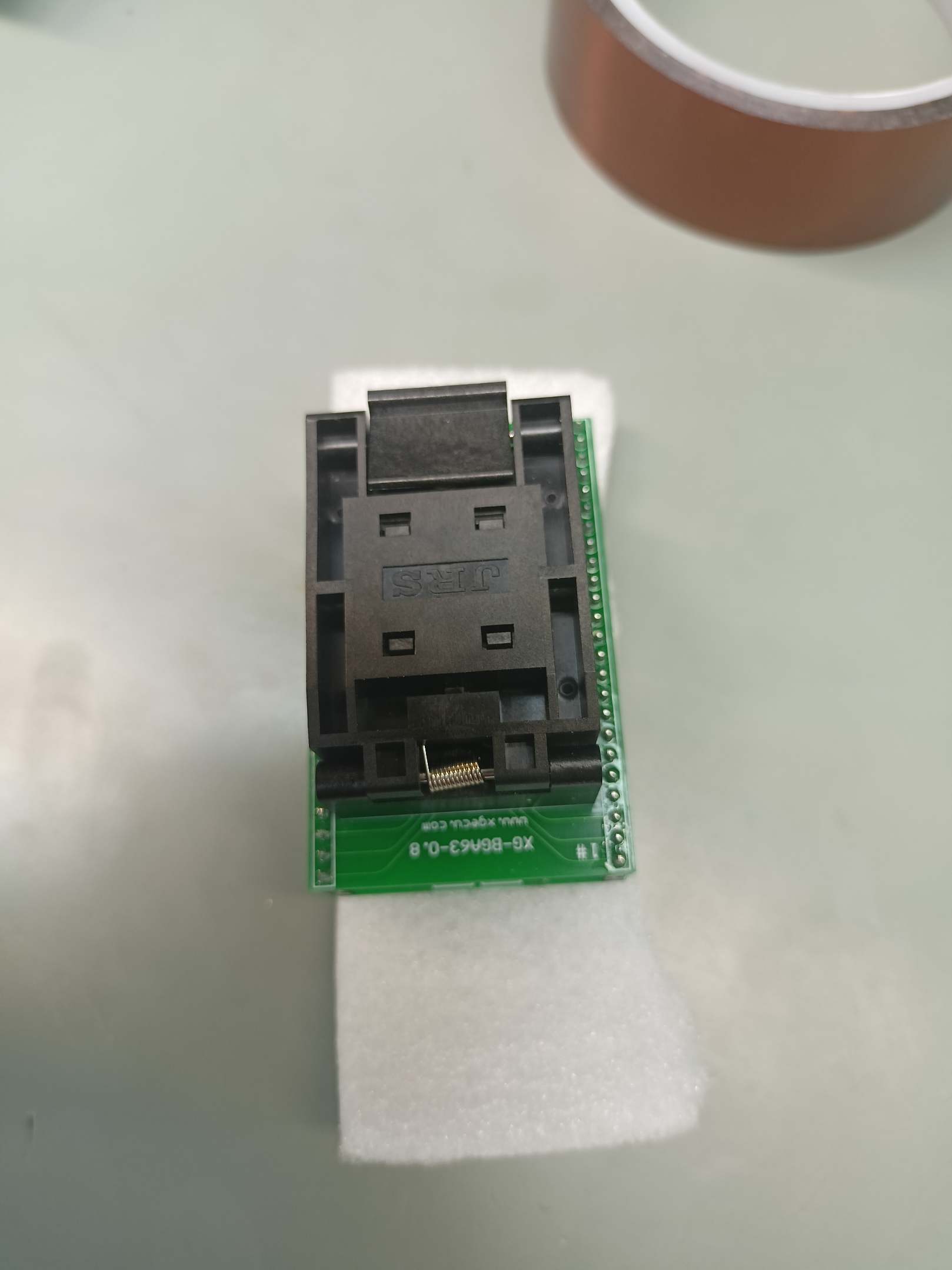

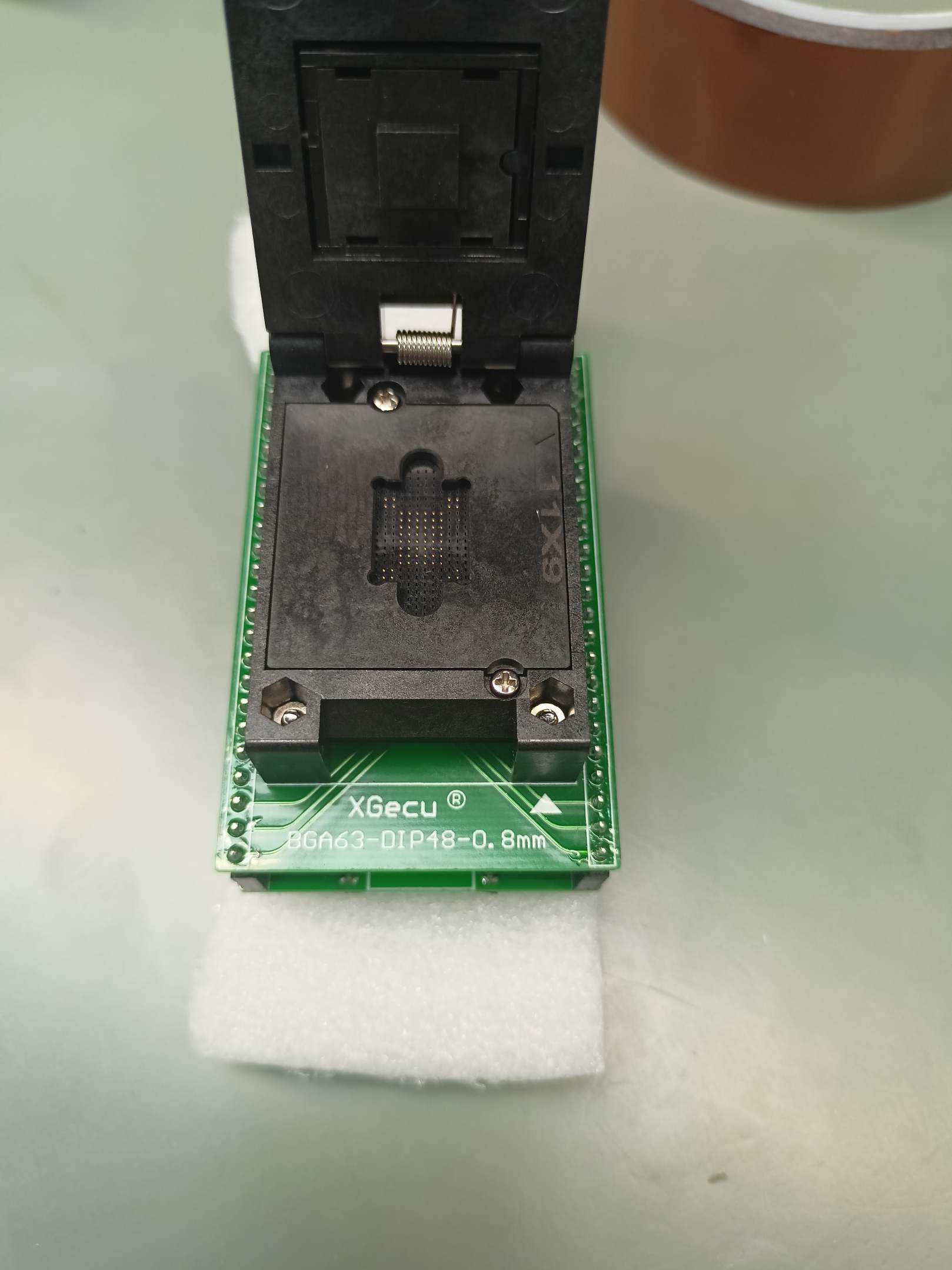

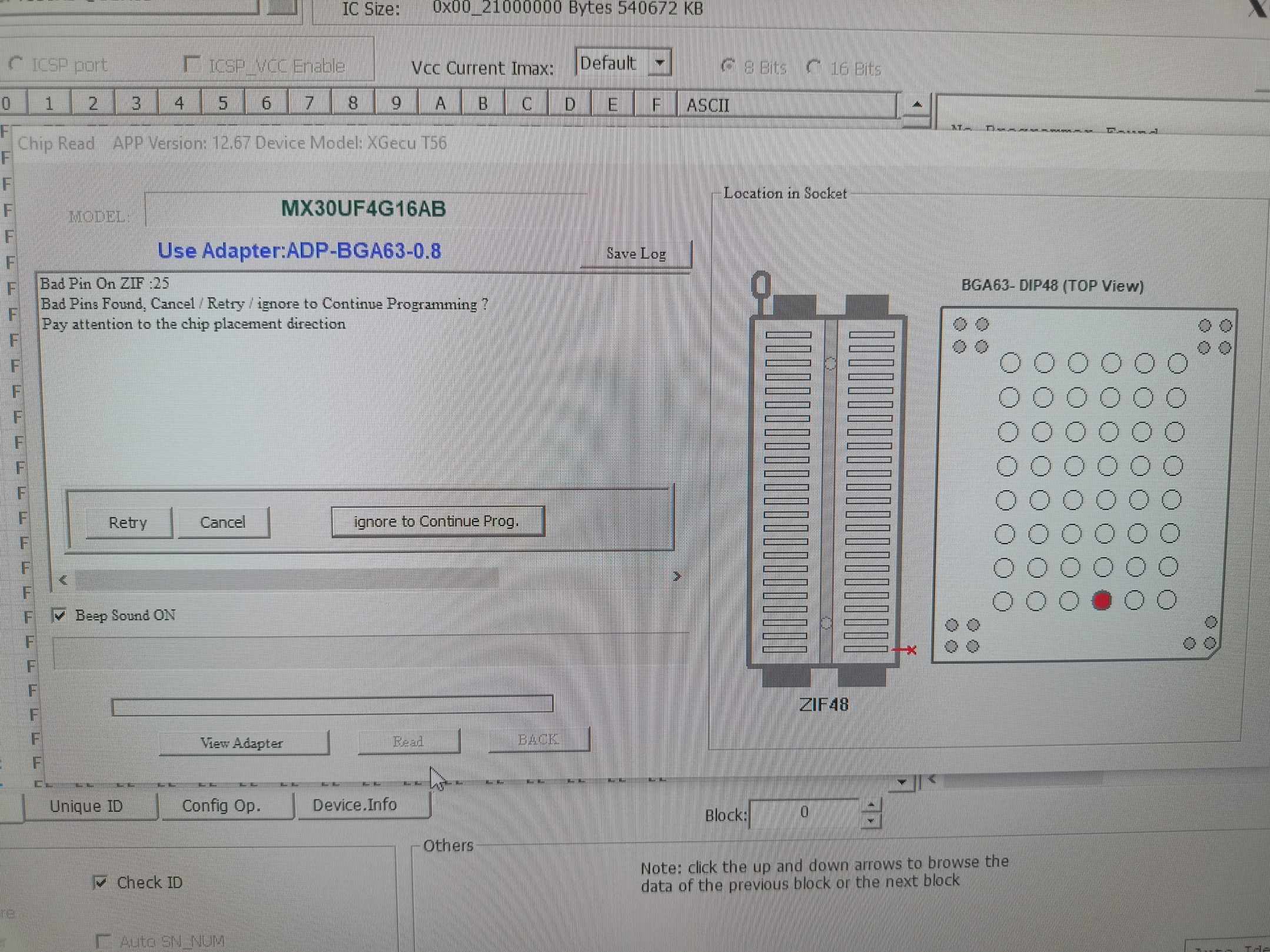

Mx30uf4g16ab contact error when reading the entire FF dump the chip is not empty
T56 Contact error when reading the entire FF dump the chip is not empty. Another programmer reads the chip
what to do? All dump FF
Ответить 3# Альбано.Матос

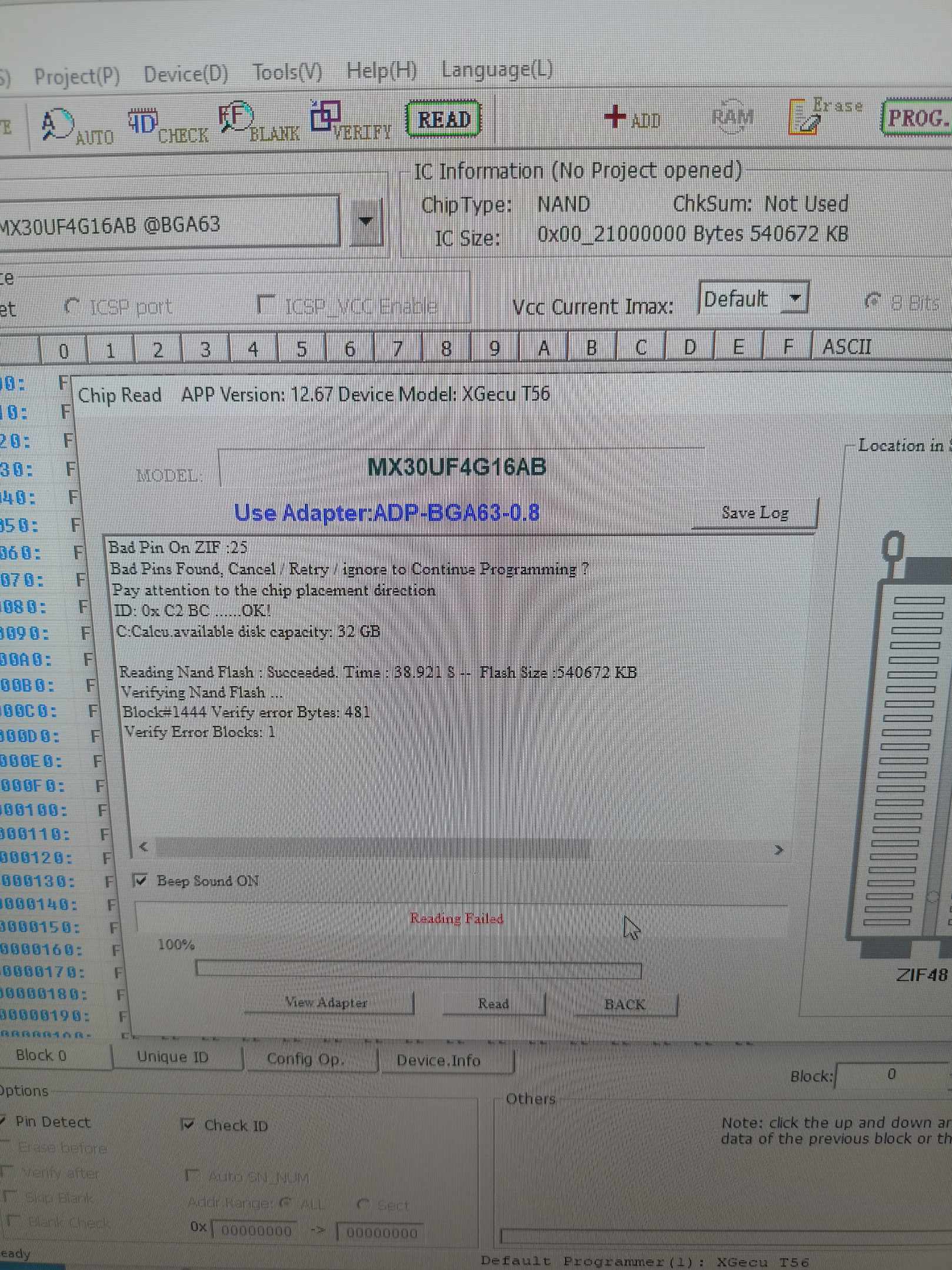

Albano hello, I use the latest version of the software, adapter, rang, all contacts are working. This contact on the chip does not ring anywhere, in my opinion this is the ground contact, I forcibly made a jumper to another ground contact, the error in determining the contacts disappeared, but nothing changed, the dump also remains empty (FF). Why there is only one error in the log I do not know, most likely the code for working with this chip is not finished. The chip is working, fully works in the device and does not fail. I do not understand why the programmer support does not respond to problems. I have another programmer, not xgcue, it reads this chip, but with errors, tech support advised me to read the documentation and play with delays.
Albano I tested, unfortunately came across 2 faulty chips, which gave errors in different places. Were replaced with new ones, but the contact error on them remained, just ignored, or make a jumper on gnd according to the connection compression of the adapter contact (only for this series chip)
Ответить 6# Альбано.Матос
I ordered a regular adapter for the t56 model using the number in the app. About 2 months ago, so I think it hasn't had time to go bad)) This is some kind of problem with these chips
