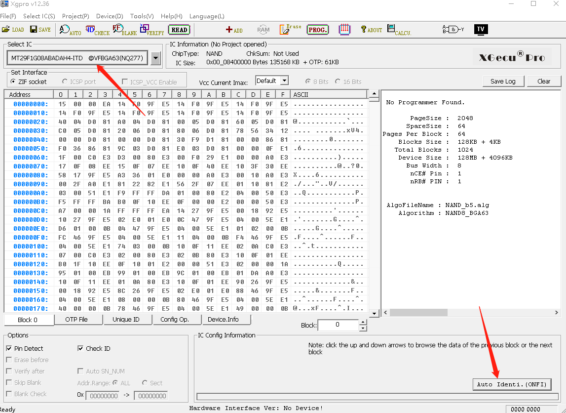

There is no specification datasheet, and it can't be added. If you are a user, you can apply from them
you can select MT29F1G08ABADA @BGA63
and click [auto indenti] ,if it is an ONFI standard chip. you can read and programming it.
