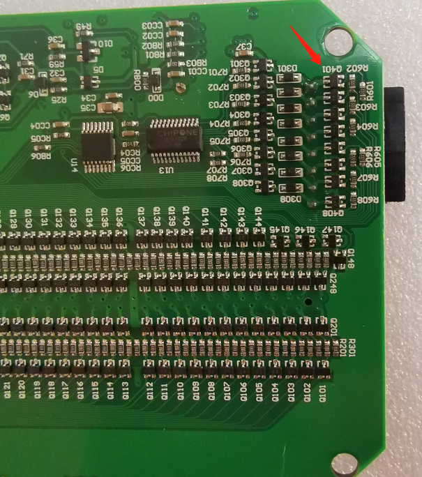

This is ISP PIN1 short circuit to ground。Q401 may be bad. Please replace it.
(Q401: BC817-40W Package:SOT323)
