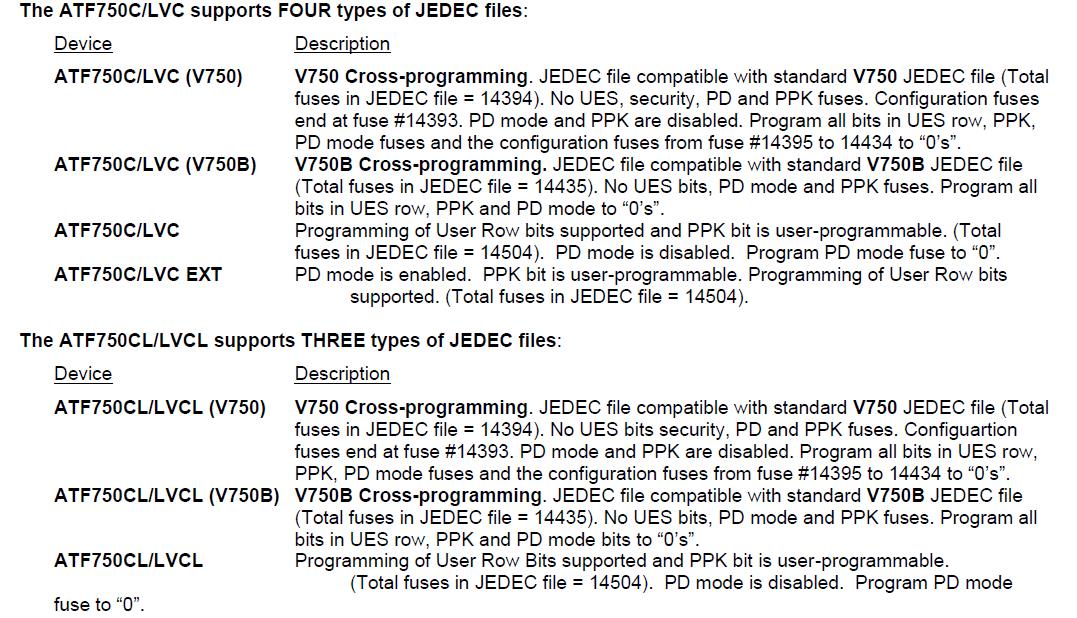

Use the correct JEDEC format file:

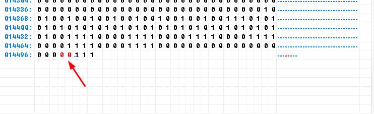

your JEDEC file only 14496 fuse .
try : chang 14499 14500 fuse into 0 0 after load jed file. then Programming it.

I checked the software and the position of each fuse bit . no errors found.
only found a bug . reading is disable now.
Programming/Erase/Verifying are all normal.
I tested it with PLCC28,
I will check it agian after get a DIP24 chip.
