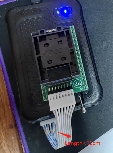

» Program problem PC28F256P30BF (BGA64)
发表于 2023-7-21 17:01
I did not find any errors during my testing.
发表于 2023-8-13 17:16
5#
Please cut the ISP cable length to below 10CM.
(590.45 KB)
2023-8-13 17:16

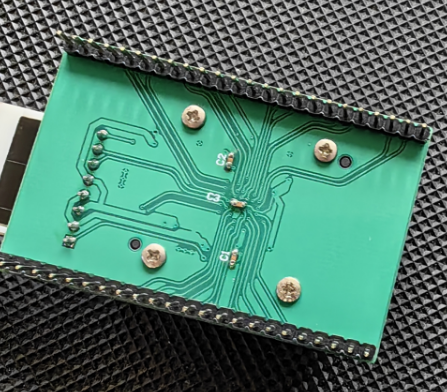

发表于 2023-8-15 14:07
The back of adapter C1,c2 C3 all is 0.1uf.Have them been soldered on?
(394.22 KB)
2023-8-15 14:07
