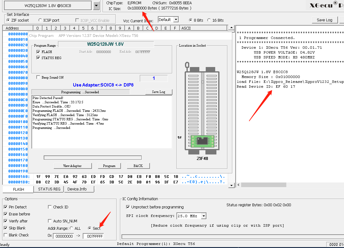

I only have W25Q64JW as a replacement for 128JW testing,writing half the capacity, and the software should be fine.
Possible problem with USB power supply?
