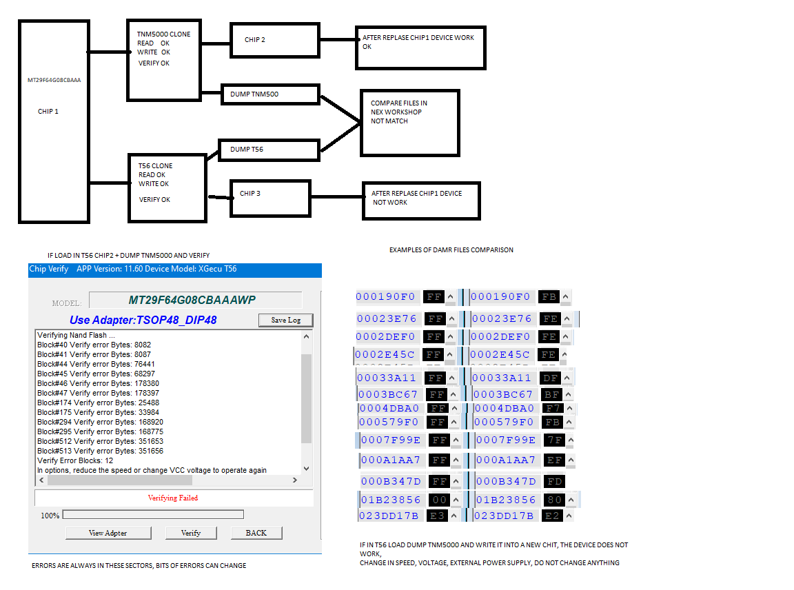

HI!!HELP ME)))Hi, I can't copy this microcircuit. the chips are in good working order, there are several of them and the result is the same with any of them. I took a TNM5000 from a friend to find out what was the matter,
maybe you can tell me something useful, with other microcircuits the programmer works fine

error after block: 40
It seems to be wrong. In this case, there is obviously a programmer reading error. If such an error occurs during T56 reading, the auto verification after reading will not pass.
I will try to explain from the other side:
I take a working chip from a working device
clearing pins
insert and press ONFI
1-read & verify-ok, save dumpfile1.bin
2-read & verify-ok, save dumpfile2.bin
3-read & verify-ok, save dumpfile3.bin
between these actions, the chip and the programmer DO NOT TOUCH
when comparing, all files are different and all are verified on the programmer again
回复 5# Artema
   this is normal,  Nand bits flip.  these error bits can be corrected by ECC correction when running.
  search on google about Nand bit flip.

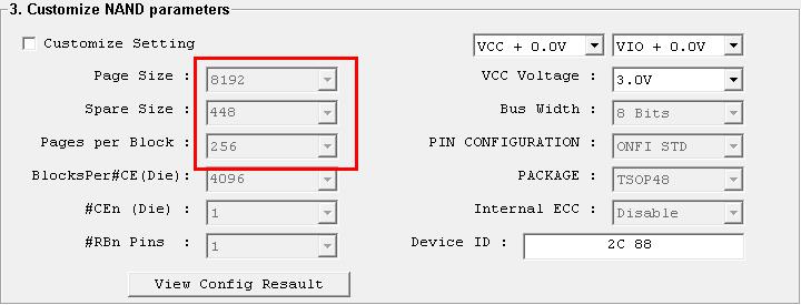

  Related settings on the software:
  [Bit Flip Permission]
8b/512B  : Represent that it allow 8 bit errors in 512 bytes.

in my settings it was 24/1024, from help I realized that this parameter can be ignored if ECC disable
will change to 8/512 affect read or write results?
ECC disable \ enable?

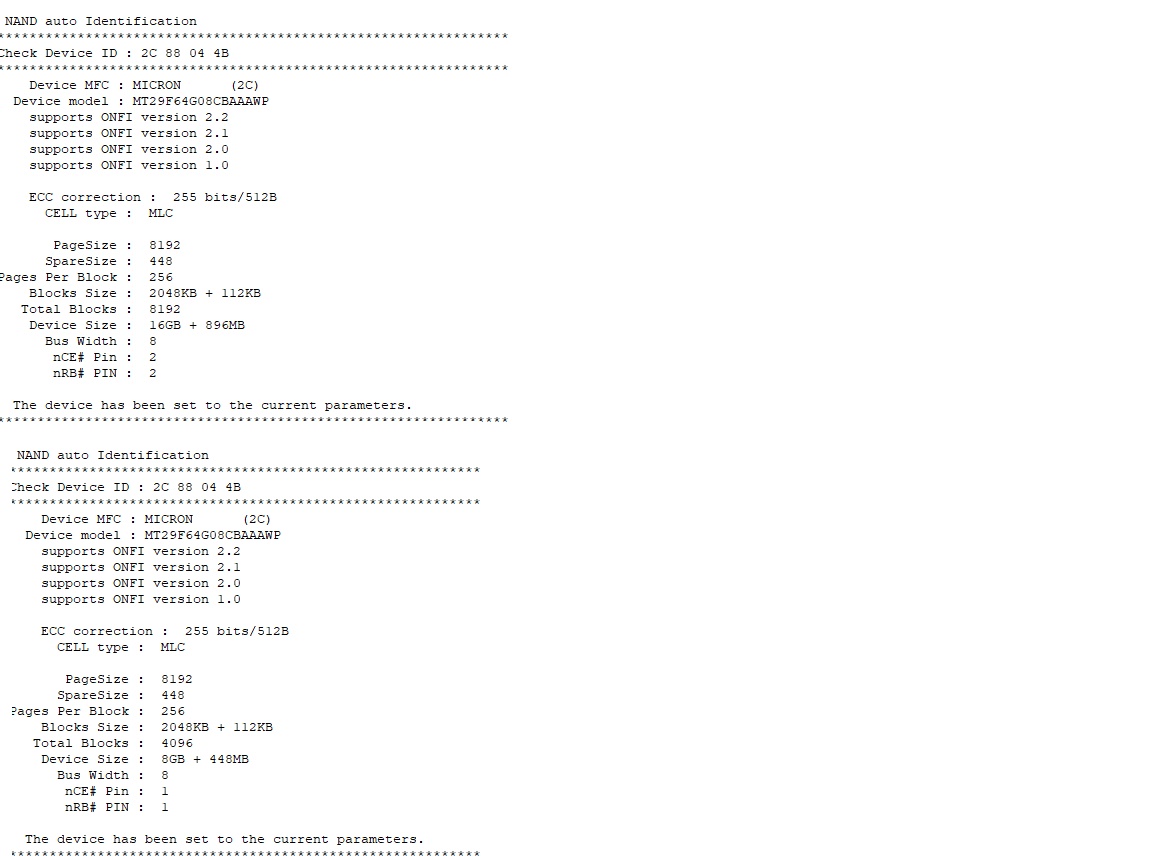

Hey! I tried to write a dump made by TNM5000 with different bit flip permission settings, the result is the same, the device does not work
it also happens that ONFI gives out incorrect data 16 instead of 8Gb
and ECC 255/512
