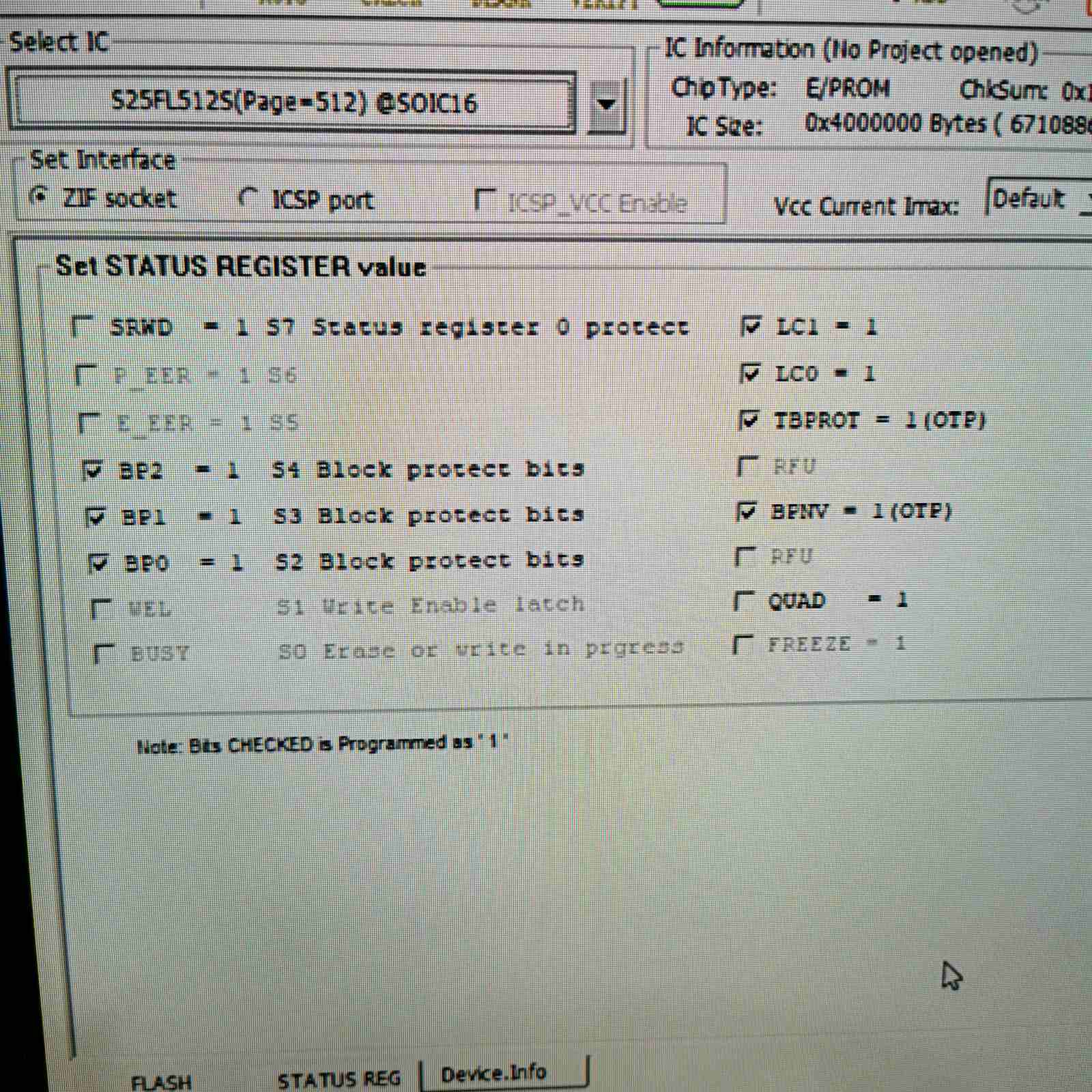

hi i read MX25L51245GMR-10G SOIC16 i read it perfect but i can erase no write new file?must change the chip? or have a specific way to write new file
There are two write protection methods provided on this device,
(1) Block Lock (BP) protection mode (WPSEL=0)
(2) Advance Sector protection mode (WPSEL=1).
The default value of WPSEL is '0'. Please note that WPSEL is an OTP bit. Once WPSEL is set to 1, there is no chance to recovery WPSEL back to '0'.
Now only support standard protection mode(WPSEL=0 Default)
T56/T48  maybe need add this functions about [Advance Sector protection mode]
I will test it.
to you have team viewer to help me i dont undestand
