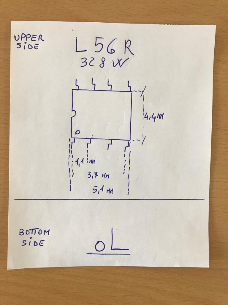

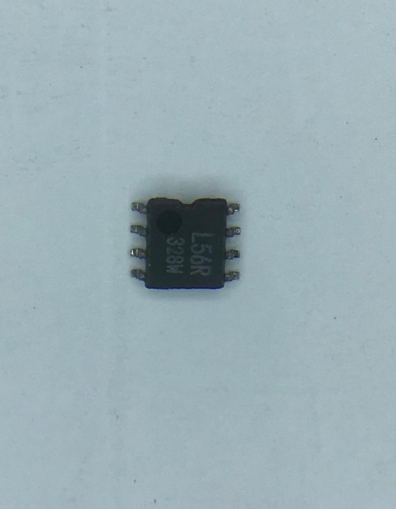

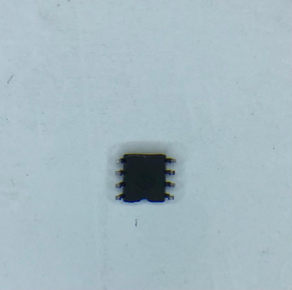

Thanks for the replies, my experience had the same reading with soic8 support, Microchip 93C56 (x16), Rohm BR93C56 (X16), BR93L56 (RF) (X16), BR93LC56 (RF) (X16), ST M93C56 (X16) , M93C56R (X16), then I chose the modified, programmed ST M93C56 (x16) reading, reassembled everything "successful". Thanks a lot for the technical support. |
