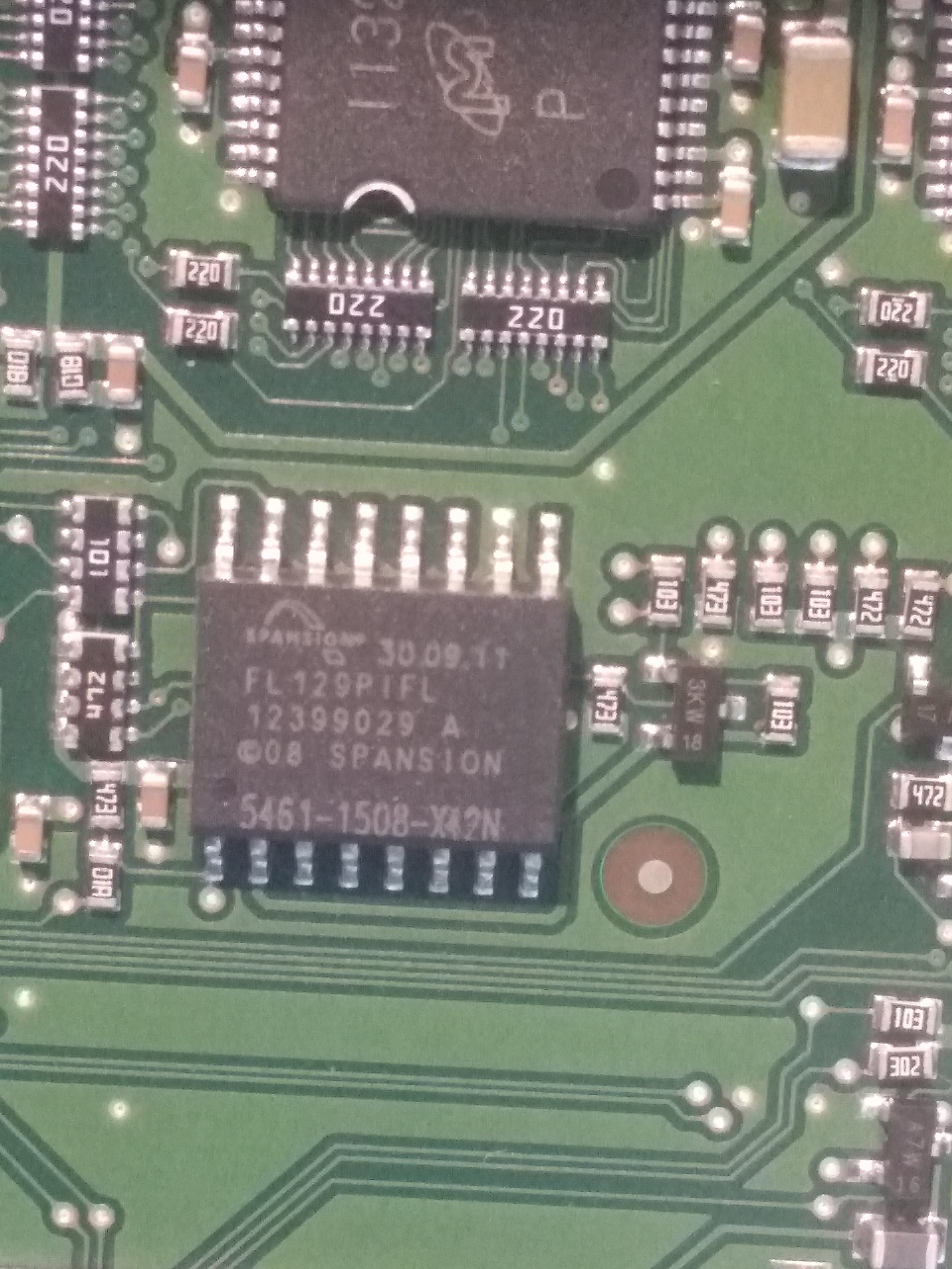

Hi guys
can someone tell me if you can read this is Spansion FL129PIFL with XGecu T56 v.11.60
I can't find him
Thank you

Please provide detailed meomory device model

hello, here you have "Spansion"

发表于 2022-3-2 08:26
barto44
you have a test.
it should be same as S25FL128P @SOIC16

Thank you for helpingThis week I check and tell you

ok works can read and erase thanks
