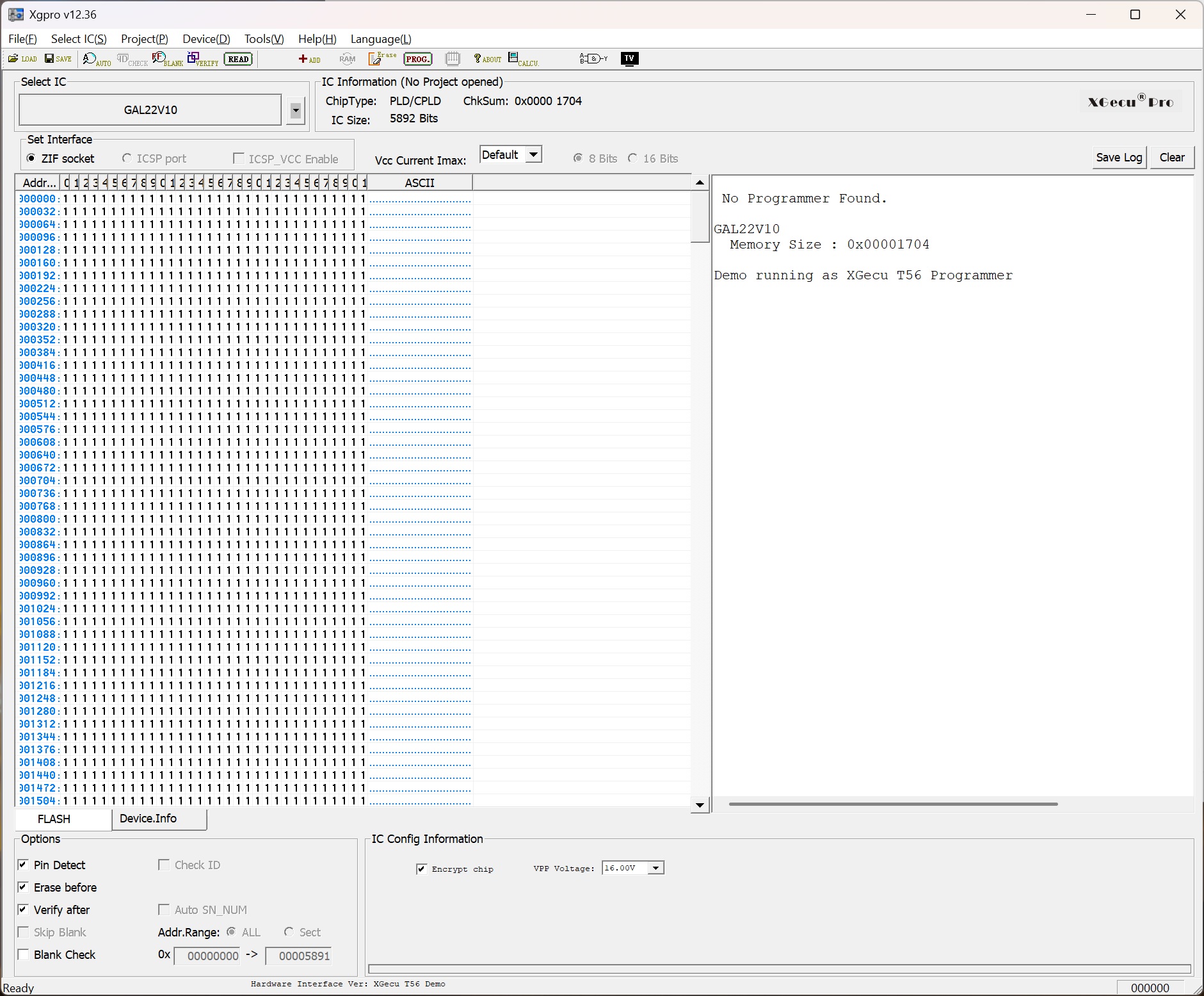

Font size issues on 4K monitors, laptop display 4k
It is problematic to work with the programmer on a laptop with a 4K display, very small fonts and icons, can this be fixed?
With my 4K monitor, i got fonts too large to fit on some parts, like tabs. Please see picture. Anything i can do?Video Adapter: INTEL UHD Graphics 620
Resolution: 4K
Brand: Lenovo 20N2

The software does not have the function of changing the font size.
Normal conditions, the system font size should be set to 100%.

  Dear Admin, You are right, but  If i do This, everything else will be come very small for my eyes.The default (Recommended)  scaling is 150% 4k monitors, for this  I'm trying other approach,
like different desktop for this app. If i was successful i post here what i've done.
Maybe driver scaling is failing ...if not possible in the program should be elsewhere, driver ?

   Dear Admin,                     12.23 looks great now in 4K, finally problem solved ! :D

   Dear Admin,                      From time to time, i see some ICs that still show display partially cut.
Almost all are ok, Thank you. One Example , other is ATF22v10, Flash area. Even if maximize
screen, still like that.
Just let you know. Rgds

   OK,fixed in next versison

Dear Admin. Fixed on 12.38. Thank You
