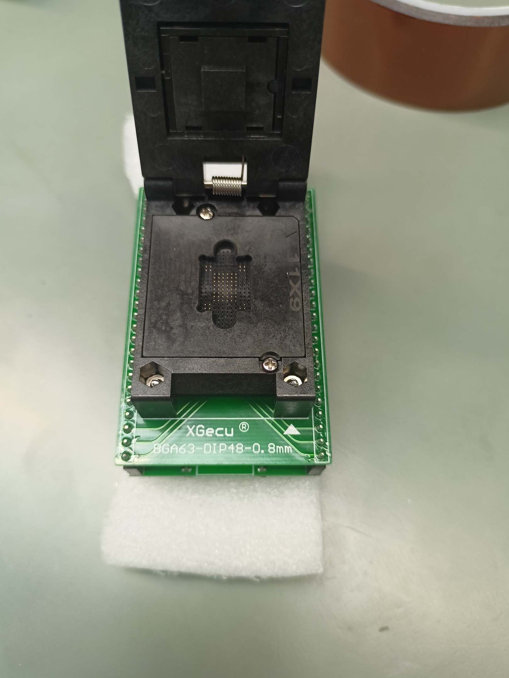

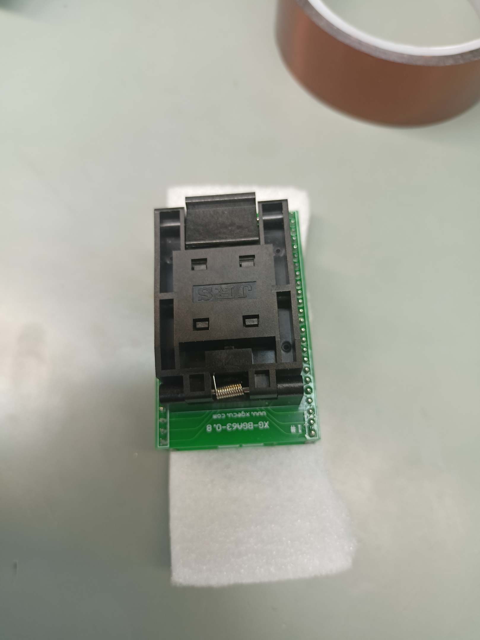

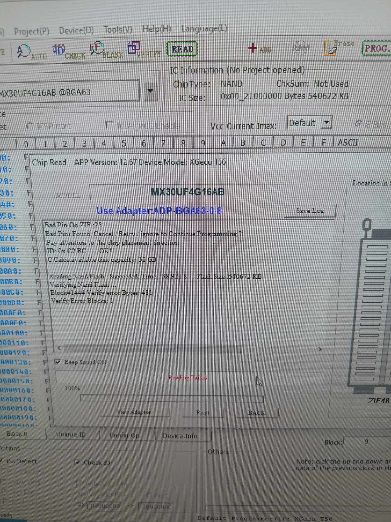

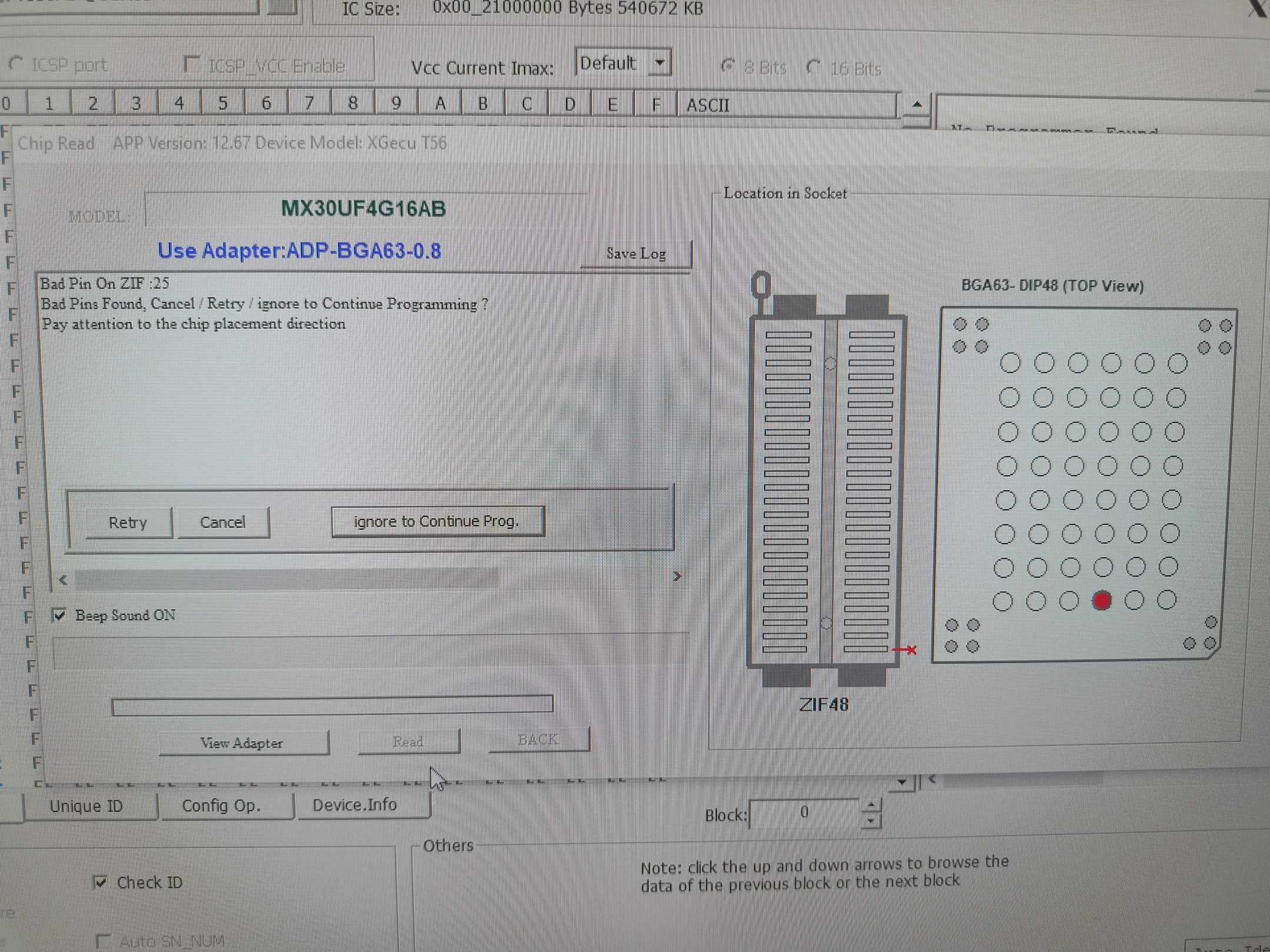

Mx30uf4g16ab contact error when reading the entire FF dump the chip is not empty
T56 Contact error when reading the entire FF dump the chip is not empty. Another programmer reads the chip
what to do? All dump FF

                   Try latest known software HTTPS://www.hklrf.com/Downloadfile_59.html ,
with some corrected ICs. Why? You got one error with one address lines, you should got
multiple errors....
Anyway, if not help, please post your adapter, clean it ( just in case), if adapter socket is removal
capable, clean everything. No Good? Wait as T76 is almost out and a new software will appear.The IC used maybe have bad sector...
