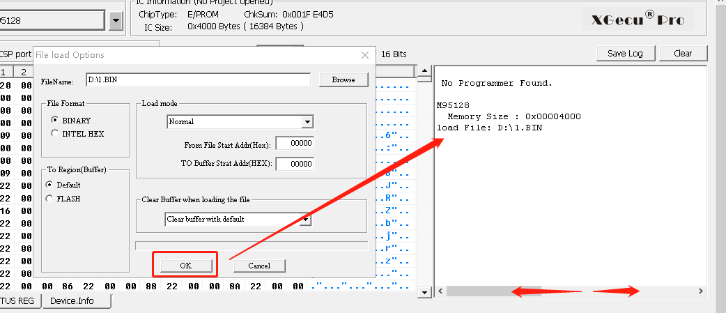

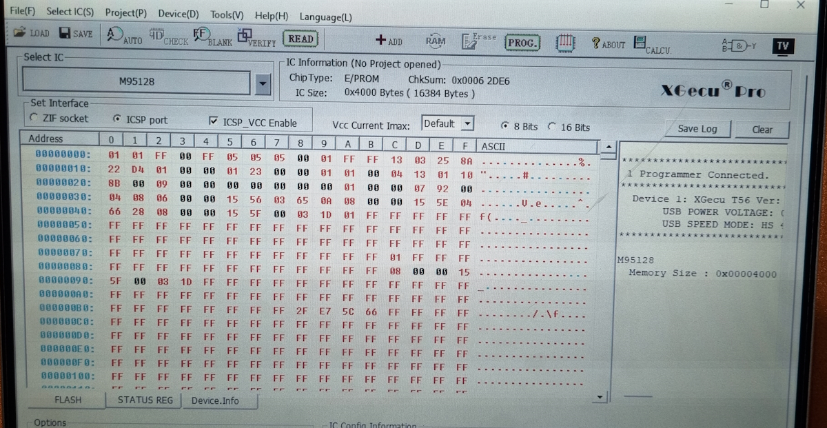

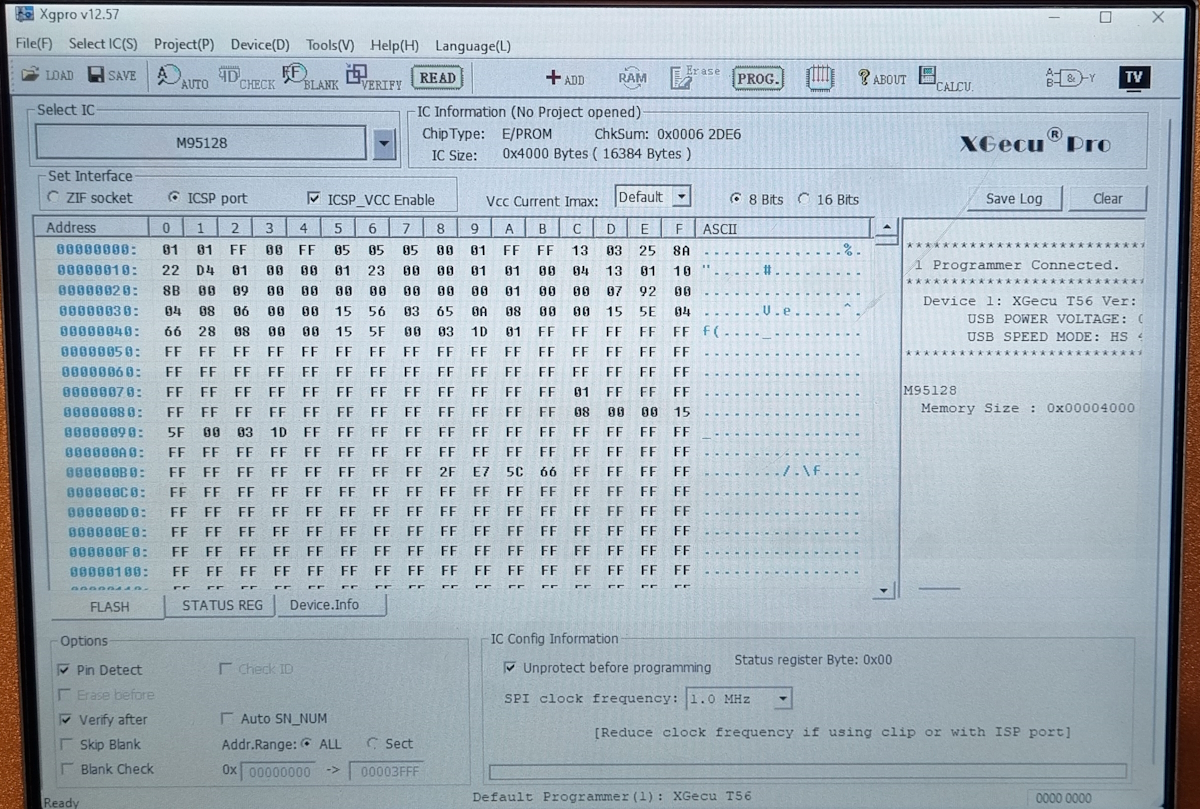

Tested the T56 programmer today and it worked very well.I found a few small issues with the interface though.
In 1024 x 768 resolution, the screen does not fit correctly, the log is not totally visible.
Also, if you verify a read and it does not verify correctly, it will correctly mark the dump in red.
If you re-verify the dump and it is correct, the red errors in the dump are still visible.
It would also be good to be able to see what file is currently loaded, there is no indication of this.
I had to re-load dumps just to make sure I had the correct file before writing.
