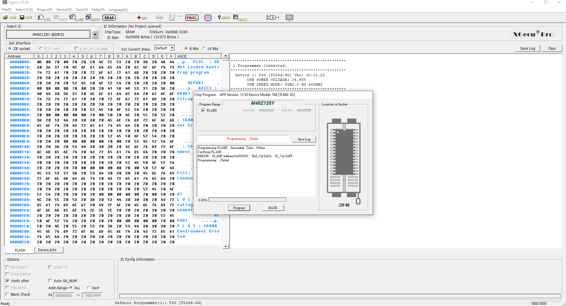

I can't write M48Z128Y-85PM1
Программатор T48, Xgpro v12.50. Не могу написать M48Z128Y-85PM1.
Ошибка записи адреса 0x000000.
2025-3-15
发表于 2023-2-19 17:03
Alex03
There is a battery inside the chip. If the battery is dead, it cannot be burned.
This battery is a common problem. Try a new chip
