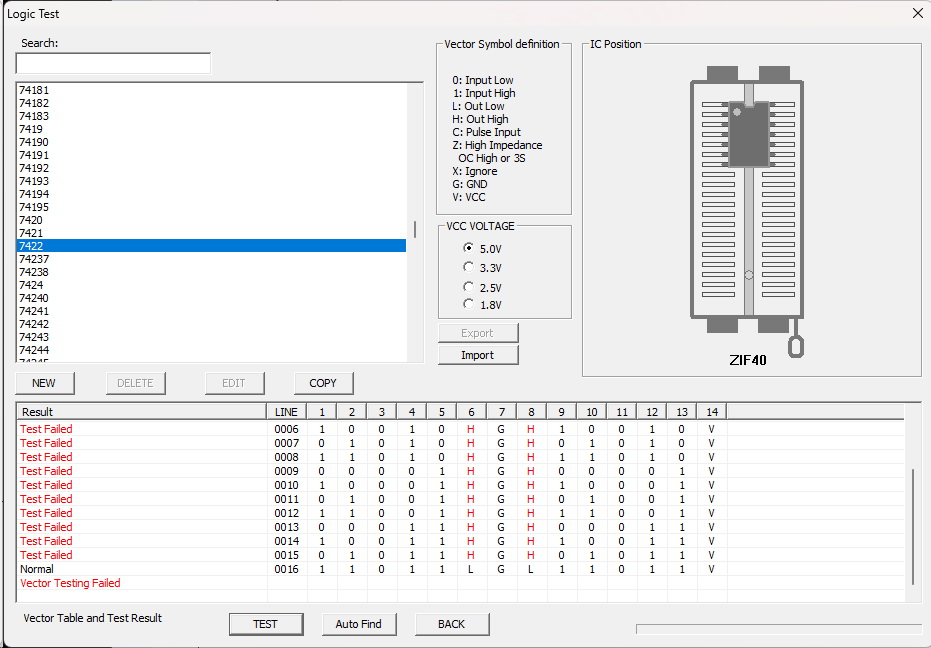

Hello.

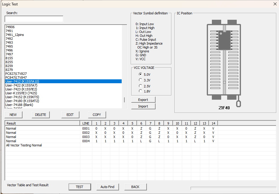

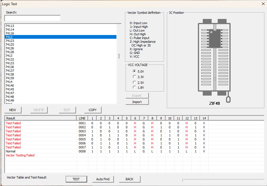

I want to share my logic tests, which are not in the programmer or are, but with errors..7412 (Russian К155ЛА10) - bad test in programator, instead of (High) - it is necessary Z (open collector)
2022-11-7 02:00
2022-11-7 02:00
7412.lgc (2.15 KB)

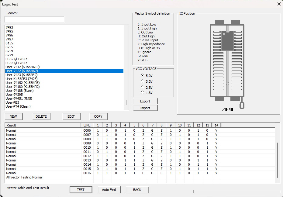

7422 (Russian К155ЛА7) - bad test in programator, instead of (High) - it is necessary Z (open collector)
2022-11-7 02:06
2022-11-7 02:07
7422.lgc (2.43 KB)

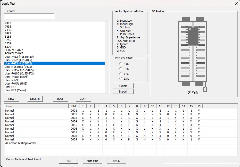

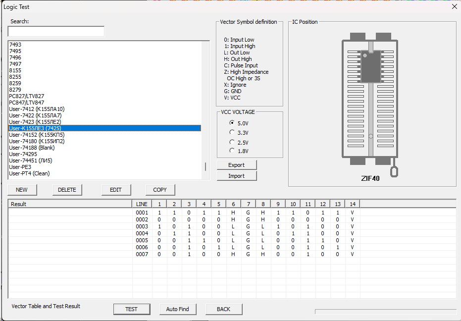

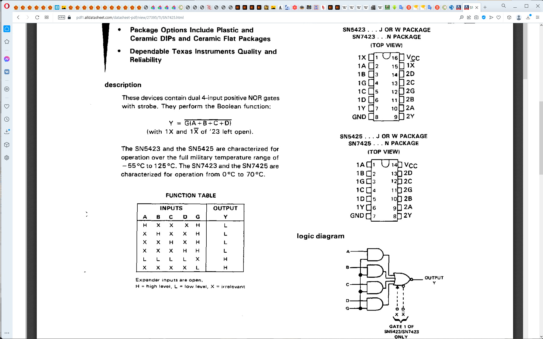

7423 (К155ЛЕ2) & 7425 (К155ЛЕ3). 7425 bad test in programator, the microcircuit has 16pin, not 20pin.
2022-11-7 02:16
2022-11-7 02:17
2022-11-7 02:18
7423.lgc (2.27 KB)
7425.lgc (2.22 KB)

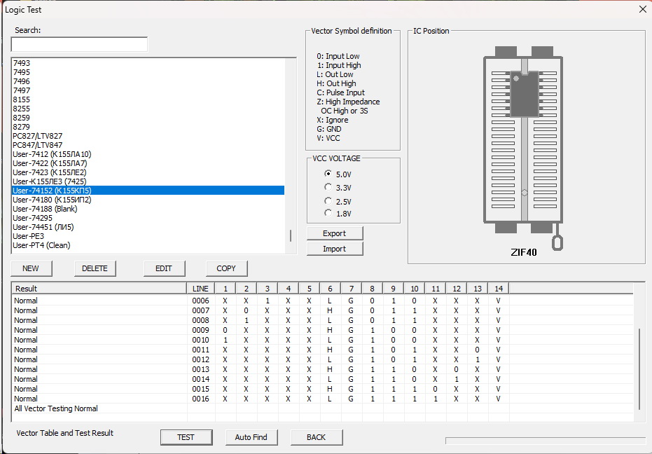

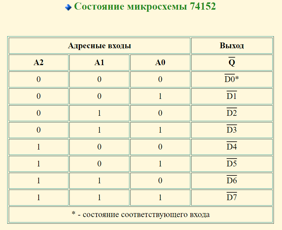

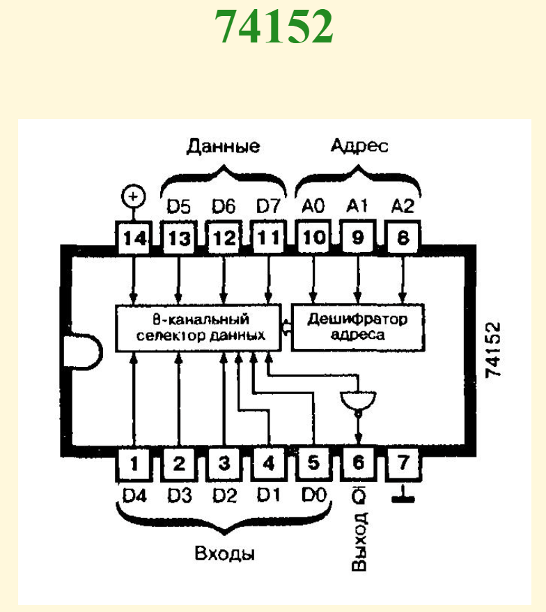

74152 (К155КП5)
2022-11-7 02:23
2022-11-7 02:23
2022-11-7 02:24
74152.lgc (2.43 KB)

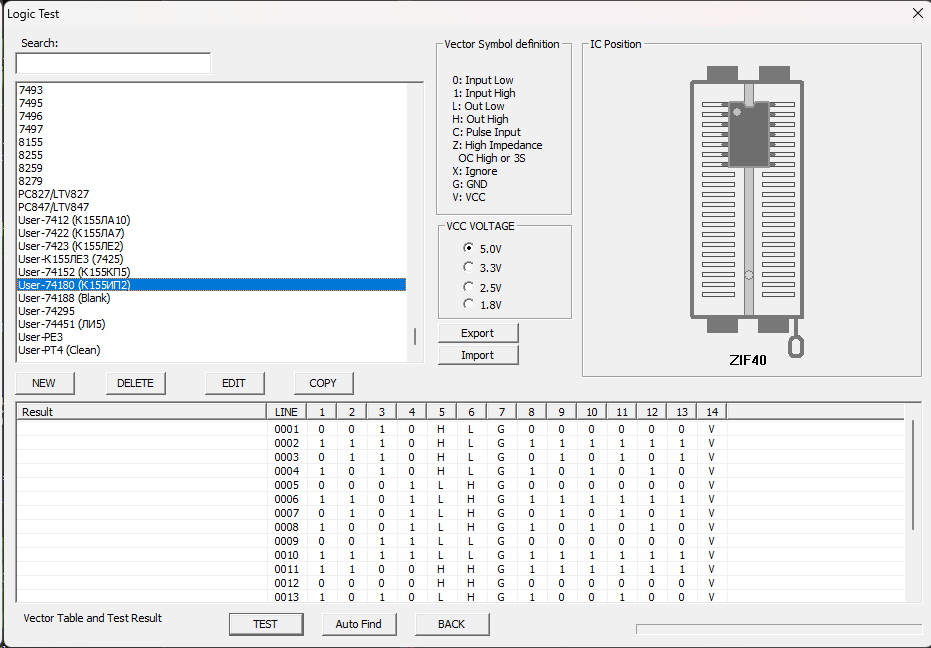

74180 (К155ИП2)
2022-11-7 02:27
2022-11-7 02:27
74180.lgc (2.48 KB)

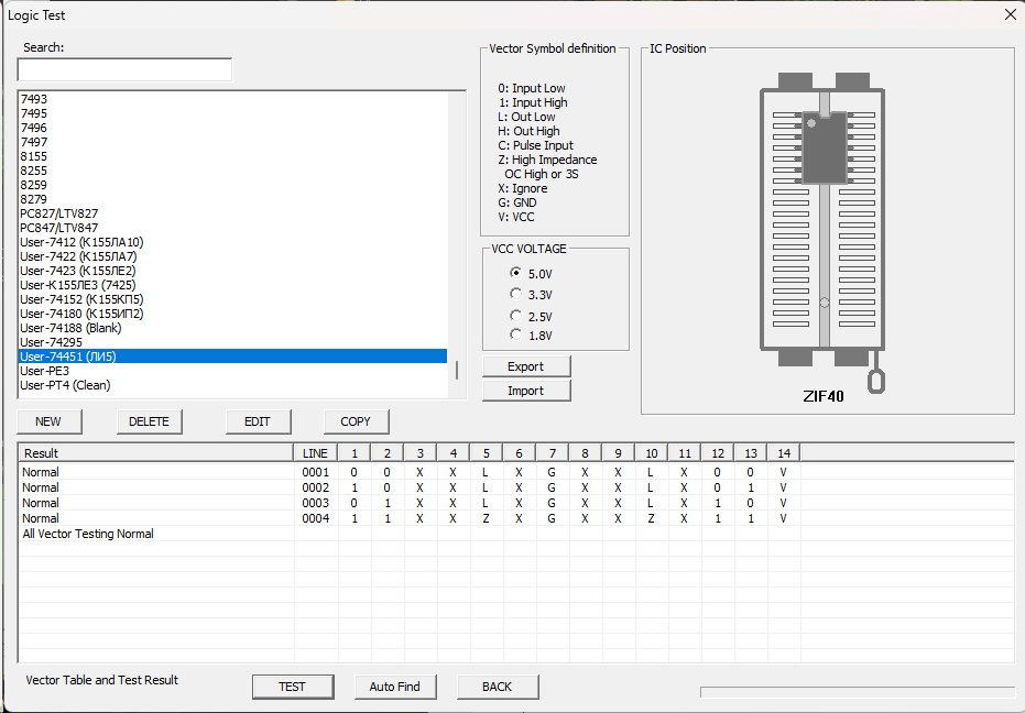

74451 (К155ЛИ5). Open Collector
2022-11-7 02:31
2022-11-7 02:32
74451.lgc (2.15 KB)
