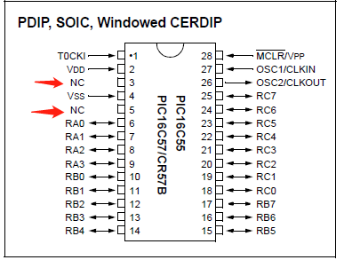

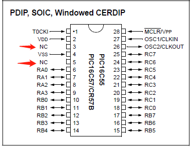

When I read a PIC16C57 I have error PIN 3 and 5 are not connected.
On my TL866II the PIC16C57 works without any problems.

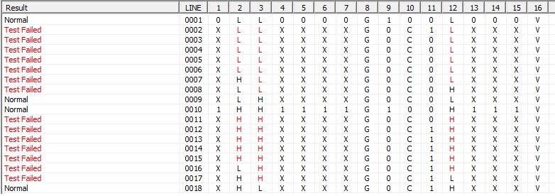

When I do a logic test on a CD4021, the chip is not recognized by the T48.
When I do the logic test with CD4021 on my TL866II, it works without problems.

1.PIC16C57 Pin 3/5 is Not Connect,  can not be detected . you can disable [pin Detect] in Options.   T48 Pins sets of PIC16C57 is wrong. will be fixed in next version.

2. Please you upload a picture of Testing 4021. (not AUTO FIND)
1. PIC16C57:
I disabled [pin Detect]. Then [Read] the data of the chip with my TL866II and with my new T48.
Problem, the hex data read out is different between the TL866II and the T48. Which one is bad?
2. HEF4021BP:
2022-11-5 01:36
回复 3# mvlc
    CD4021.lgc (2.48 KB)
4021 fixed .
import this file.

Thanks for the 4021 solution! It's working fine.
