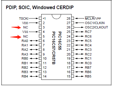

When I read a PIC16C57 I have error PIN 3 and 5 are not connected.
On my TL866II the PIC16C57 works without any problems.

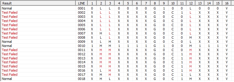

When I do a logic test on a CD4021, the chip is not recognized by the T48.
When I do the logic test with CD4021 on my TL866II, it works without problems.
