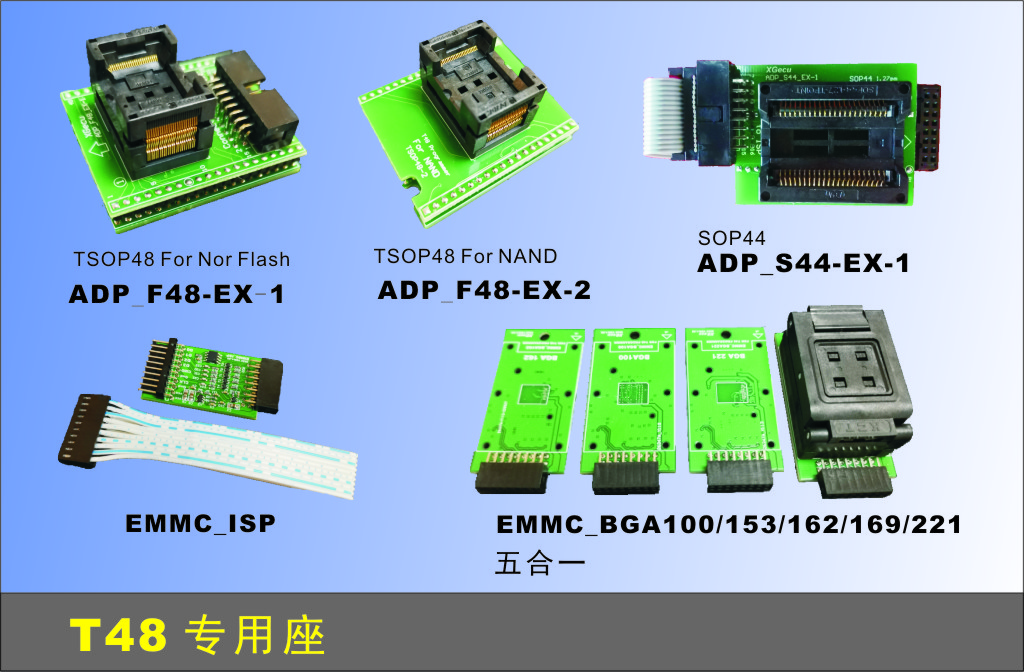

APP Version : 12.50   Model : T48
Device : AM29F400BT  @SOP44
No Adapter Found,use: ADP_S44_EX-1
can i use the red adapter to program this chip. Or is it possible to change it somehow?
回复 3# LiCeMeR
Due to a completely different design method, it is not possible to use early adapters with more than 40 pins.
回复 4# admin
    Then maybe you can give a diagram of connecting this chip AM29F400BT to the ISP
