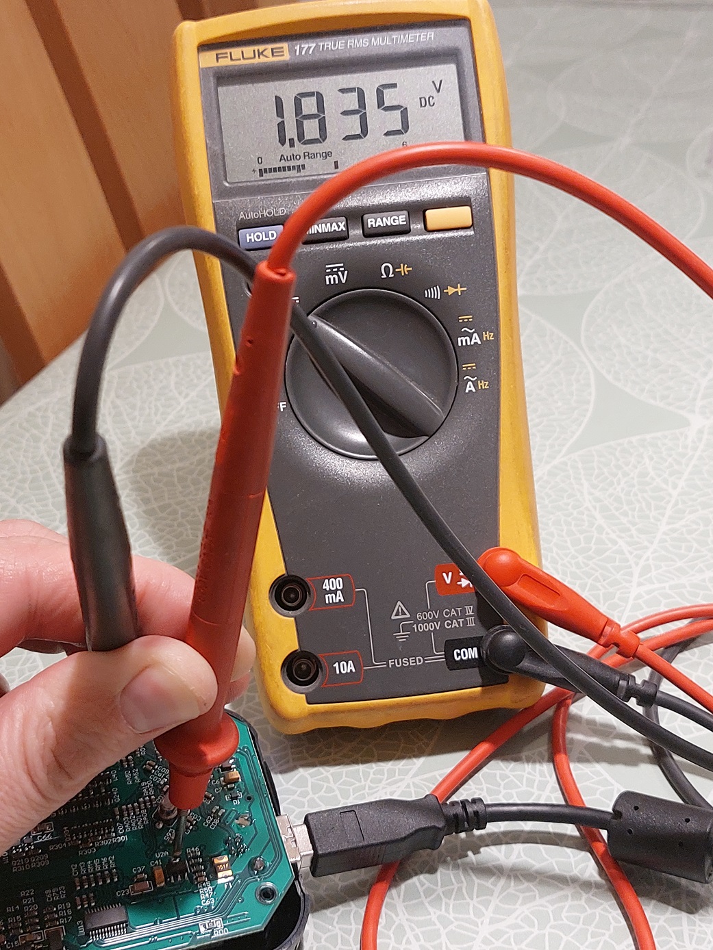

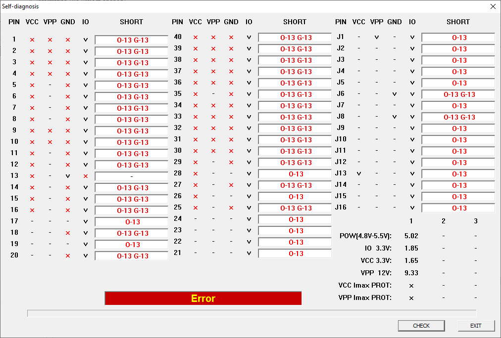

Dears,I bought original T48, use the newest software and firmware, but it not working at all, video shown below, that it aren't able to write simple memory (24C32W):
https://files.fm/u/xk2xb7je5
I try to read and write the same memory with the same socket on my cheap programmer EPZ2019+ and it working without any problem.
Could You help me ?
self test failed

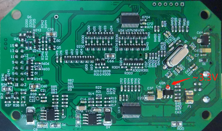

open the box . Test the voltage as picture.
2022-10-29 09:08
it 's normal about 3.25-3.35(3.3V), otherwise , Please replace the LDO  AMS1117-adj (Package:SOT89) .
Thank You for quick response and proffessional support.Yes, voltage is 1.8V instead 3.3V.
I will order LDO.

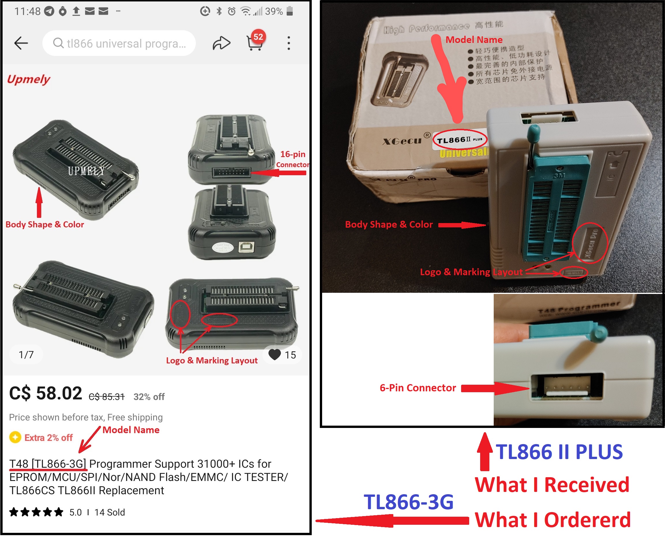

Please someone kindly help me:
I ordered a T48 [TL866-3G] from a seller via Ali-Express, But what I finally received, Had been Labeled as TL866 II PLUS and the device has a complete different body shape, Body Color, Logo & marking layout, and Connector .
2023-6-9 12:47
Please kindly tell me if I received the correct "3rd Generation" or they have sent me a wrong item.
Thank you so much, with kind Regards
回复 55# Shahram-K
   The picture on the right is not T48
