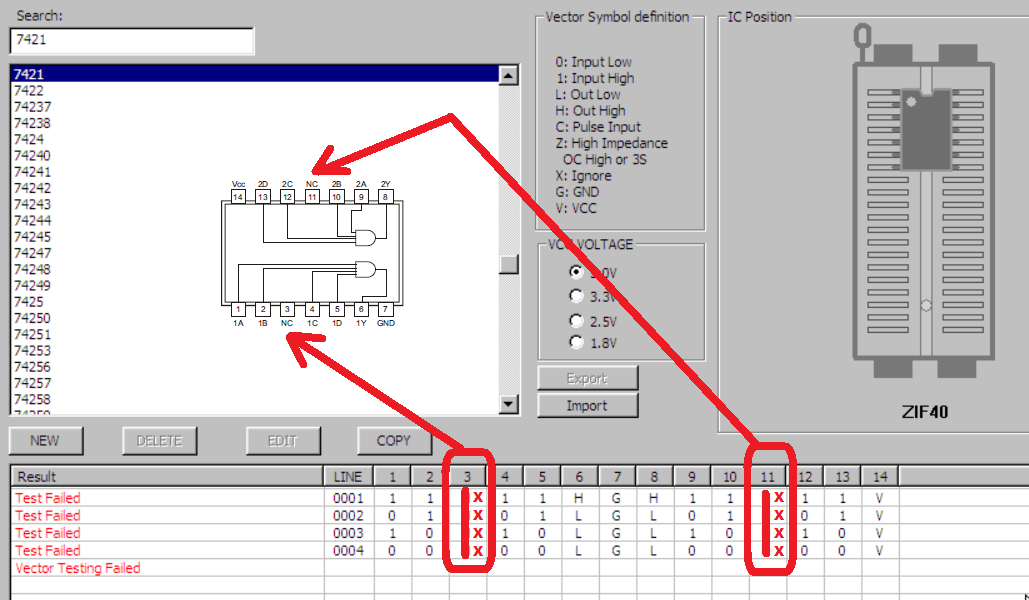

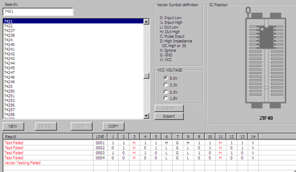

74LS21 fails with TL866
Testing a known good 74LS21 fails with  TL866II-Plus App Ver 11.90
回复 1# gmc
   Please post a screenshot showing the erroneous test.
I can already see the screenshot, it hasn't displayed for a while,

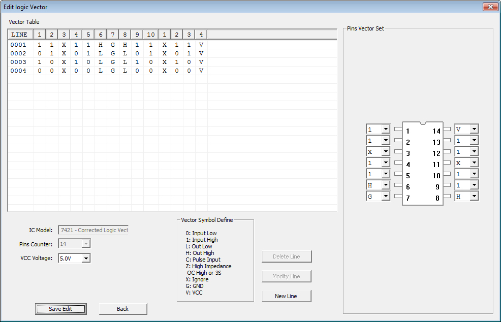

Yes this logic vector is wrong, because pins 3 and 11 are unused/not connected (NC), so instead of expecting the value "H" (TTL logic level high/logic value "1"), there should be an "X" there as shown. In some time this vector should be corrected. Thank you for the information.
7421 - Corrected Logic Vector.lgc (2.15 KB)
