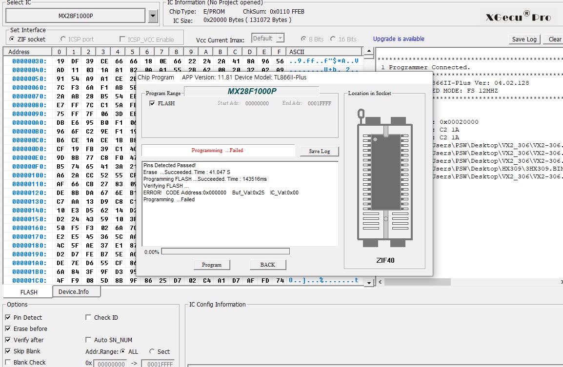

» [solved]mx28f1000p programming failed plz help me!

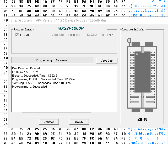

my chip was bad. programming has done well

As an user...It looks that you are running 11.81 version of Xgpro app. Have you tried to upgrade to 11.90 ? Sometimes, bugs are corrected even for already supported ICs...
Download Newest XGecu T56/TL866II software(下载最新软件) - 编程器使用与软件下载 - XGecu Programmer Forums - Powered by Discuz!
Hope it helps, or not :-(

Bad pins connect? or bad chip.
why you disable <Check ID>?
