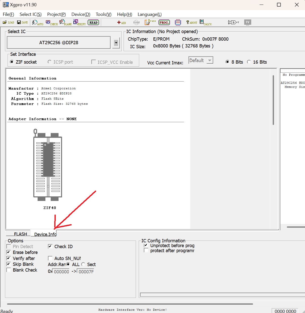

Hi,Thank You for great device :handshake
Is there support for bios chip Atmel AT29C256 @ PLCC32?
App Software Ver: 11.90

As an user.... You may have already the adapter needed
Adaptador de adaptador plcc32 dip28, adaptador de soquete ic para tl866a tl866cs tl866ii plus ou outros programadores universais|Calculadoras| - AliExpress
Selecting the DIP28 Version, using this adapter, and in Xgpro APP , select 'device info' , insert pin 1 and 28, on top

AT29C256 datasheet (datasheetspdf.com)
Hope you have the adapter, and this little trick, you now know. The Jumper, as the IC is 5V,
should be there.
Hopefully, it will work for you  :)

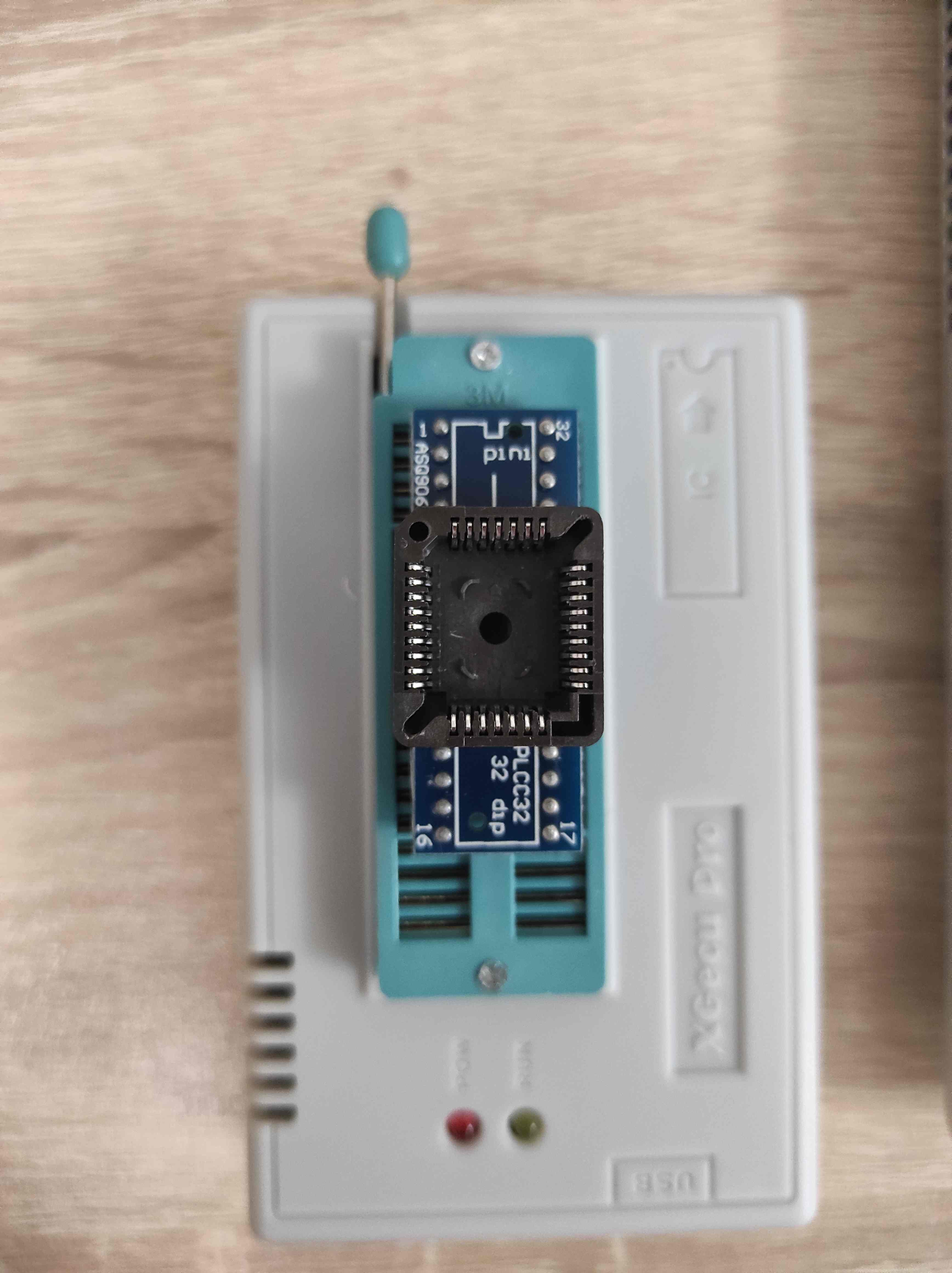

I have ASQ906 - PLCC32   adapter and did try with dip28 version but it did not work.
No jumper on my adapter?
Adapter is ASQ906 no jumper, Your is ADP-006.
So I need another adapter, thank You!

Use a special adapter:  PLCC32->DIP28
No jumper on m ...
apofview 发表于 2022-3-8 04:14
    As an User.....  The answer is yes, but it's a 'pain in the neck' not a single pin will remain in place, and the modified adapter may not work because of length of wiring, and the new adapter is less then 6
Thank You for info and for link.:handshake Shipping to my country is 35 euros.Did write to few sellers to add economy shipping option.

   I've found you in the badcaps forum , and indeed, the amount of money for mail to your country. I can send you my adapter, but i need your info how about your country threats EU countries mail
if i send you it?
Thank You for Your act of kindness :victory:Xgecu official store responded under a day, and on aliexpress store added free shipping!
Adapter ordered.
