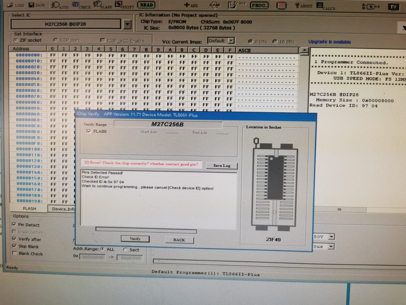

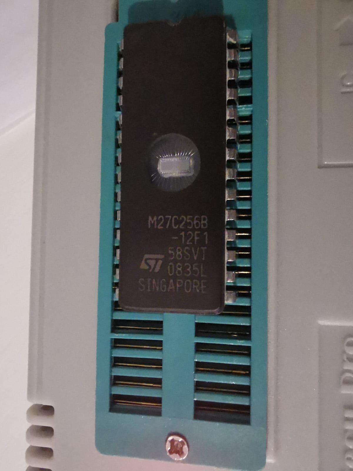

hi , i've problem  with   my XGecu TL866 plus II
i can't use   ST M27C256B-12F1
Error Log
------------------------------------ID ERROR! Check the chip Correctly? whether contact good pin?
APP Version : 11.71   Model : TL866II Plus
     Device : M27C256B @DIP28
Pins Detected Passed!
Check ID Error!
Checked ID is:0x 97 04
Wish to continue programming , please cancel [Check device ID] option!
I choise the ST  M27C256b  but i can't read, or check   or proge,   This is normal ???
il the  Chip list ,    ST M27C256B @Dip28 are listed.
Thqnks for help.

回复 1# fixoid
   ID: 97 04 is SMJ27C256.
ID ckeck can be disable.
