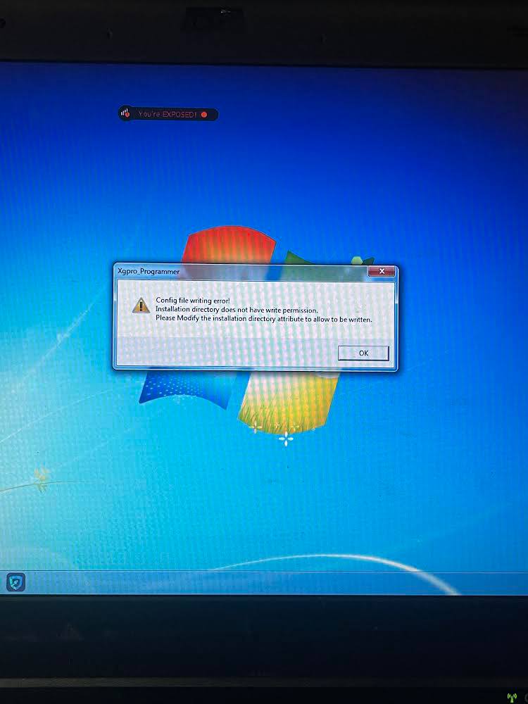

tl866II plus install failed config file writing error
config file writing error please help

I really don’t know how to explain the problem further,
The prompt is already very clear.
try to install on other logical disks (D: E: F!

        As a user...Sometimes , problem is related to a certain user in the machine,
To avoid problems, copy the setup file to desktop, unzip it, and right click, and do the setup
in admin mode (run as Administrator). Try it :-)
hi mate it's still not work
