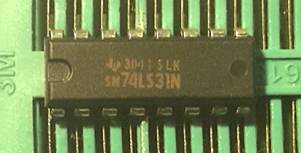

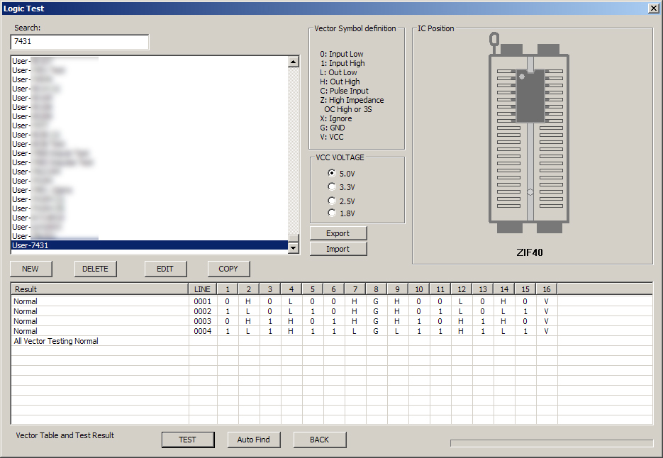

The test was performed on the SN74LS31N (Signal Relay) chip from Texas Instruments.
