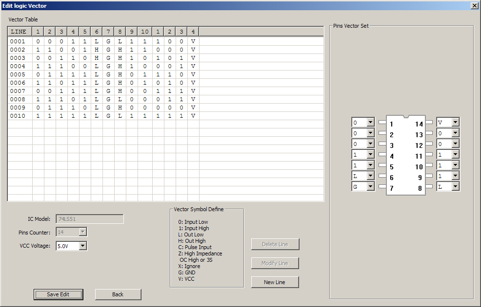

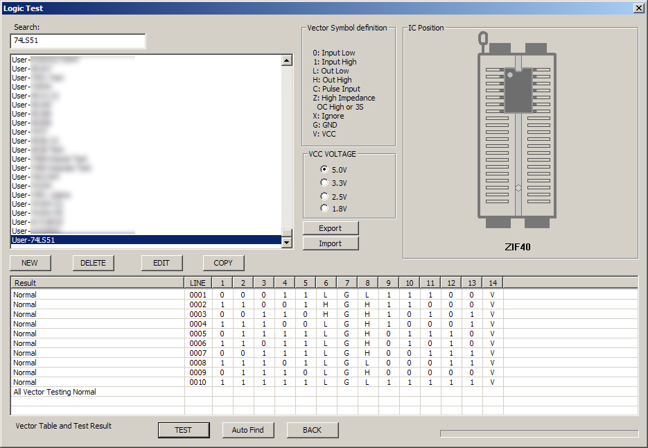

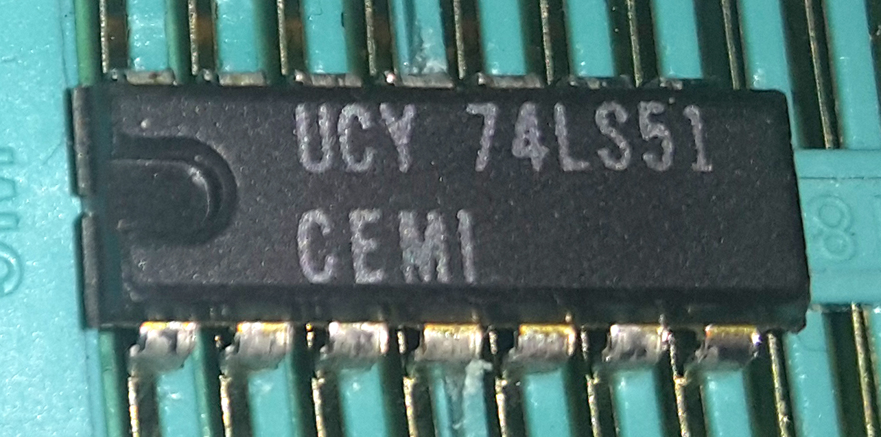

The test was performed on the UCY74LS51 (Dual 2-Wide 2-Input, 2-Wide 3-Input AND-OR-INVERT Gate) chip from Unitra CEMI (Poland).
