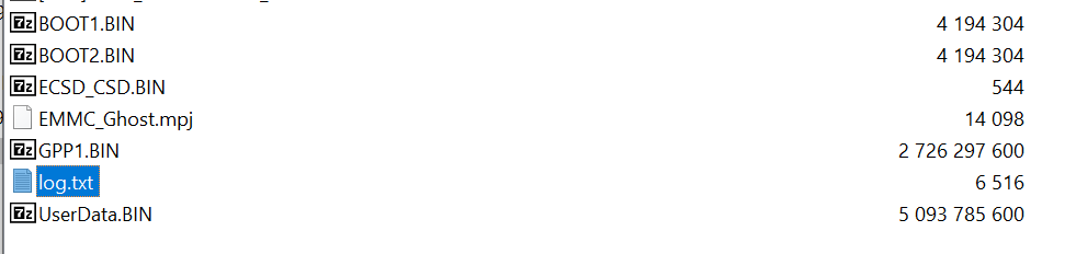

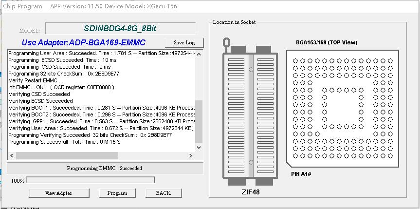

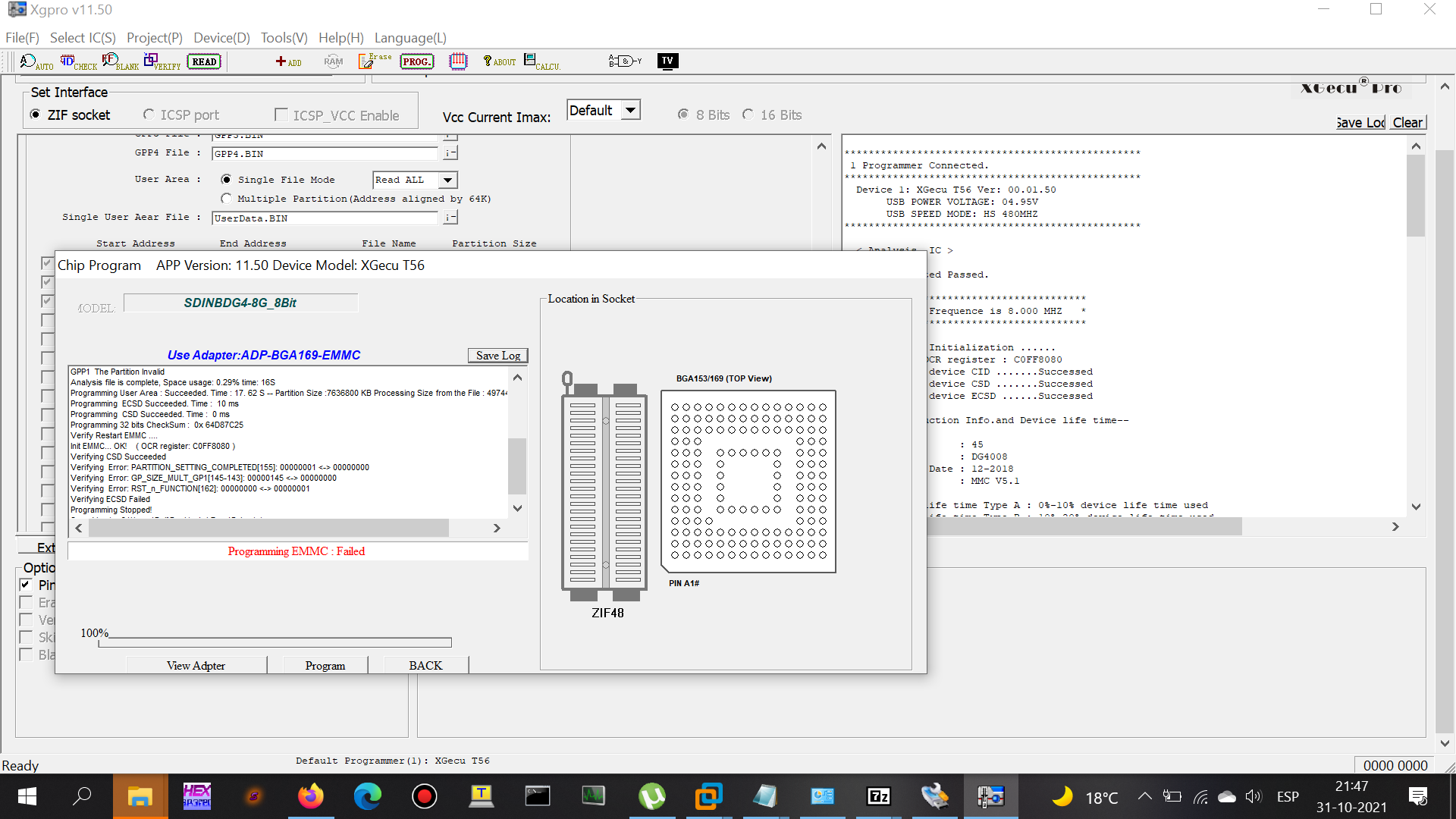

It turns out that I need to clone an emmc sandisk sdnibdg4-8g that has Gpp1 configured with 2gb, I can read it without problems but when I generate EMMC_Ghost.mpj to write a new emmc sandisk this gpp partition is not written, it just copies boot / user partitions.
I make it clear that the emmc to write is new from the factory and of the same model, it does not have the Gpp areas previously configured, I understand that the gpp partitions are programmed only once and cannot be reverted [/ b] |
