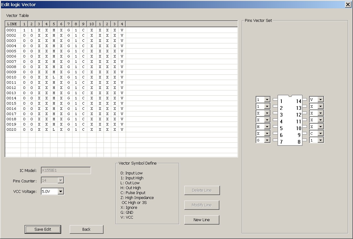

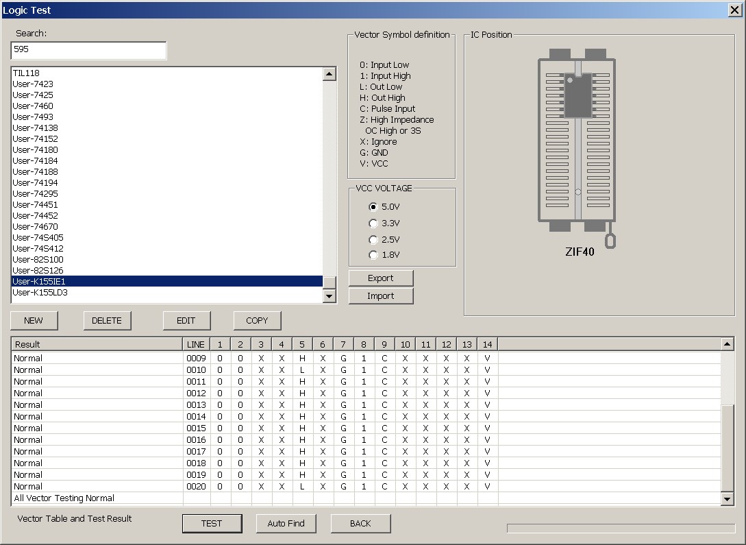

New Logic Test - K155IE1, K155LD3 Vector Table
K155IE1
K155LD3
The test was performed on the K155IE1 (
DECADE COUNTER
(148.33 KB)
2025-8-19 03:33
(152.2 KB)
2025-8-19 03:33
K155IE1.lgc
(2.53 KB)
下载次数: 1766
2025-8-19 03:32

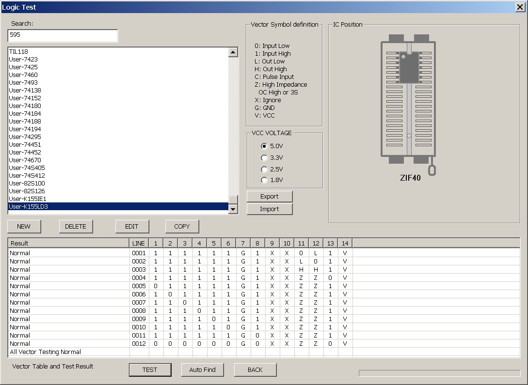

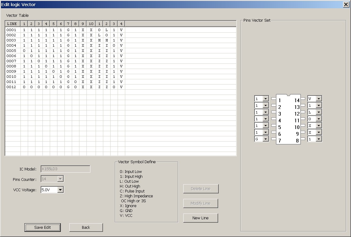

The test was performed on the K155LD3 (
8-INPUT EXPANDERS
(123.77 KB)
2025-8-19 03:33
(148.21 KB)
2025-8-19 03:33
K155LD3.lgc
(2.34 KB)
下载次数: 1725
2025-8-19 03:32
