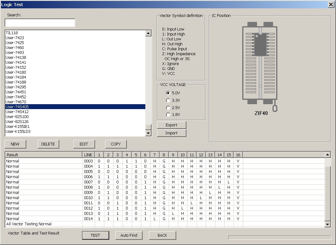

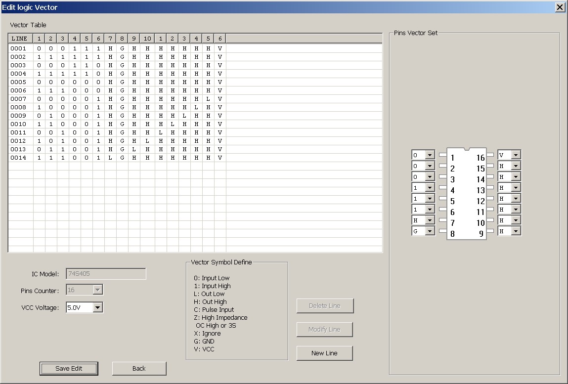

New Logic Test - 74S405, 74S412 Vector Table
74S412
74S405
The test was performed on the UCY74S405N (Dekoder binarny 1 z 8):

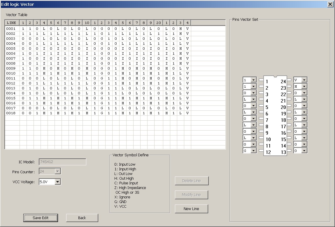

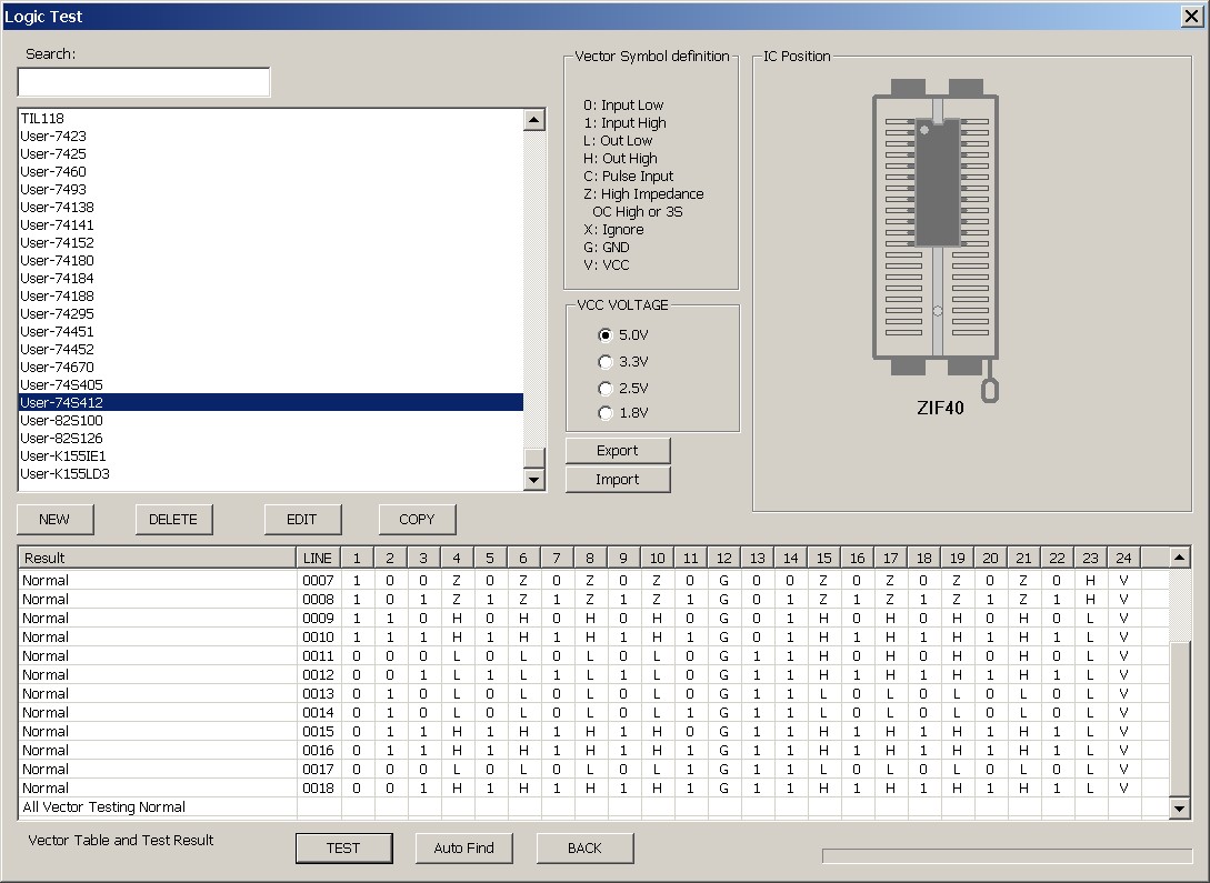

The test was performed on the UCY74S412N (8-bitowa brama We/Wy):
