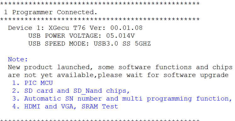

Albano.Matos 发表于 2025-1-4 21:46
   New T76 -12.77 software version is out....still improving before i receive unit.
New features are added by flashing firmware, now at version 1.05. They are working fast
as promised by 'Blue text' in the adds. Pdf manual still in the works, but T56 manual still
have most features use described. Latest chips with 512GB , like GD25LR512xxx,
still missing, hopefully they will be available soon. Unfortunately, some AVs continue to
give false positives, and complain about available software. I've not tried to update Xgecu
app, direct from app. I'll try next time but with programmer disconnected, to see if it works
without popups. It works fast :)

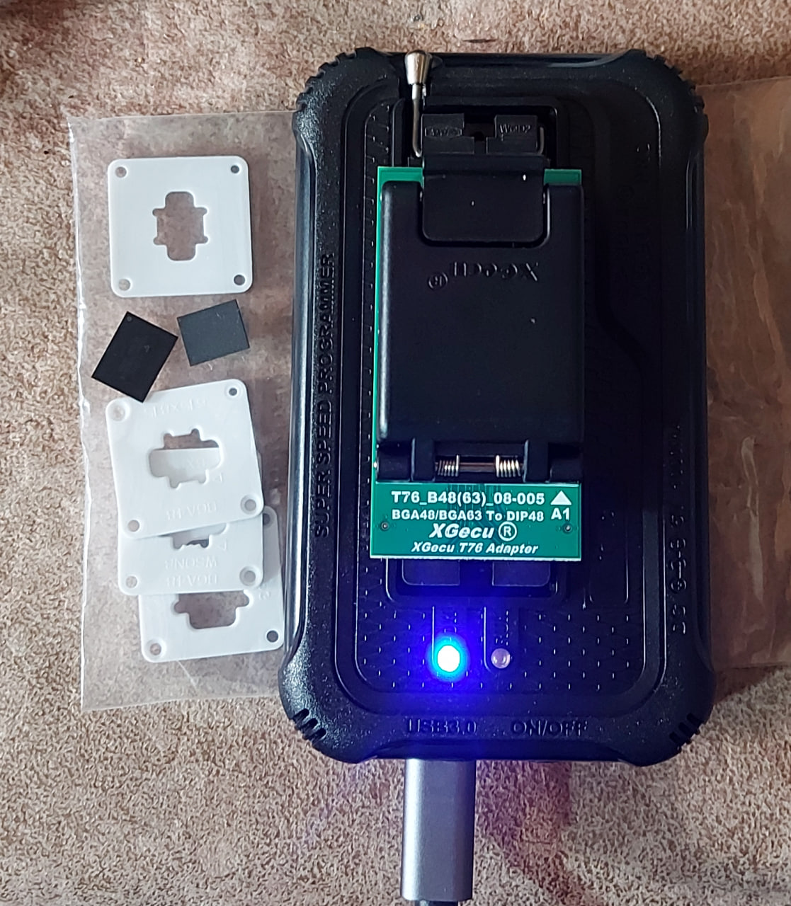

Albano, hello, today I finally got my new t76, I didn't expect the case to be two-colored, I would have taken it in a brown case)). I will compare it with my t56, which I mainly use for nand chips and flash memory. I hope that they will add the ability to work with super I/O controllers, as well as with chips, errors for which users encountered

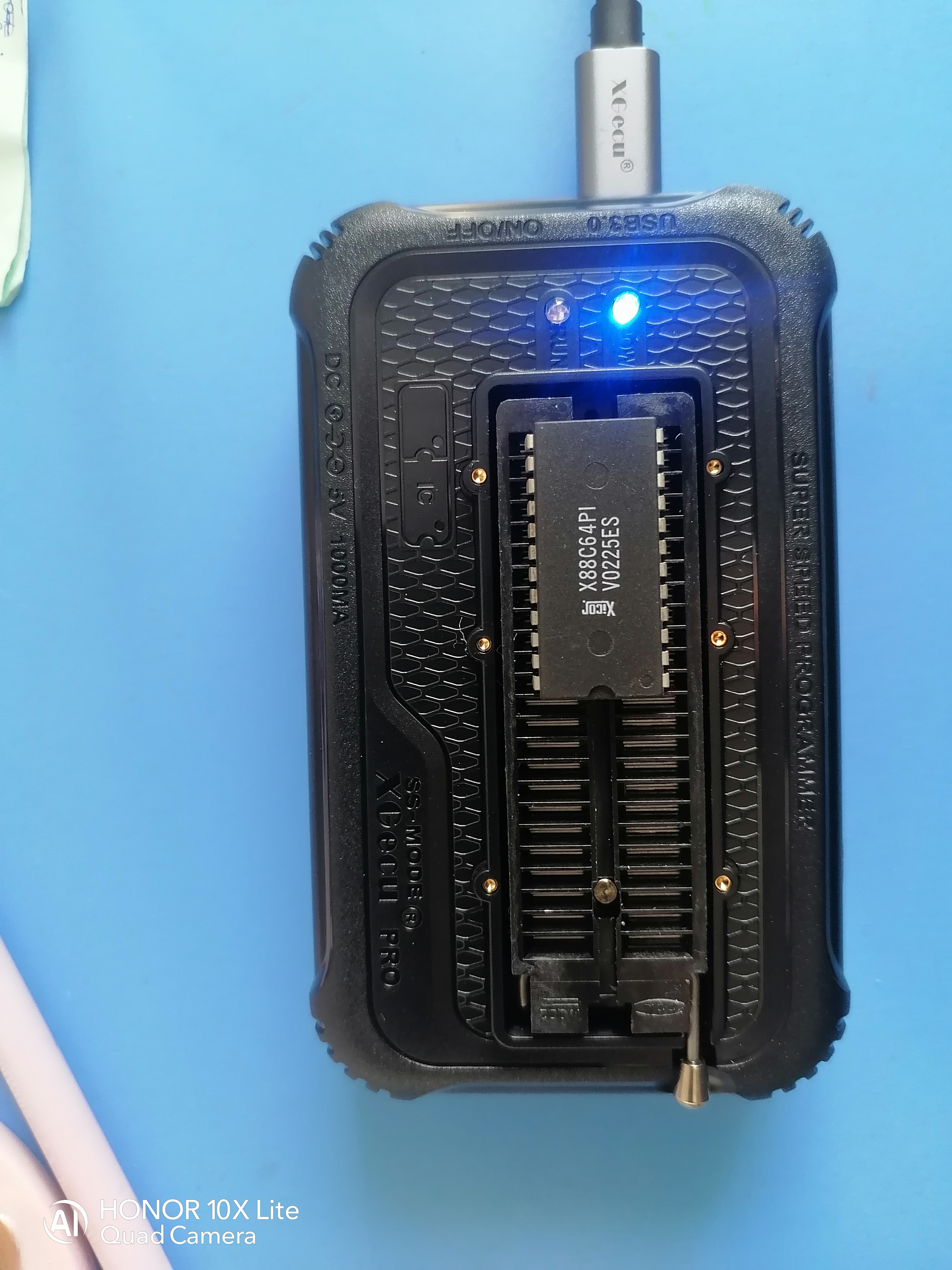

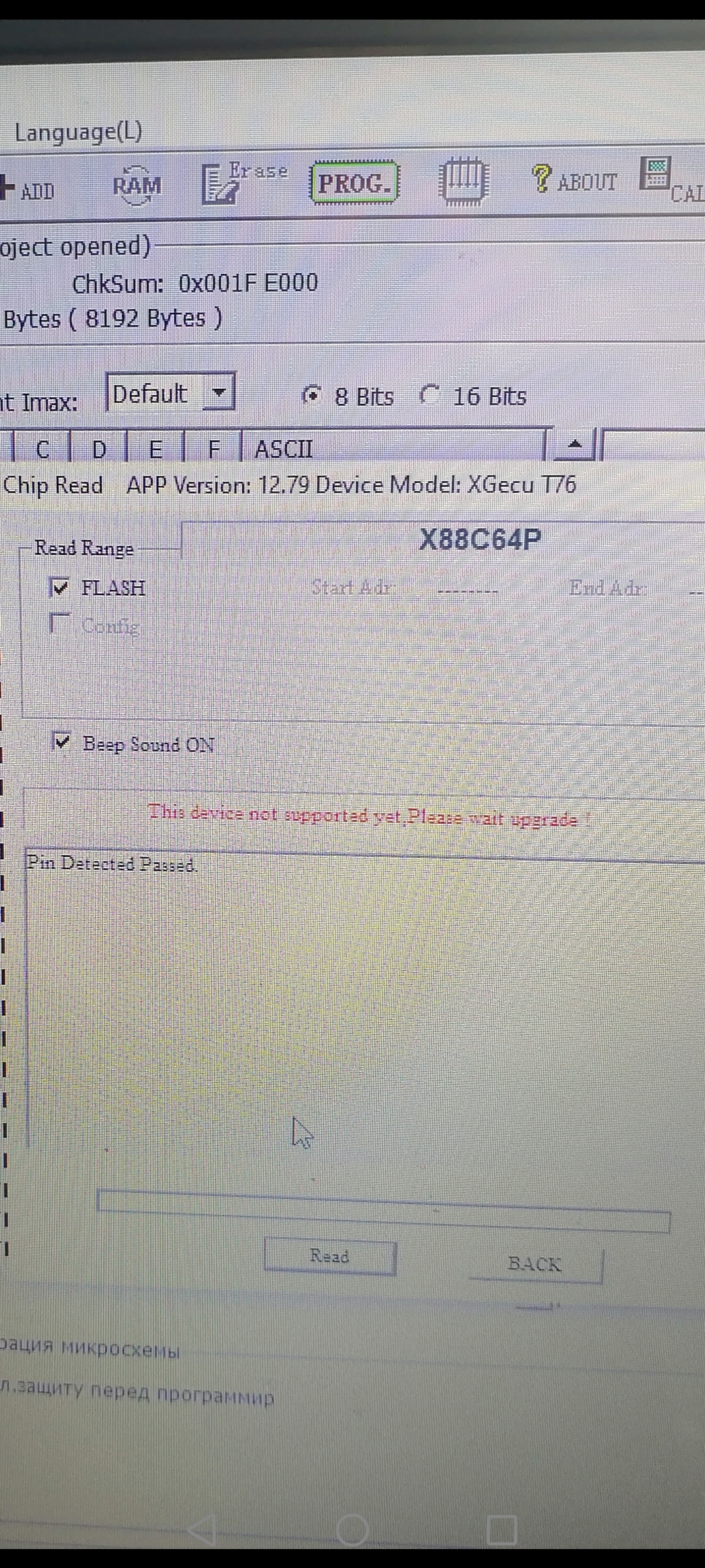

Hello. I bought a T76 progromator, it's very good. Please add the x88c64pi chip to the support list. I wanted to destroy the microcircuit, the programmer is asking for software updates. I will be very grateful to you. I've tried programming a few microcircuits.
2025-3-5 13:18
quote]Hello. I bought a T76 progromator, it's very good. Please add the x88c64pi chip to the support list. ...
Evgeny 发表于 2025-3-5 13:28 [/quote]
   Hello,           All of us  waiting for development. Until new version , with new support was out,
maybe with new firmware version, we must wait. So far, you can see what's in the works, and
what's missing from plan, with BLUE printing from page Haikou Xingong Electronic Co,Ltd
Adding new ICs also important, but many old ICs need support to be completed before,
hopefully, works like the one you need.
2025-3-8 14:42
I'll wait
I'll wait

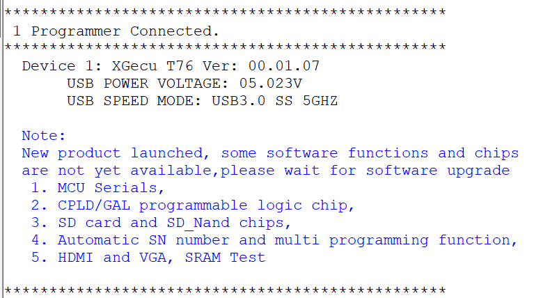

           Software 12.85 , only for T76, is out for use. Ive noticed they removed SRAM chips in the previous list,
as support still in 'BLUE PRINTING', they also published the List of Supported ICs and 88C64 is there. Only testing
to see if it works now for you. Firmware was updated to 1.07, number of ICs in the list is now a bit above T48 in
number, but some features of T48 not available in the T56, still in the works, then the list will have to grow a lot
in the future....just wait, they are working, it seems, to get job done a.s.a.p.

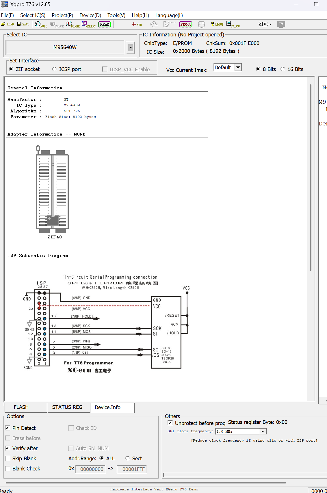

.If you need to setup any external connection, select the IC, then near the bottom, select Device.Info tab, it
will display some information how to connect. You can also display, bigger images of those images, if you
browse the IMG folder, inside the application folder . There, you can also see previous programmer images,
as they also be used in some occasions.

The T76 native adapters, are showing up, first BGA64 from 3 to 1, compared to T48, BGA48-63 now
also, so far, with only one adapter only, Big saving for some of us, BGA 153-169 and BGA221, hopefully,
like the T48, expected to sell in groups of at least four, with BGA 100 and BGA162. Anyway, a wish like
with the 'Medusa ProII' programmer, some new Chip formats with only one adapter, to save money, at least to
some of us.

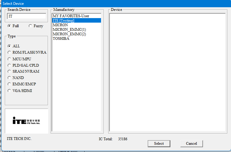

Why support for all ITE chip had been removed in the v12.85 version?
Chip list is empty
Test 发表于 2025-4-3 07:41
   Hello,            Just guessing, but, as you know, T76 and T76 Software, are at the moment,
a working in progress project. The same was appended for SRAM chips, maybe also
other ICs, the support wasn't complete yet and errors still need to be corrected, as
well firmware need to be updated, in the ICs support list they write, ITE -> TESTING..
Xgecu gave 2-3 month preview time to complete all, but like all previews, are just previews,
and the project will take a little longer, hopefully...
For more professional computer repair works, people complement with the use other programmers
like SVOD4, or even more expensive ones, with dedicated and specialized hardware, but hopefully, T76 will do some
of that work in the future. Simply...to do it all, time is needed for development, and sell many to cover costs, till
then we must wait, future path isn't free :'(

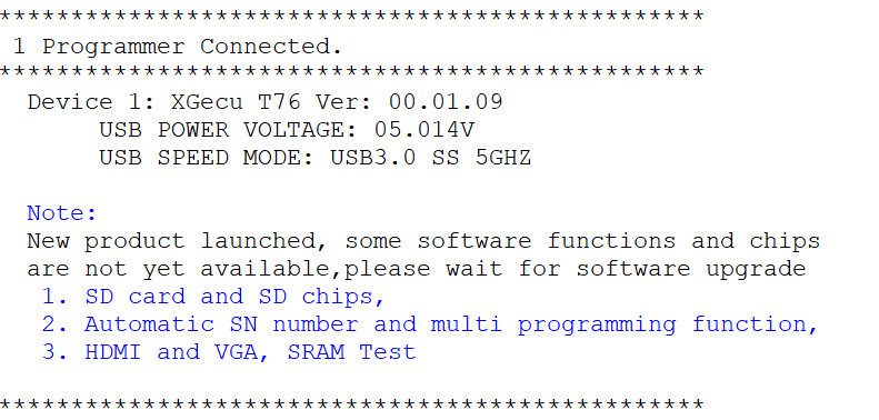

   Hello,            Today Xgecu software was updated for all latest devices. T76 (12.89)  setup grow up near 3MB in size.
ITExxxx reference disapear from list, firmware updated to 1.08, and welcome message is new, now say in 4 steps, previous 5...
2025-4-10 12:25
User manual still is at T56 level, but not much difference needed so far :-).

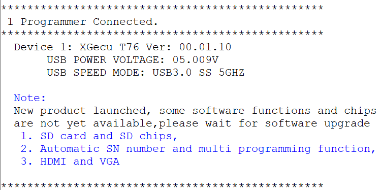

   Good News, new T76 only software version is out. 12.95
6. Fixed some known BUGs
It seems that page Haikou Xingong Electronic Co,Ltd Blue prints, are already outdated.
Hopefully, get it done, message in app is now:
2025-7-15 12:20
T48-56-TL866II-12.90
T76-12.95 (firmware from 1.09->1.10)
T76-----.38540 from 38319 from 36111 from 35186  ( T76 ICs List and software available at xgecu   )
Some new announced adapters, only for T76, but none seen yet available for sale, but most ICs can use 'old' (previous) adapters, but at slower speeds.
For first time, number of ICs supported by T76 is bigger then T56 :)
More news as soon as they are available.

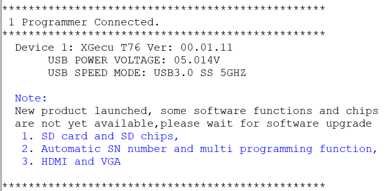

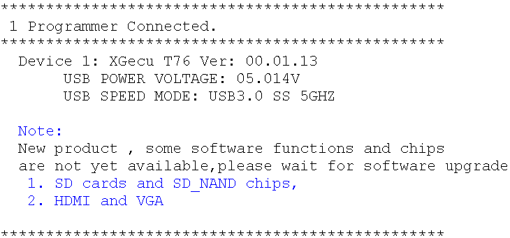

V12.97 for T76- Lists  and software will be here shortly xgecu.
Now at http://www.xgecu.com/MiniPro/xgpro_T76_V1297.rar , and the list at
http://www.xgecu.com/MiniPro/T76_List.txtFirmware now at 00.01.11 level
1. Added support for over 100 chips
2. Fixed a major bug in the previous version
3. Fixed some other known bugs
2025-8-19 21:04
Supported Chips:
TL866II-.19326 from 19272 from 19023 from 18991
T48-----.35969 from 35779 from 35267 from 35138
T56-----.38783 from 38537 from 38062 from 37906
T76-----.38649 from 38540 from 38319 from 36111 from 35186

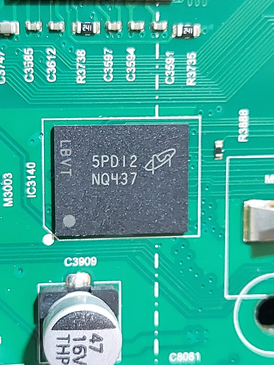

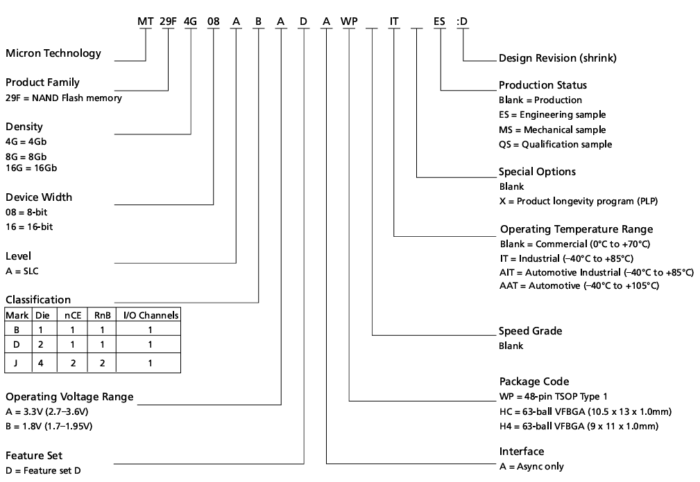

Hello, please add this IC.
NQ437 FBGA63
MT29F4G08ABADAH4-ITX:D
2025-8-19 21:26

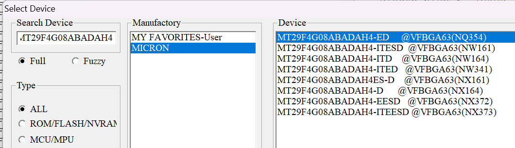

NQ437 FBGA63
biyache 发表于 2025-8-19 21:31
        Until they add the line for your IC, based in the Datasheet info, page 2,
there are already some identical ICs in the list, only planed use, or case maybe
different. Do not know if ID is the same, but if not, you can remove 'CHECK ID'
2025-8-21 12:47
For T76-T56...
2025-8-21 12:52
Hope it helps, or not :(

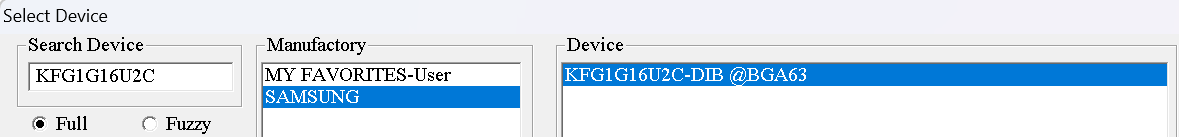

KFG1G16U2C-AIB6 BGA63
TC58RYG0S8EBAIA BGA63

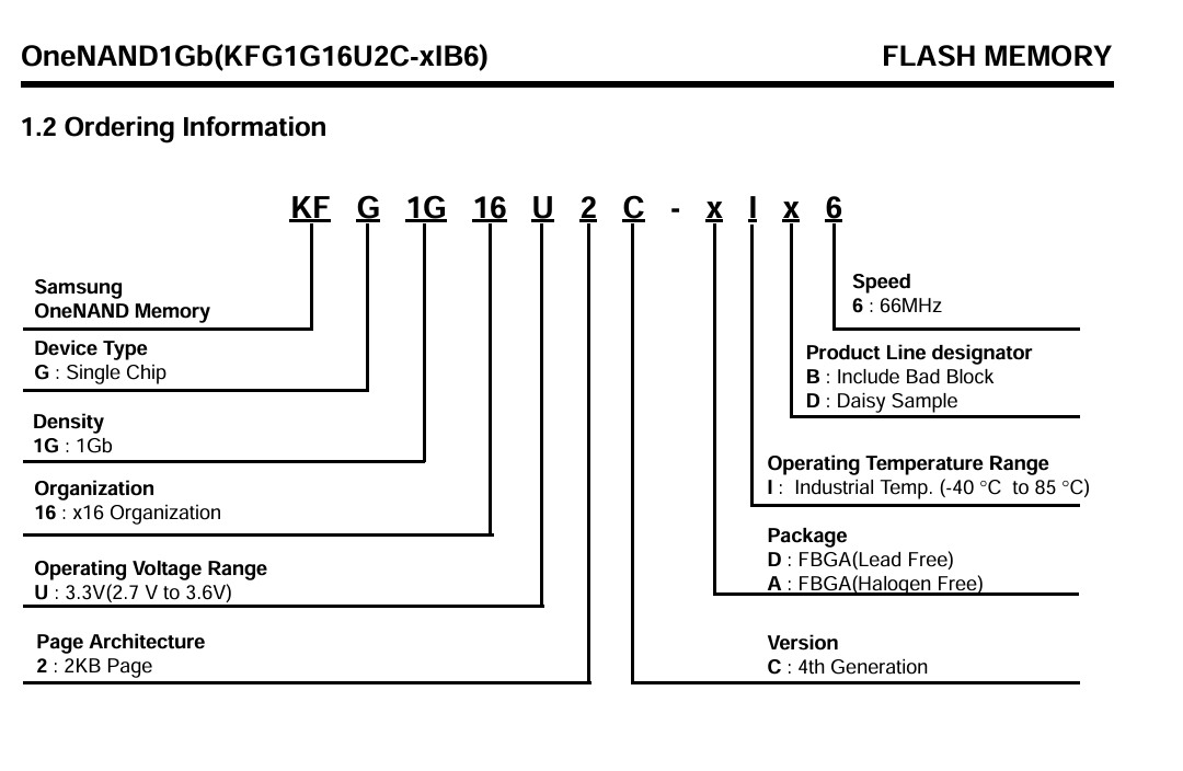

biyache 发表于 2025-9-7 00:52
        Until they add the lines for your requested ICs, for KFG1G16U2C-AIB6 BGA63, based in the Datasheet info, page 4, there are already one identical IC in the list, only planed use,
or case maybe different. Do not know if ID is the same, but if not, you can remove 'CHECK ID'.
Always remember to read Datasheet, as some ICs, like this one, have OTP areas that you cannot rewrite,
write only in a completely new, not programmed IC. Software also show some info about.
2025-9-7 10:34
For T76,
2025-9-7 10:37
Hope it helps a bit, or not :(

V13.03A for T76- Software and IC support  List are here xgecu.
(Newer 'A' setup file seen for download, maybe corrected any install error)
1. The number of supported chips has been increased to 39,009, with over 250 chips added. This primarily includes support for Micron's MT35XUxxx and MT35XLxxx series Octal chips.
Read speeds reach 60+ MB/s.
2. Automatic serial number increment for T76 has been implemented.
3. Support for multi-machine programming has been implemented (up to four programmers can be connected to one computer simultaneously).
4. The software interface now automatically adapts to high-DPI monitors.
5. Multiple software optimizations have been made to ensure greater stability.
Firmware updated to version 1.13 from 1.11
