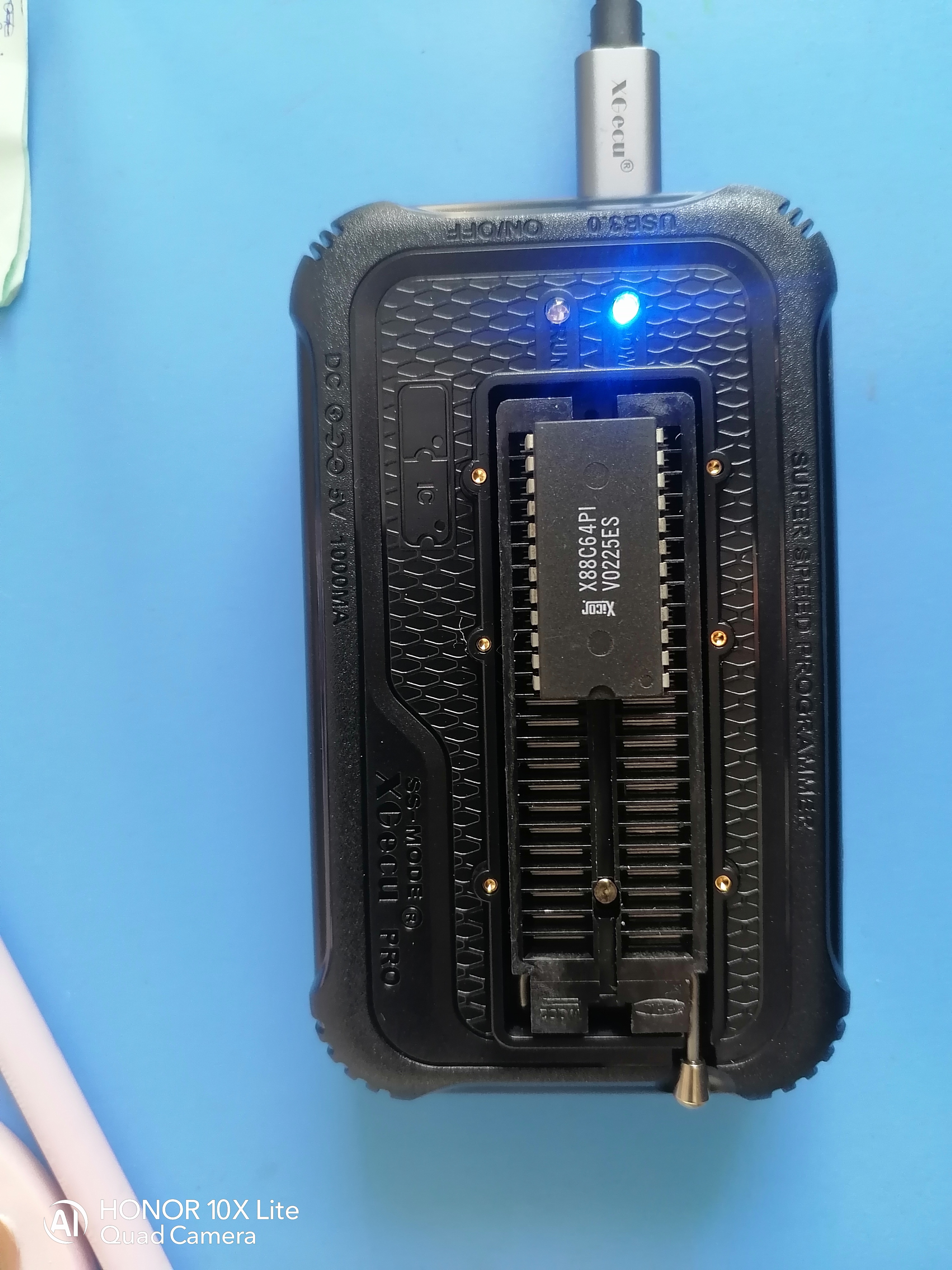

Hello. I bought a T76 progromator, it's very good. Please add the x88c64pi chip to the support list. I wanted to destroy the microcircuit, the programmer is asking for software updates. I will be very grateful to you. I've tried programming a few microcircuits.

   Hello,           All of us  waiting for development. Until new version , with new support was out,
maybe with new firmware version, we must wait. So far, you can see what's in the works, and
what's missing from plan, with BLUE printing from page Haikou Xingong Electronic Co,Ltd
Adding new ICs also important, but many old ICs need support to be completed before,
hopefully, works like the one you need.

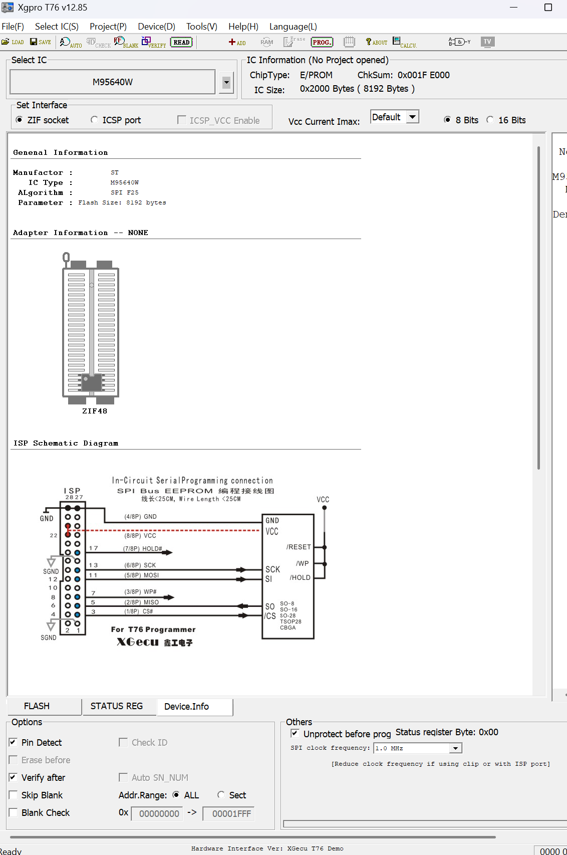

        Hopefully soon. If You aren't familiar with old program versions of Xgecu, programmers, T48, T56 and TL866II, for operational work the application is almost
the same, the same functions at the same place, then you can use actual provisory manual
that install in the root of program folder, or download it at
http://www.xgecu.com/MiniPro/T56_TL866II%20USER%20GUIDE.pdf

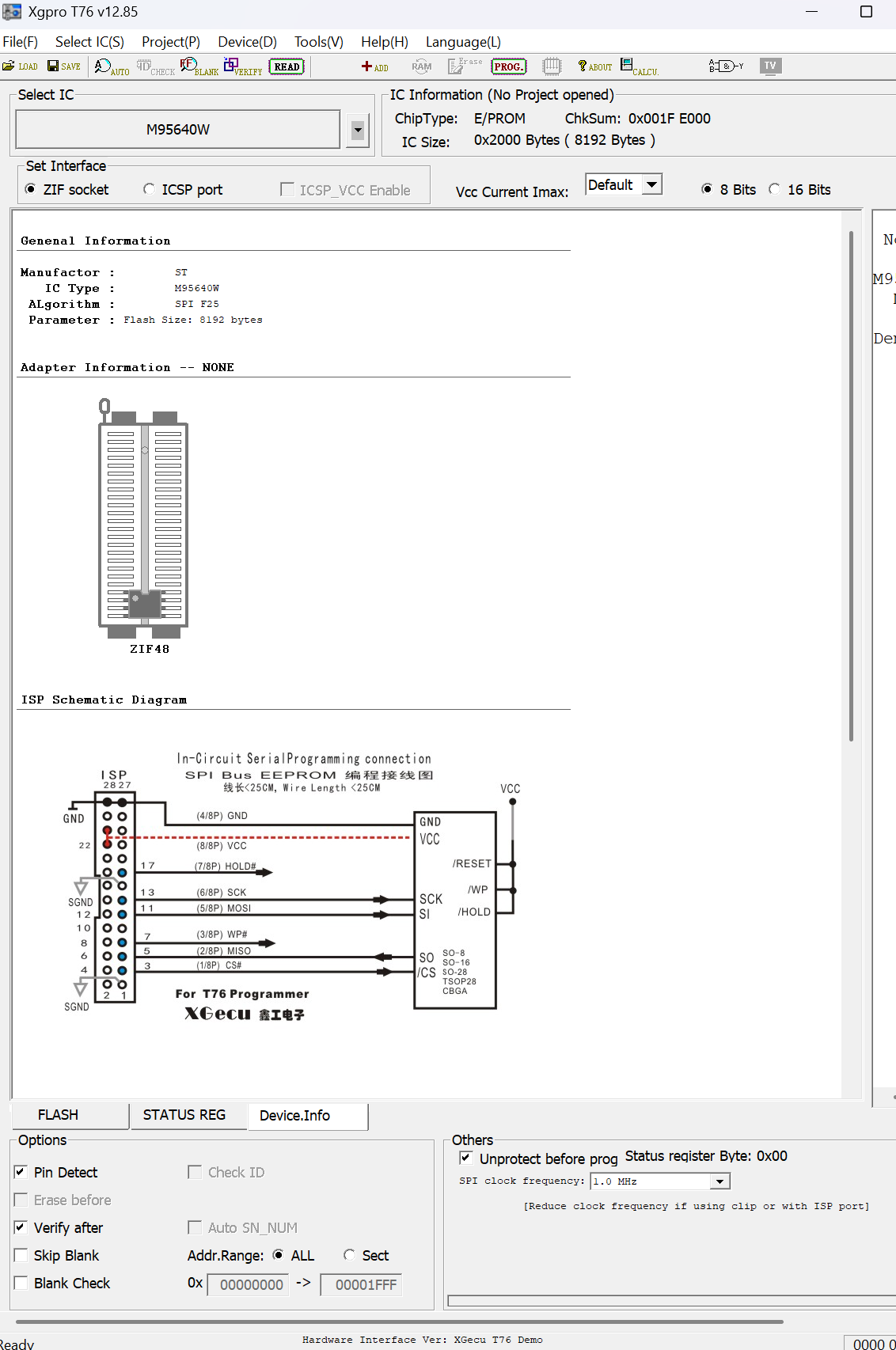

.If you need to setup any external connection, select the IC, then near the bottom, select Device.Info tab, it
will display some information how to connect. You can also display, bigger images of those images, if you
browse the IMG folder, inside the application folder . There, you can also see previous programmer images,
as they also be used in some occasions.
2025-3-18 14:15
Hope it helps till then.

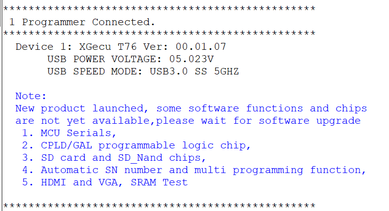

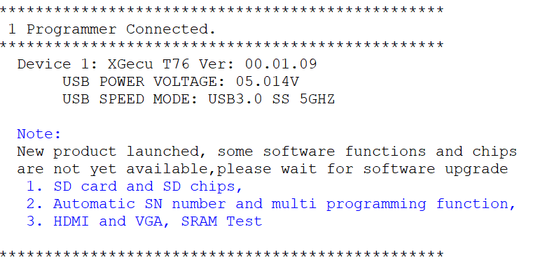

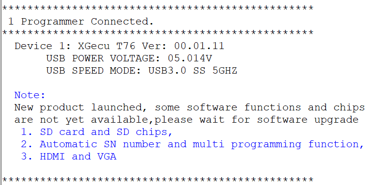

   Hello,            The T76 also, if you have the programmer connected to it, show some ongoing information
about features that still are in development fase, a bit of time outside initial schedule, but still already
above numbers of T48, but not support all ICs yet.
2025-3-28 19:09

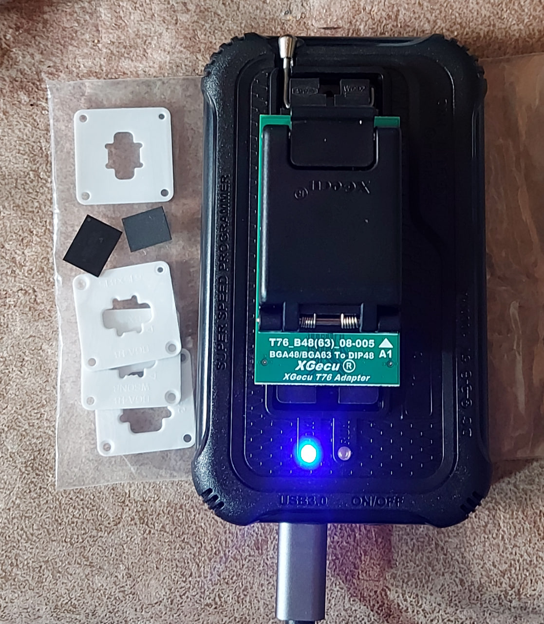

The T76 native adapters, are showing up, first BGA64 from 3 to 1, compared to T48, BGA48-63 now
also, so far, with only one adapter only, Big saving for some of us, BGA 153-169 and BGA221, hopefully,
like the T48, expected to sell in groups of at least four, with BGA 100 and BGA162. Anyway, a wish like
with the 'Medusa ProII' programmer, some new Chip formats with only one adapter, to save money, at least to
some of us.
Waiting....

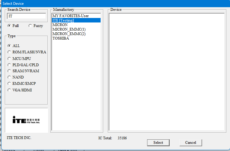

Why support for all ITE chip had been removed in the v12.85 version?
Chip list is empty
Test 发表于 2025-4-3 07:41
   Hello,            Just guessing, but, as you know, T76 and T76 Software, are at the moment,
a working in progress project. The same was appended for SRAM chips, maybe also
other ICs, the support wasn't complete yet and errors still need to be corrected, as
well firmware need to be updated, in the ICs support list they write, ITE -> TESTING..
Xgecu gave 2-3 month preview time to complete all, but like all previews, are just previews,
and the project will take a little longer, hopefully...

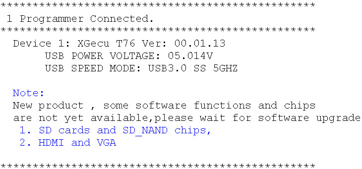

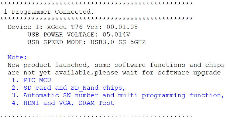

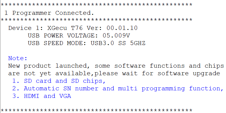

   Hello,            Today Xgecu software was updated for all latest devices. T76 (12.89)  setup grow up near 3MB in size.
ITExxxx reference disapear from list, firmware updated to 1.08, and welcome message is new, now say in 4 steps, previous 5...
2025-4-10 12:25
User manual still is at T56 level, but not much difference needed so far :-).
IC Support progress a lot, but not yet on target for T76:
T48-35267 from 35138
T56-38062 from 37906
T76-36111 from 35186

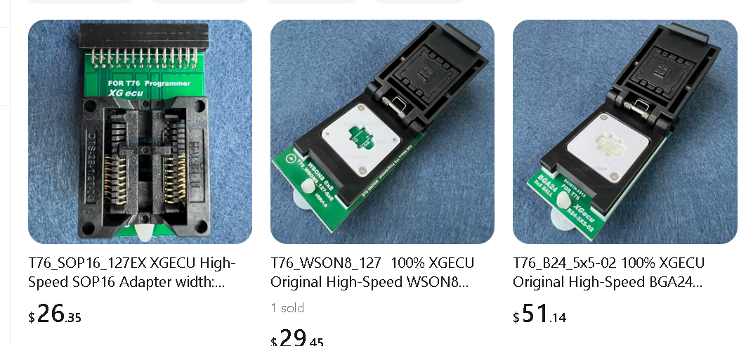

Adapters for BGA48/63, 64 , 153/169 already exist, BGA221 already seen in Aliexpress,
not now, but still show on Myshopify Adapters for XGecu T76 Programmer   Soon expected
other like the one already shown in the program like BGA24 for PN27x ICs, appears not be the same
as previous BGA24 (5x5 and 6x4, maybe a new for all BGA24), BGA100 and 162, the emmc
SD adapter, like in T48 (as they will add support all T48 ICs), the VGA/HDMI
adapter (When support available complete development).

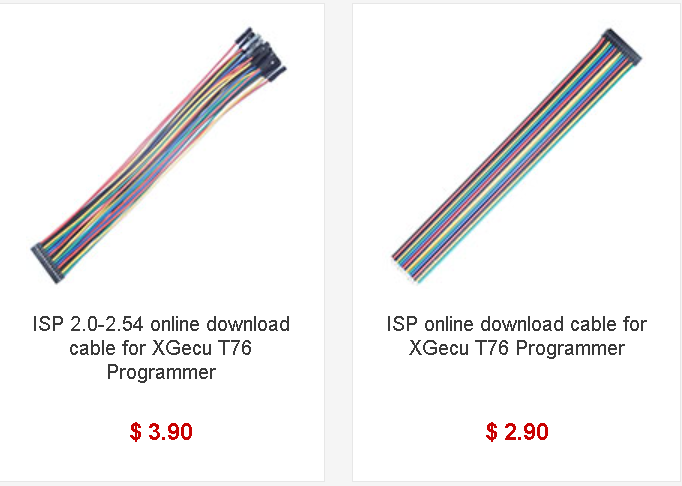

A wish is, they offer to sell already build cables, the one that connects the adapter to
the ISP Connector, to use the massive investment done on T56 adapters, even at lower speeds,
at least till all adapters are available and have fair price, or maybe to use much better, like
the T56 ssop56 with Zif socket, great product, as the new available for T76 need to solder the IC,
not very practical.
It's improving... Please, give your feedback if you know something more.
