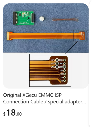

          Two new  ISP cable adapters for T76, seen for sale at LRF. For those who may need them, link t76

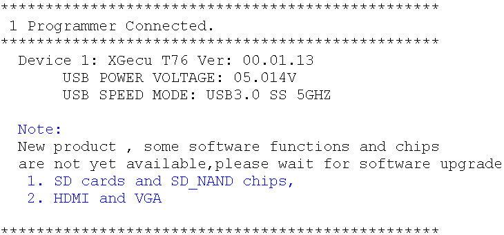

V13.03A for T76- Software and IC support  List are here xgecu.
(Newer 'A' setup file seen for download, maybe corrected any install error)
1. The number of supported chips has been increased to 39,009, with over 250 chips added. This primarily includes support for Micron's MT35XUxxx and MT35XLxxx series Octal chips.
Read speeds reach 60+ MB/s.
2. Automatic serial number increment for T76 has been implemented.
3. Support for multi-machine programming has been implemented (up to four programmers can be connected to one computer simultaneously).
4. The software interface now automatically adapts to high-DPI monitors.
5. Multiple software optimizations have been made to ensure greater stability.
Firmware updated to version 1.13 from 1.11

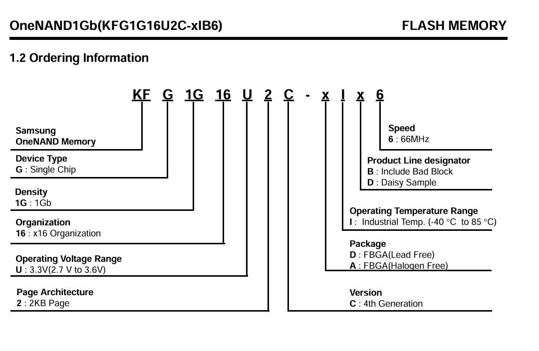

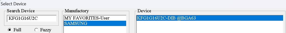

Hello, please add this IC.
KFG1G16U2C-AIB6 BGA63
TC58RYG0S8EBAIA BGA63
biyache 发表于 2025-9-7 00:52

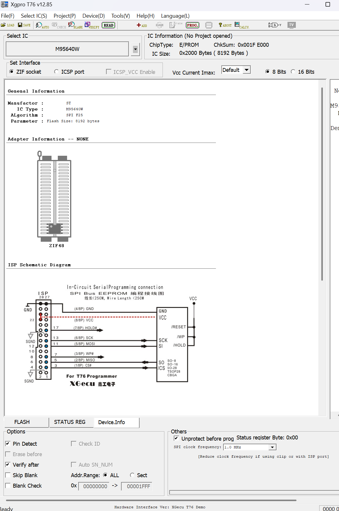

        Until they add the lines for your requested ICs, for KFG1G16U2C-AIB6 BGA63, based in the Datasheet info, page 4, there are already one identical IC in the list, only planed use,
or case maybe different. Do not know if ID is the same, but if not, you can remove 'CHECK ID'.
Always remember to read Datasheet, as some ICs, like this one, have OTP areas that you cannot rewrite,
write only in a completely new, not programmed IC. Software also show some info about.
2025-9-7 10:34
For T76,
2025-9-7 10:37
Hope it helps a bit, or not :(

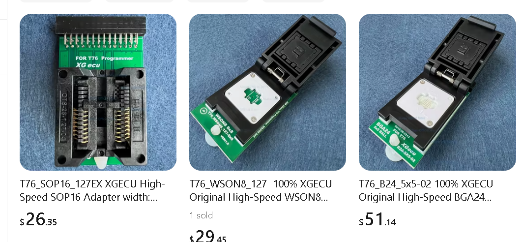

   Hello,             Three new HIGH SPEED adapters for T76 seen for sell.
T76_B24_5x5-02   ,
T76_WSON8_127  , and, T76_SOP16_127EX
on Xgecu store at AlIexpress  XGECU XGecu Official Store - Amazing products with exclusive discounts on AliExpress,or also at myshopify  Adapters for XGecu T76 Programmer
2025-9-6 10:24
Based in the latest Xgecu T76 Software, other 3 adapters can also appear soon
T76_B24_4X6-03
T76_B24_10-4x6
and also
QFP64-08-01
Still have doubt, if a 'full pin' BGA24 will be available in the future, as T76 tend to conciliate
adapters, to a one only for every package, with this have at least 3 different, or if one of them will
be the '0ne for All'. Let's wait a bit more to know.
More news as soon as possible.

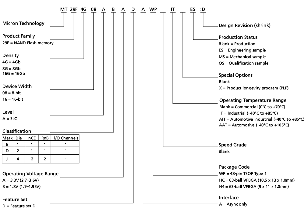

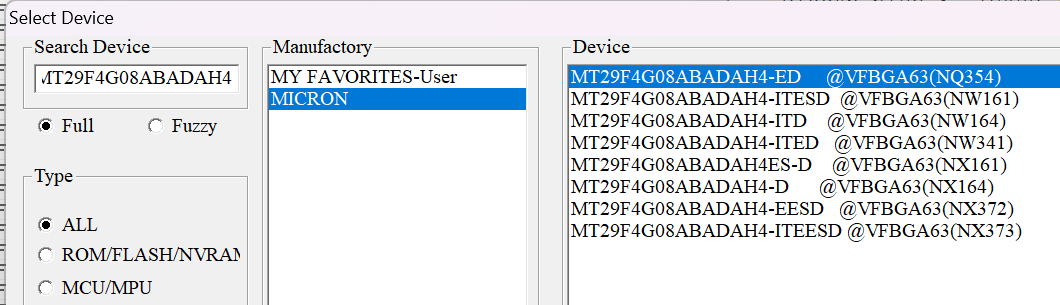

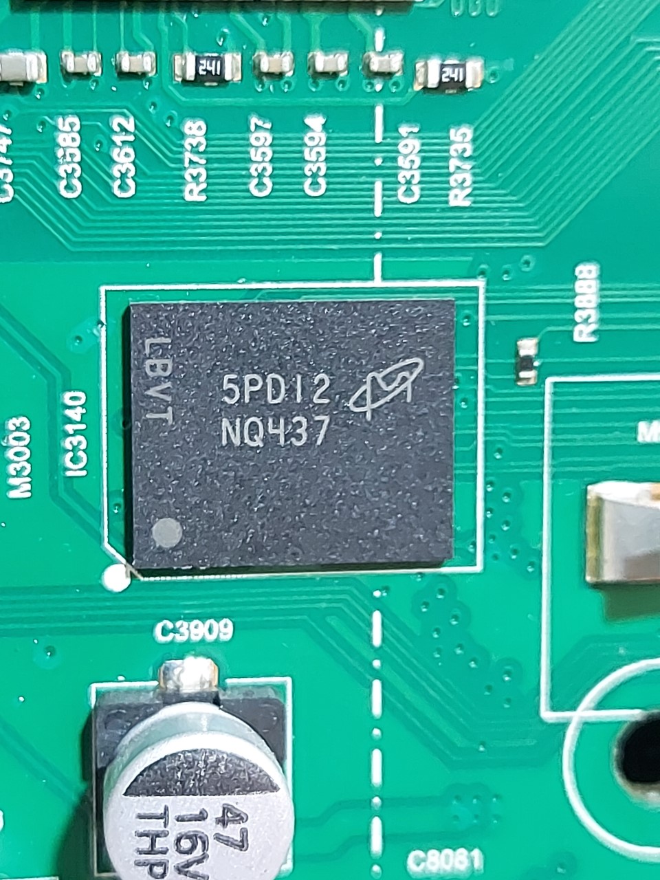

NQ437 FBGA63
MT29F4G08ABADAH4-ITX
biyache 发表于 2025-8-19 21:31
        Until they add the line for your IC, based in the Datasheet info, page 2,
there are already some identical ICs in the list, only planed use, or case maybe
2025-8-21 12:47
For T76-T56...
2025-8-21 12:52
Hope it helps, or not :(

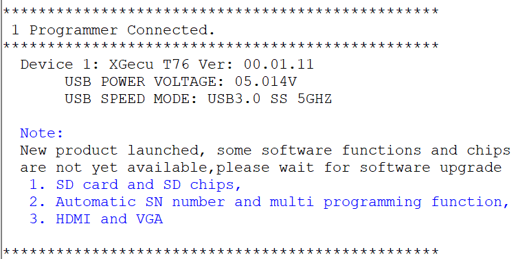

Good News, new T76 only software version is out. 12.95
1. Added SRAM test function complet ...
Albano.Matos 发表于 2025-7-15 12:17
V12.97 for T76- Lists  and software will be here shortly xgecu.
Now at http://www.xgecu.com/MiniPro/xgpro_T76_V1297.rar , and the list at
http://www.xgecu.com/MiniPro/T76_List.txtFirmware now at 00.01.11 level
1. Added support for over 100 chips
2. Fixed a major bug in the previous version
3. Fixed some other known bugs
2025-8-19 21:04

Hello,            No news for almost last two months  . It still miss SD_ADP support fro ...
6. Fixed some known BUGs
It seems that page Haikou Xingong Electronic Co,Ltd Blue prints, are already outdated.

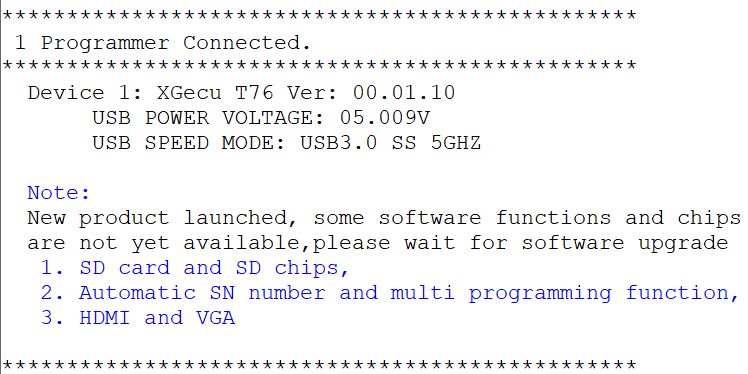

Hopefully, get it done, message in app is now:
2025-7-15 12:20
T48-56-TL866II-12.90
T76-12.95 (firmware from 1.09->1.10)

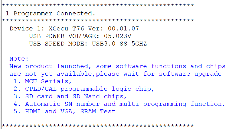

Hello ,
T76: 12.91  new Firmware 1.09.
12 ...
Albano.Matos 发表于 2025-5-8 21:36
12.93
2025-5-14 20:18
More news as soon as they are available, now very fast :-)

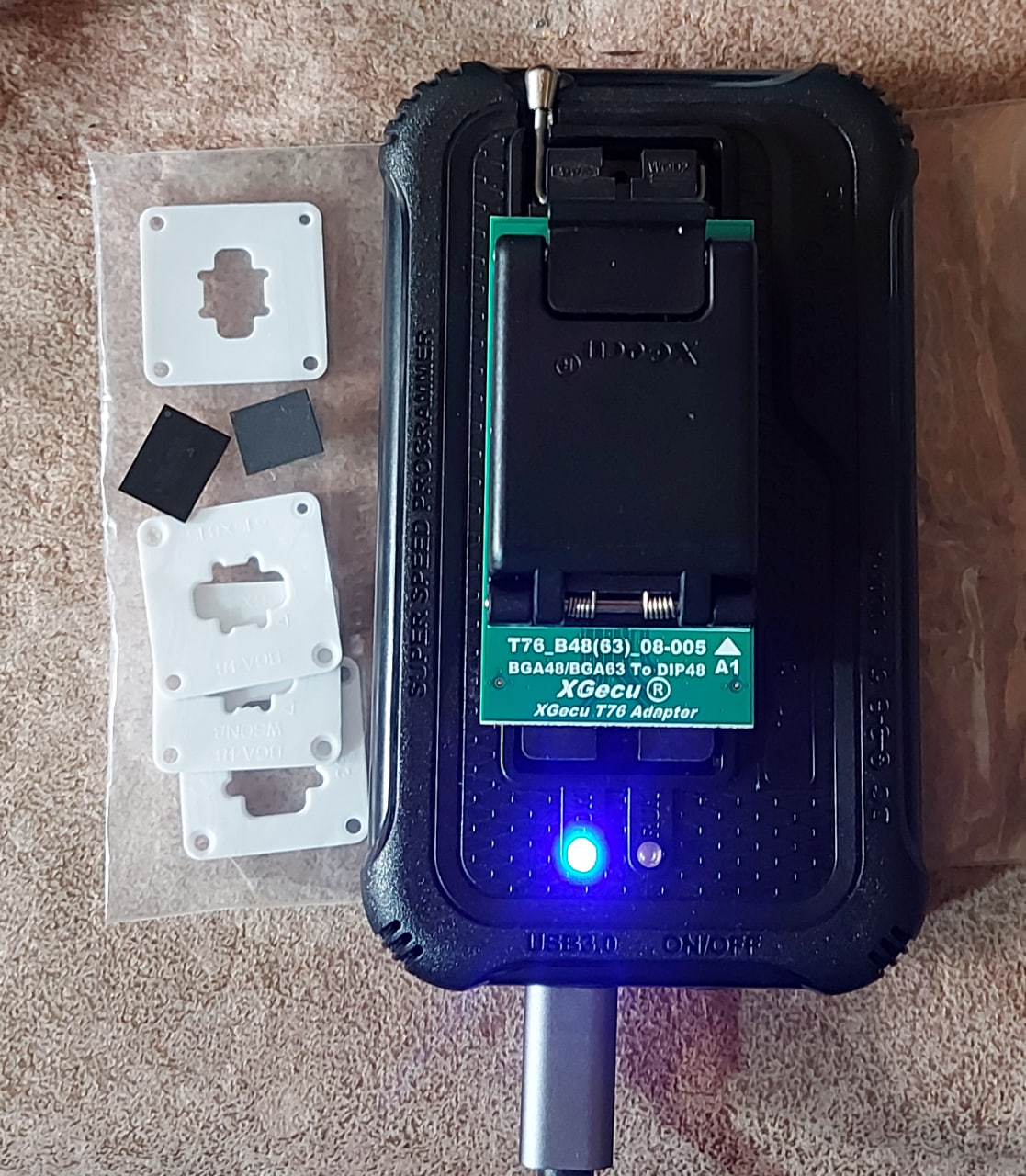

Also have noticed that BGA48-BGA63 Adapters, will also work in T48, T56 and T76 with BGA67 format, 0.8mm pitch ( as others also exist)

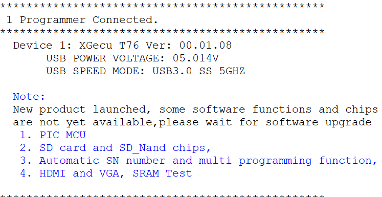

ITExxxx reference disapear from list, firmware updated to 1.08, and welcome message is new, now say in 4 steps, previous 5...
2025-4-10 12:25
User manual still is at T56 level, but not much difference needed so far :-).

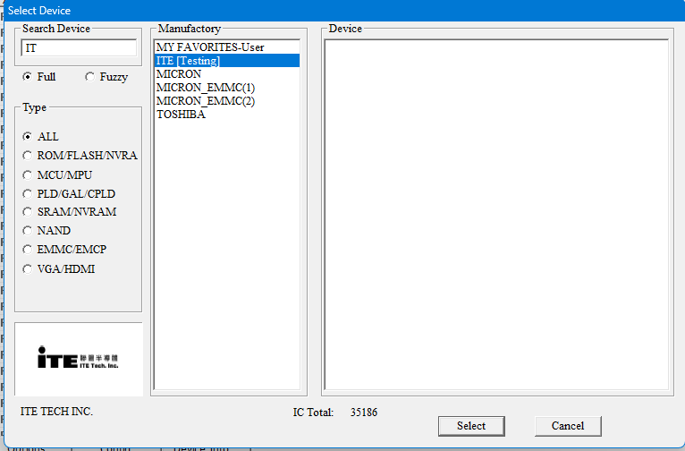

Why support for all ITE chip had been removed in the v12.85 version?
Test 发表于 2025-4-3 07:41
   Hello,            Just guessing, but, as you know, T76 and T76 Software, are at the moment,
a working in progress project. The same was appended for SRAM chips, maybe also
other ICs, the support wasn't complete yet and errors still need to be corrected, as
well firmware need to be updated, in the ICs support list they write, ITE -> TESTING..
Xgecu gave 2-3 month preview time to complete all, but like all previews, are just previews,
and the project will take a little longer, hopefully...
For more professional computer repair works, people complement with the use other programmers
like SVOD4, or even more expensive ones, with dedicated and specialized hardware, but hopefully, T76 will do some
of that work in the future. Simply...to do it all, time is needed for development, and sell many to cover costs, till
then we must wait, future path isn't free :'(

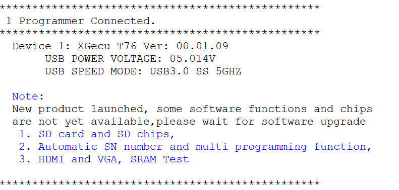

   Hello,            The T76 also, if you have the programmer connected to it, show some ongoing information
about features that still are in development fase, a bit of time outside initial schedule, but still already
above numbers of T48, but not support all ICs yet.
2025-3-28 19:09

           Software 12.85 , only for T76, is out for use. Ive noticed they removed SRAM chips in the previous list,
as support still in 'BLUE PRINTING', they also published the List of Supported ICs and 88C64 is there. Only testing
to see if it works now for you. Firmware was updated to 1.07, number of ICs in the list is now a bit above T48 in
number, but some features of T48 not available in the T56, still in the works, then the list will have to grow a lot
in the future....just wait, they are working, it seems, to get job done a.s.a.p.

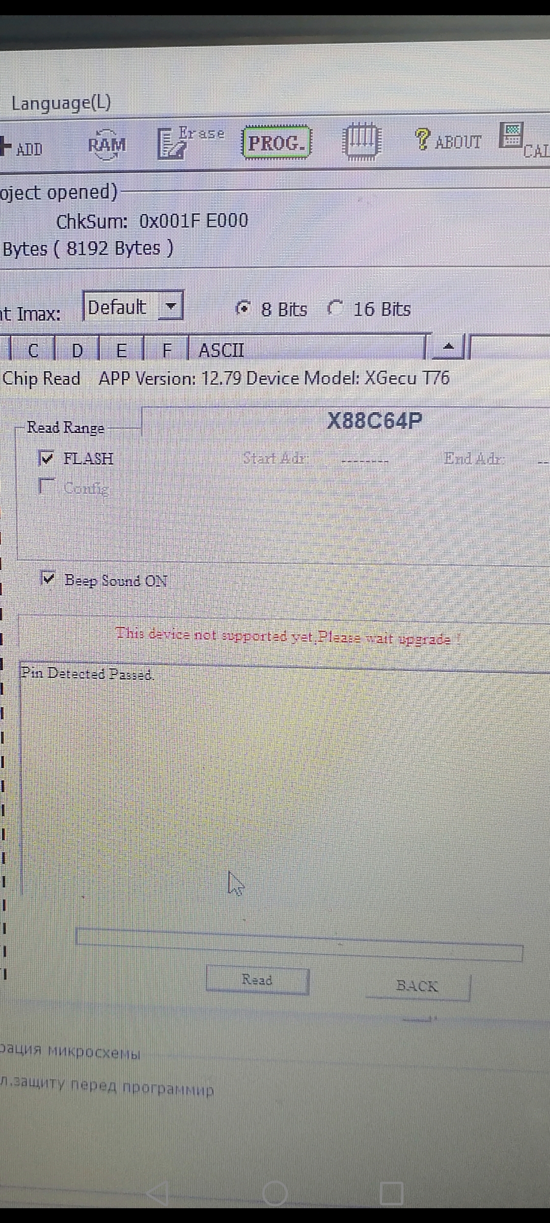

quote]Hello. I bought a T76 progromator, it's very good. Please add the x88c64pi chip to the support list. ...
Evgeny 发表于 2025-3-5 13:28 [/quote]
   Hello,           All of us  waiting for development. Until new version , with new support was out,
maybe with new firmware version, we must wait. So far, you can see what's in the works, and
what's missing from plan, with BLUE printing from page Haikou Xingong Electronic Co,Ltd
Adding new ICs also important, but many old ICs need support to be completed before,
hopefully, works like the one you need.

Hello. I bought a T76 progromator, it's very good. Please add the x88c64pi chip to the support list. I wanted to destroy the microcircuit, the programmer is asking for software updates. I will be very grateful to you. I've tried programming a few microcircuits.

Hello,            T76 software, official 'early version' version 12.75, can already be down ...
Albano.Matos 发表于 2025-1-4 21:46
   New T76 -12.77 software version is out....still improving before i receive unit.
New features are added by flashing firmware, now at version 1.05. They are working fast
as promised by 'Blue text' in the adds. Pdf manual still in the works, but T56 manual still
have most features use described. Latest chips with 512GB , like GD25LR512xxx,
still missing, hopefully they will be available soon. Unfortunately, some AVs continue to
give false positives, and complain about available software. I've not tried to update Xgecu
app, direct from app. I'll try next time but with programmer disconnected, to see if it works
without popups. It works fast :)
