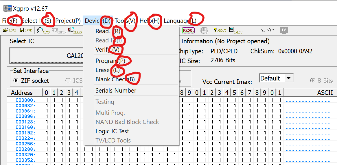

Xgpro remove letters inside parentheses from menu?
I'm using Xgpro together with my Xgecu T48 and it works fine.
There's one thing that I find is so anoying, that's the letters that are inside parentheses in the menu. In the screenshot I have marked it with red.
Is there anyway to remove them from the menu?

   Hello,            Those are there, to remember you and us, the shortcut Ctrl+(key).
Some time, for beguinners at least,  they are annoying because, they repeat with different
functions....
If you do not use any, was nice to toggle them on/off easelly, i agree.
If you want, you can try editing the file languageXX.ini you choose, in the root directory
of Xgecu app ( save it first always), then save it again after change with other name to recover
from overwrite, acidental or app upgrade. That's the only way i found. If the ease exist, please let me know.
