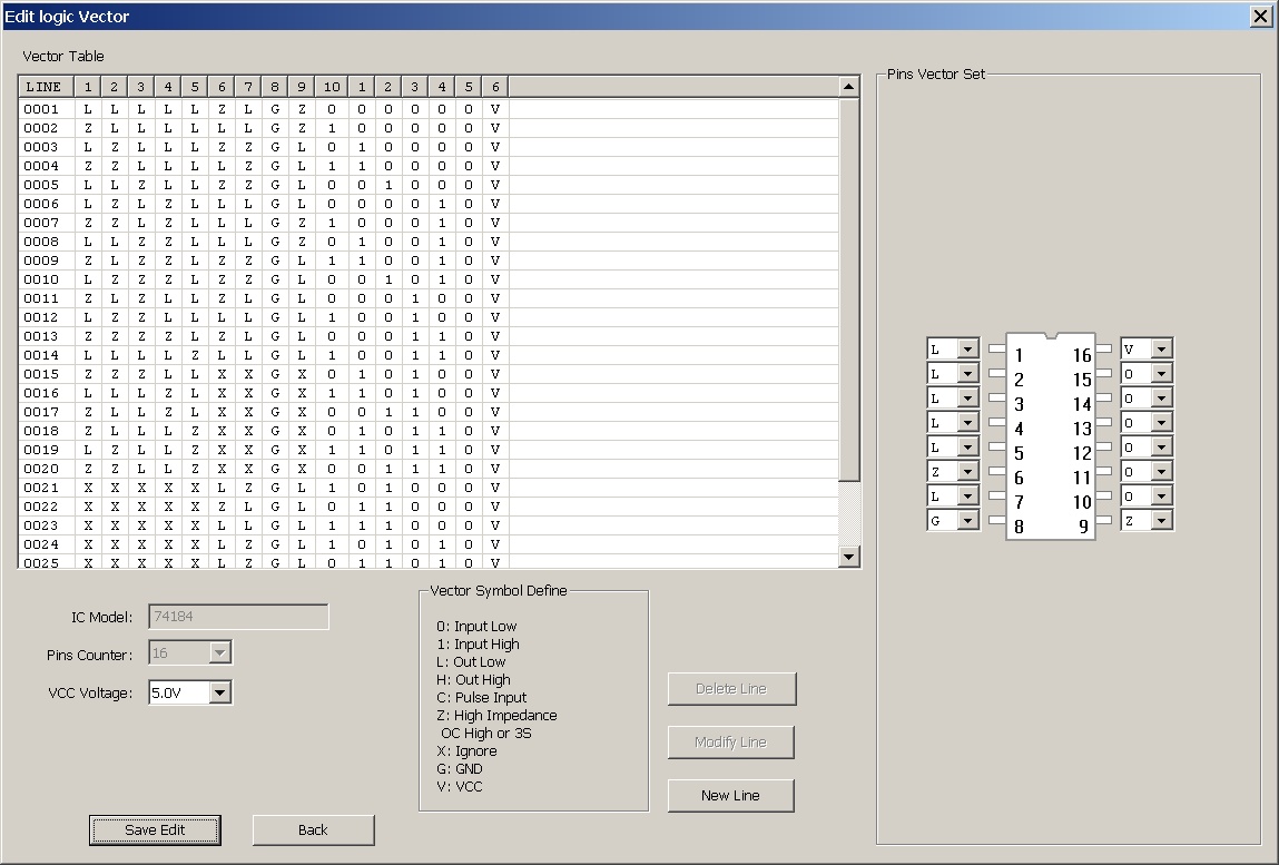

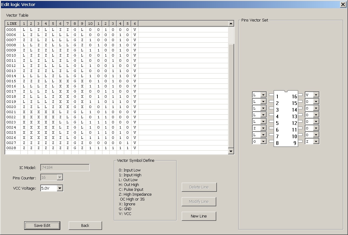

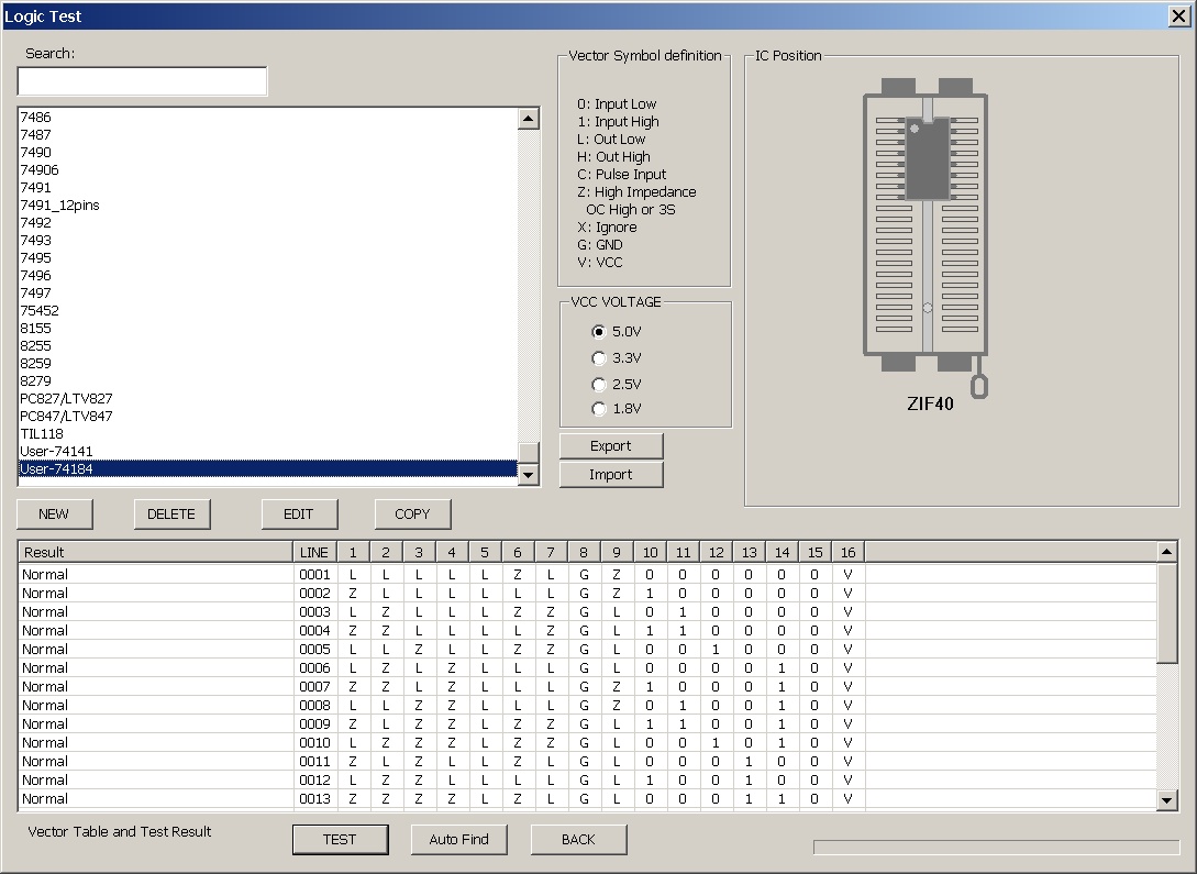

The test was performed on the SN74184 (BCD TO BINARY AND BINARY TO BCD CONVERTERS) chip from Texas Instruments.
